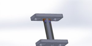

Next I had a mate help me make a new spacer for the rear wheel drive side. The washers I had in there were very slightly fouling on the freewheel so not spinning freely. It now spins much more freely and has a better chain line.
