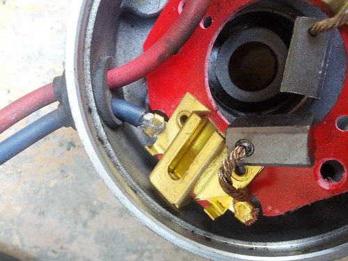

High voltage on the frame is destroying my Aprilia electronics. Anyone else having this issue? I'm suspecting others have the same underlying problem but haven't noticed because they haven't added extra electronics.
A simplified wiring diagram on my modified Aprilia is: ApriliaWiring2.png
This means that when the motor is off battery +ve is connected to the frame through the motor. I only figured this out after wrecking a few things. One was a Speedict where a signal wire must have touched the frame during fiddling, but at the time I couldn't figure out how it had been exposed to battery voltage. See http://endless-sphere.com/forums/viewtopic.php?f=3&t=22919&p=720474&hilit=engineers#p720474 . Another was an ANT+ power sensor I built where the resistors lit up like light bulb filaments when the USB cable I was updating the firmware with touched the frame. Even now that I'm careful I still wrecked the charging circuit on a phone when a metal part of the phone touched the frame while it was charging off the bike battery through a DC/DC converter. It would also mean that if the insulation on the wire to the battery negative ever gets cut and the wire comes into contact with the frame, the motor will be unstoppable.
This could be fixed by breaking the connection from the motor negative to the frame or having a controller which switched on the positive side of the motor rather than the negative. A colleague tells me controller manufacturers switch on the negative because the MOSFETs to switch on the positive are more expensive so I probably can't find a controller alternative. I suspect the construction of the motor will make it too hard to break the motor frame connection but maybe my motor is faulty and other motors don't have that connection.
To check this, does everyone else with a non Aprilia controller read full battery voltage when connecting a voltmeter between the frame and battery negative, with the battery connected and the motor off?

No. Referring to the circuit diagram above, the only path to battery -ve is through the controller. If I was to connect a wire from the frame to battery negative then there would be a path and the motor would operate at full power.
Gday Ken,
just popped an ohm meter over a motor in my shed.
No connection between either wire and the chassis.
About 1.8 Ohms nominal between the pos and neg leads, but zilch between either lead and the motor's chassis. I was careful to make sure I was using several bright surfaces on the chassis of the motor, not painted sections. Motor was open so easy to do.

Thanks for that. Looks like I'll have to disassemble the motor and look for the fault.
I disassembled the motor and found the fault. The brush housing is riveted to the insulator as shown.
But the rivet touches the motor housing
which connects motor negative to the bike frame. This is easily repaired with a bit of insulation tape stuck on the motor housing. However, this seems to be a design fault. From new it must have been touching or almost touching and assuming my bike is the same as all the others there must be many where the frame is connected to the negative side of the motor. Samd's motor is one that doesn't.
Now getting speculative. If the Aprilia controller switches on the negative as does the the LBD14 (and it probably does but I don't have one to check) then this is perhaps the reason the electronics fails on so many Aprilia's. Battery voltage is connected to the frame when the motor is off which is no problem, until a wire connected to an electronic component that cannot endure battery voltage touches the frame.
