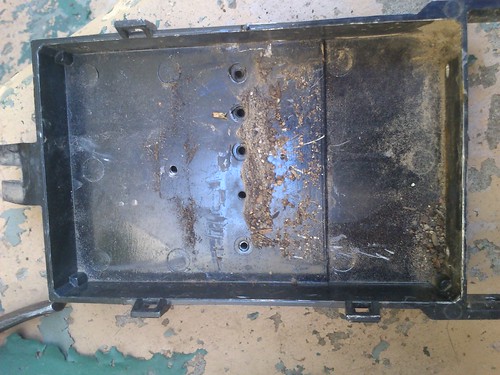

It is often small errors that lead to failure. Don't install the controller with the wires exiting upwards!
The controller housing sits at an angle to the frame so securing the controller to the bottom of the housing maximises the space for neat cable connections at the top. Water jets off the front wheel which can be seen from the amount of dirt that has got through the unused screw holes in the housing.
Some of the spray, goes over the housing top, runs down the wires and through an imperfect seal. That means loss of assist in the rain and over time, a corroded controller.
It is unpleasant when its pissing down 20km from home and you just want to be warm and dry as soon as possible but becomes annoying when that 20km has to be traversed on the heavy Aprilia without assist.
By the time I'd dried out and warmed up the bike was always fine, which made fault finding difficult. I suspected the throttle as it was always full of water and I thought the housing was keeping spray off the controller. However, after the last occasion, I found the Aprilia lying next to an overturned flower pot some distance from where it had been parked with the motor running and unstoppable.
I faced the wires down and made an effort to seal the blank cover of the replacement controller with silicon. Wiring pushes against the motor this way and it is not as neat, but hopefully it's waterproof.
