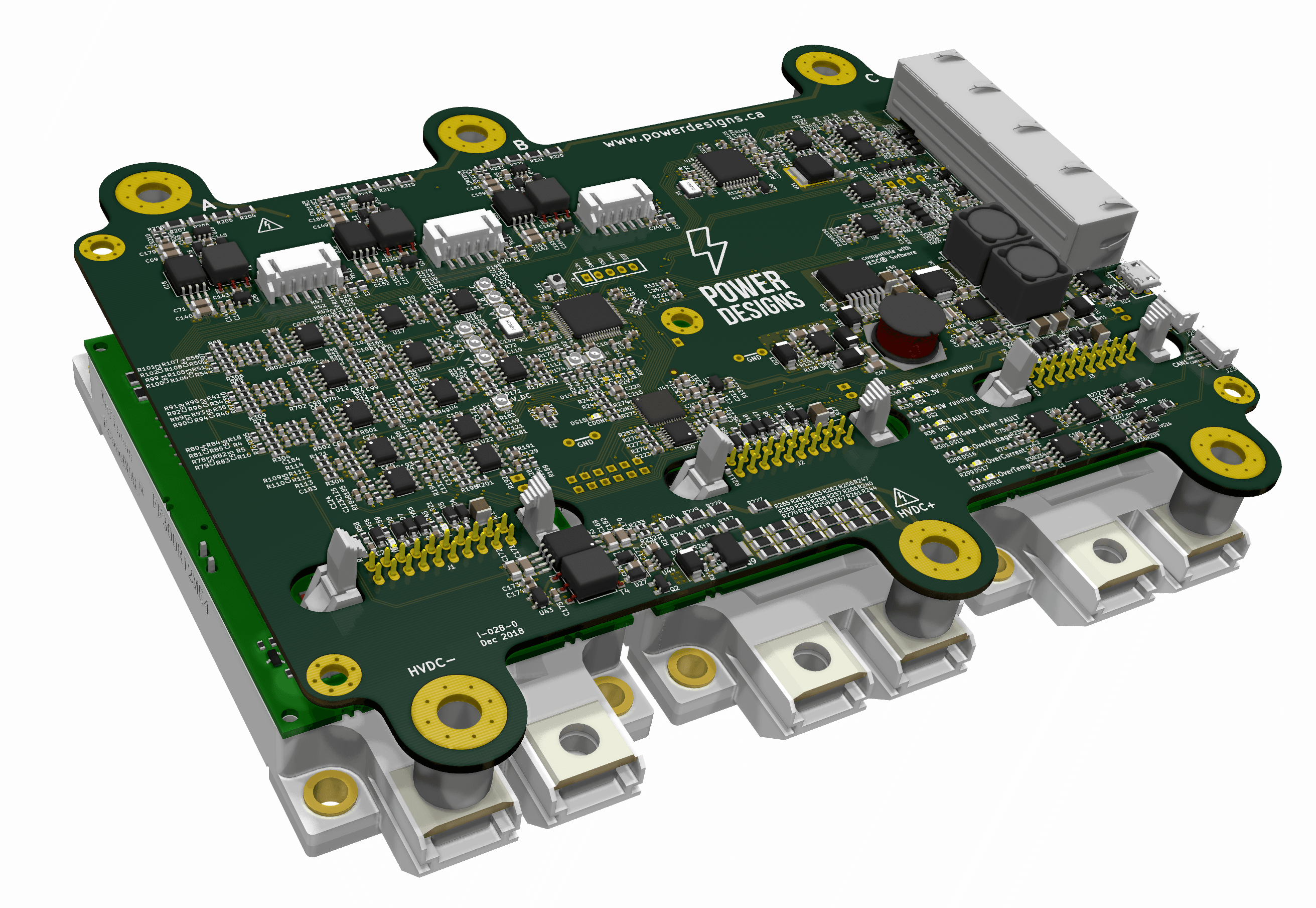

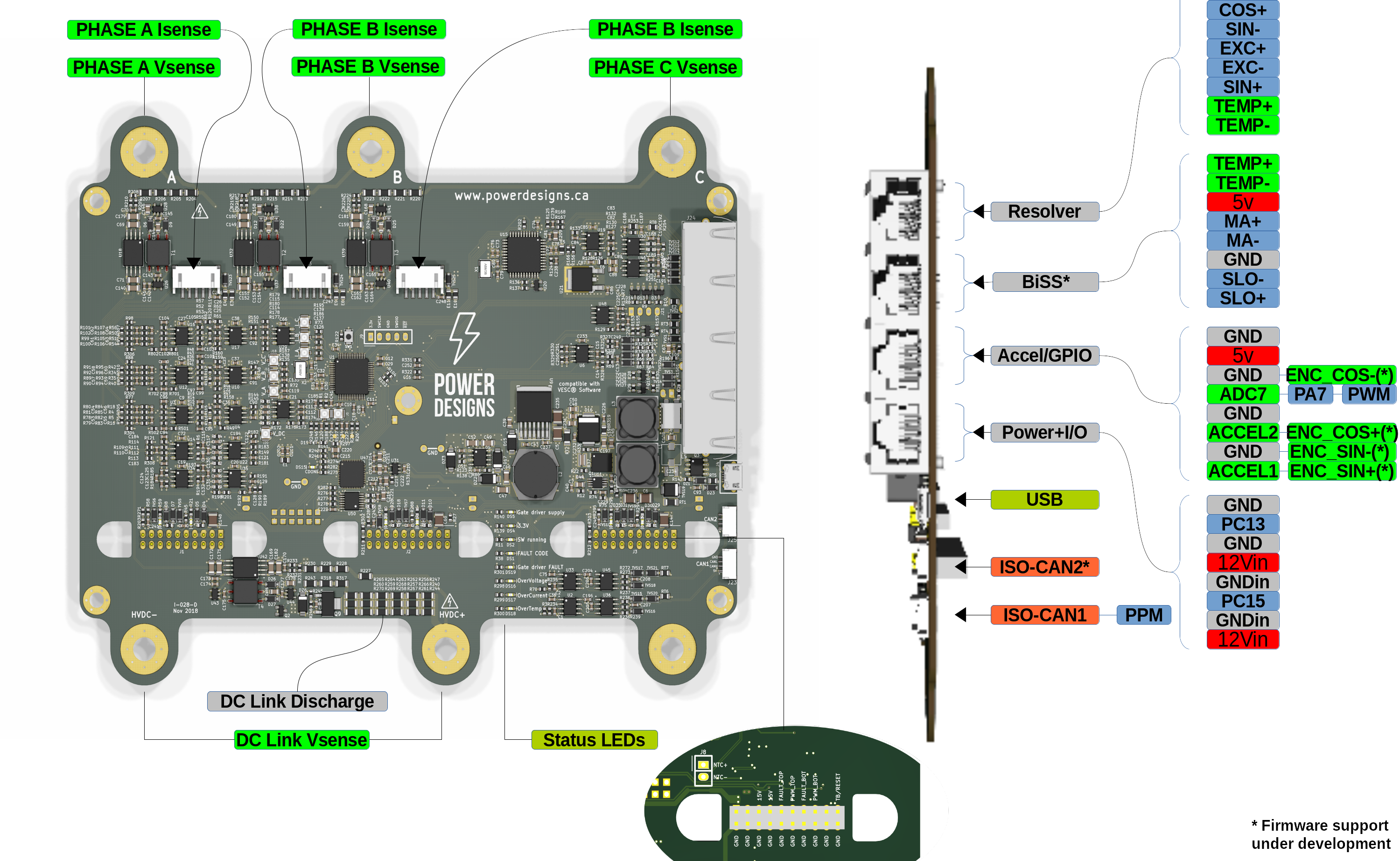

So, now to the hardware. Its black!
it also comes with in an interesting changelog

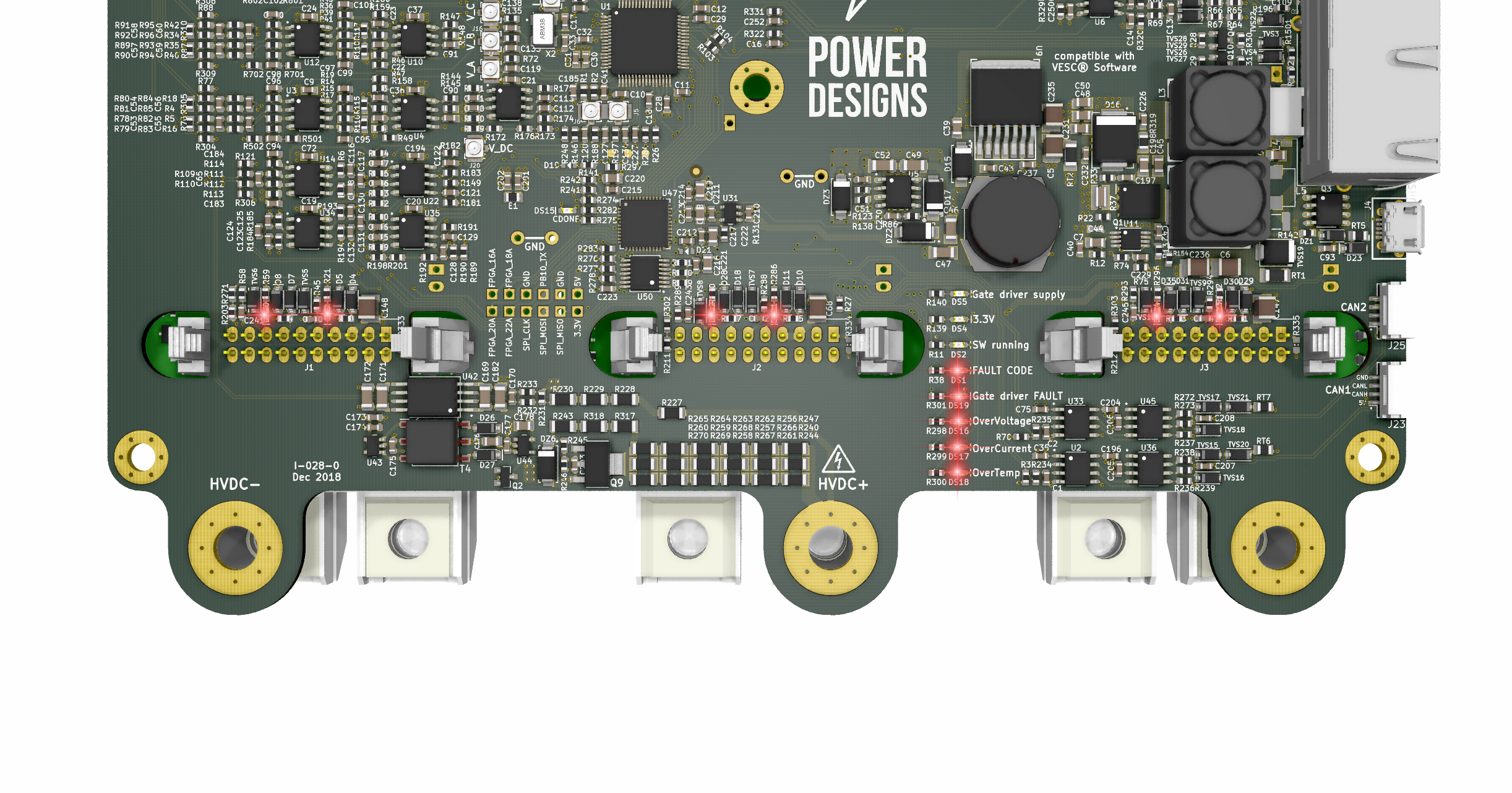

[*] Mechanically matched to EconoDual/17mm IGBT modules. No adaptor PCB needed.
Isolated HVDC and phase voltage monitoring integrated on board.
[*] DC Link Capacitor discharge resistor on board. Discharges it when board is not powered.
[*] RF connectors to measure analog signals. This provides simulation-like signal quality, extremely cool for development.
[*] Individual IGBT fault monitoring. You can tell which IGBT faulted.
[*] Individual fault leds for overvoltage, overcurrent and overtemperature.
[*] Individual IGBT temperature monitoring.
[*] An FPGA is continuously monitoring all fault inputs. If any fault is asserted, all PWM activity is shut down.
[*] FPGA supervises the PWM generated by the MCU. Shuts down PWM if a shoot-through command is detected.
[*] RJ45 ports. These are not ethernet, they provide a shielded, twisted pair wiring in a standard off the shelf fashion.
[*] Dual analog Accelerator inputs.
[*] Dual isolated CANbus interfaces (firmware no there yet for the 2nd interface).
[*] Resolver support.
[*] BiSS absolute encoder support (firmware under dev).
[*] Sin/Cos encoder support.
[*] Supplies a regulated 15Vdc to the gate drivers, and monitors that voltage.
[*] 2 DAC outputs with RF connectors to peek inside the firmware.
[*] 2 Open drain outputs for driving small loads or relays, for a pump for example.
[*] More fuses, more TVS, more EMI filtering.

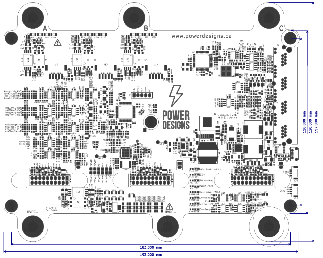

Here are some high-res images for reference:

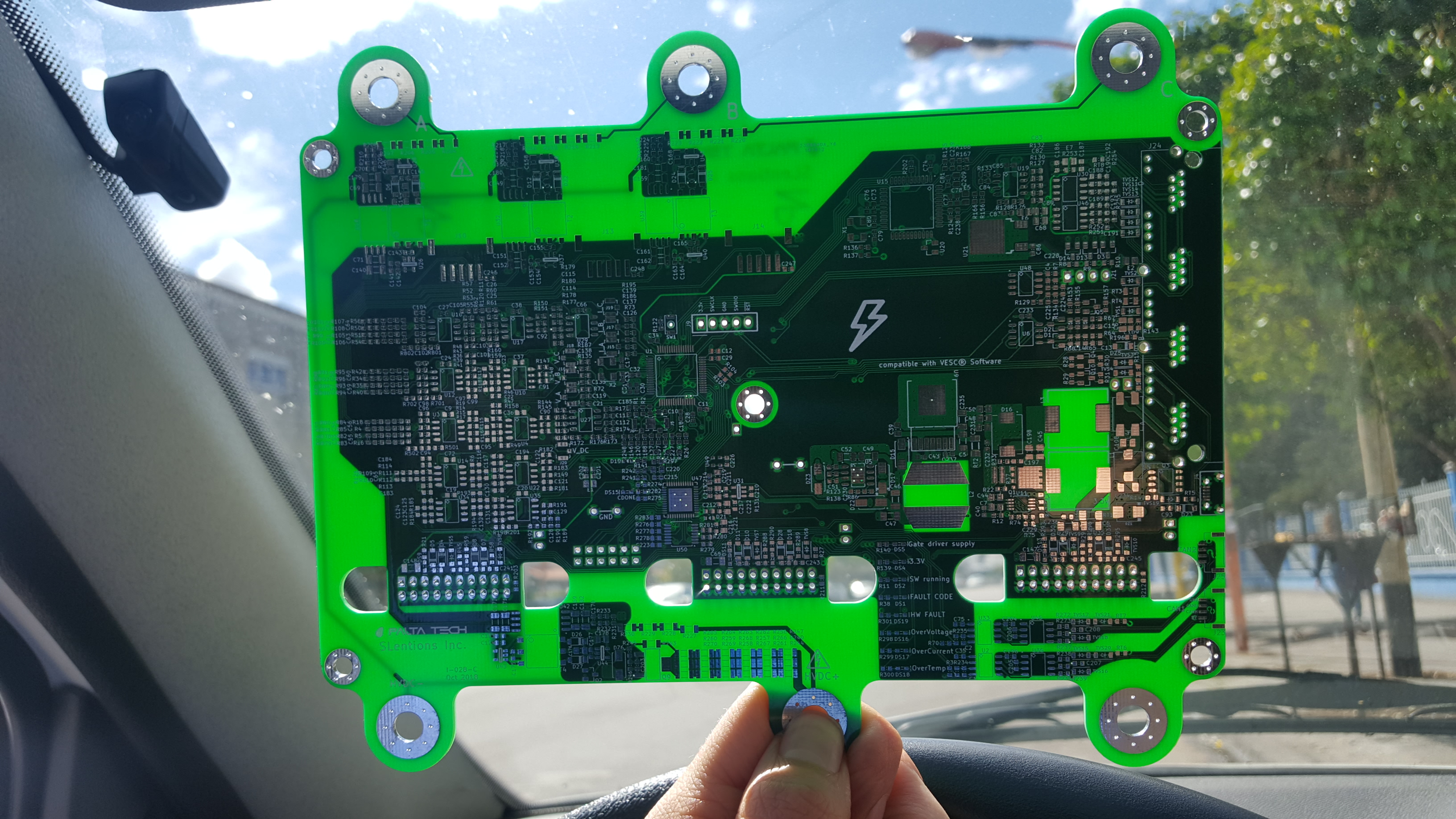

An old prototype that can show the isolation cleareances. With newer boards you don't see through the thick soldermask

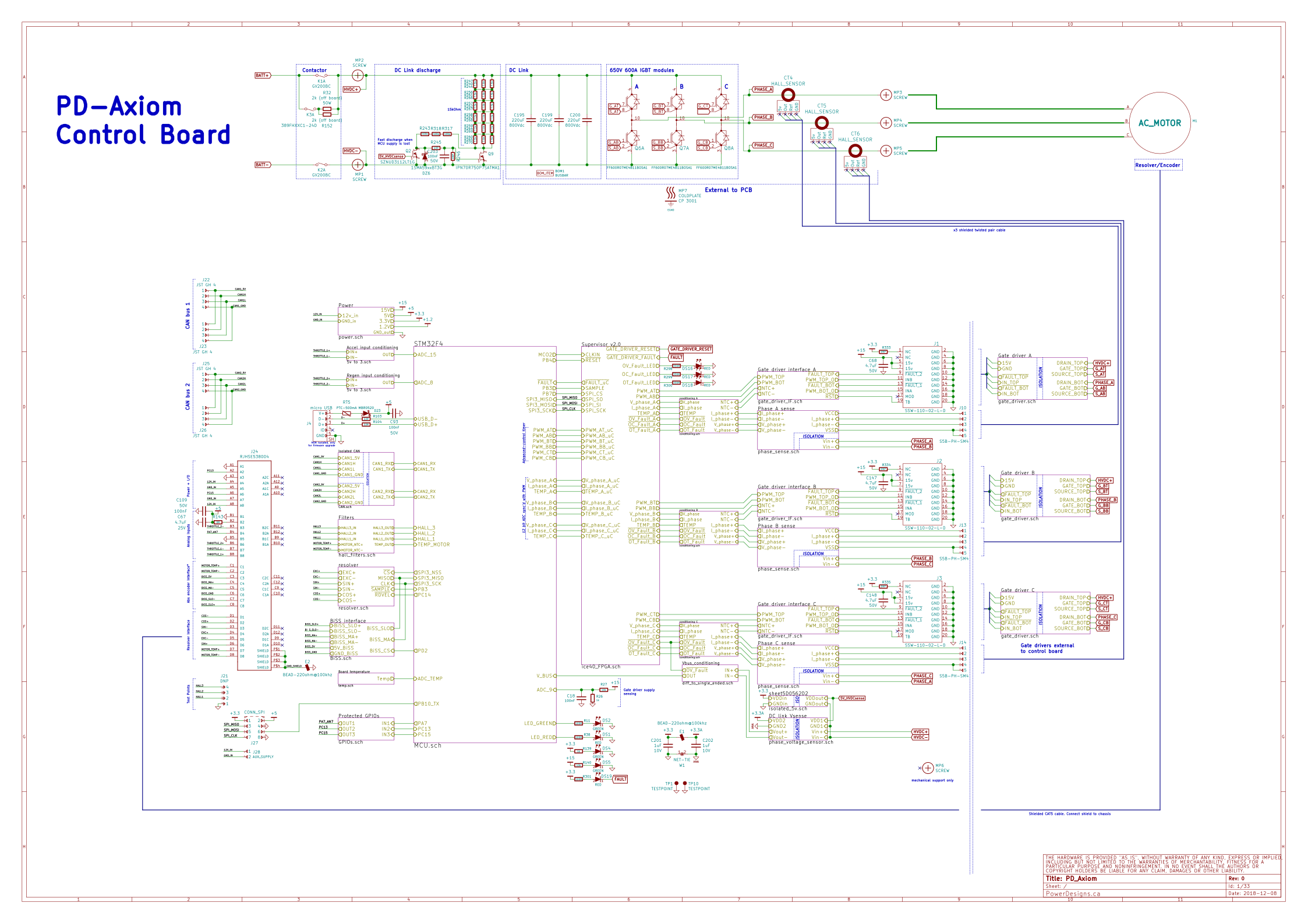

Schematic top level:

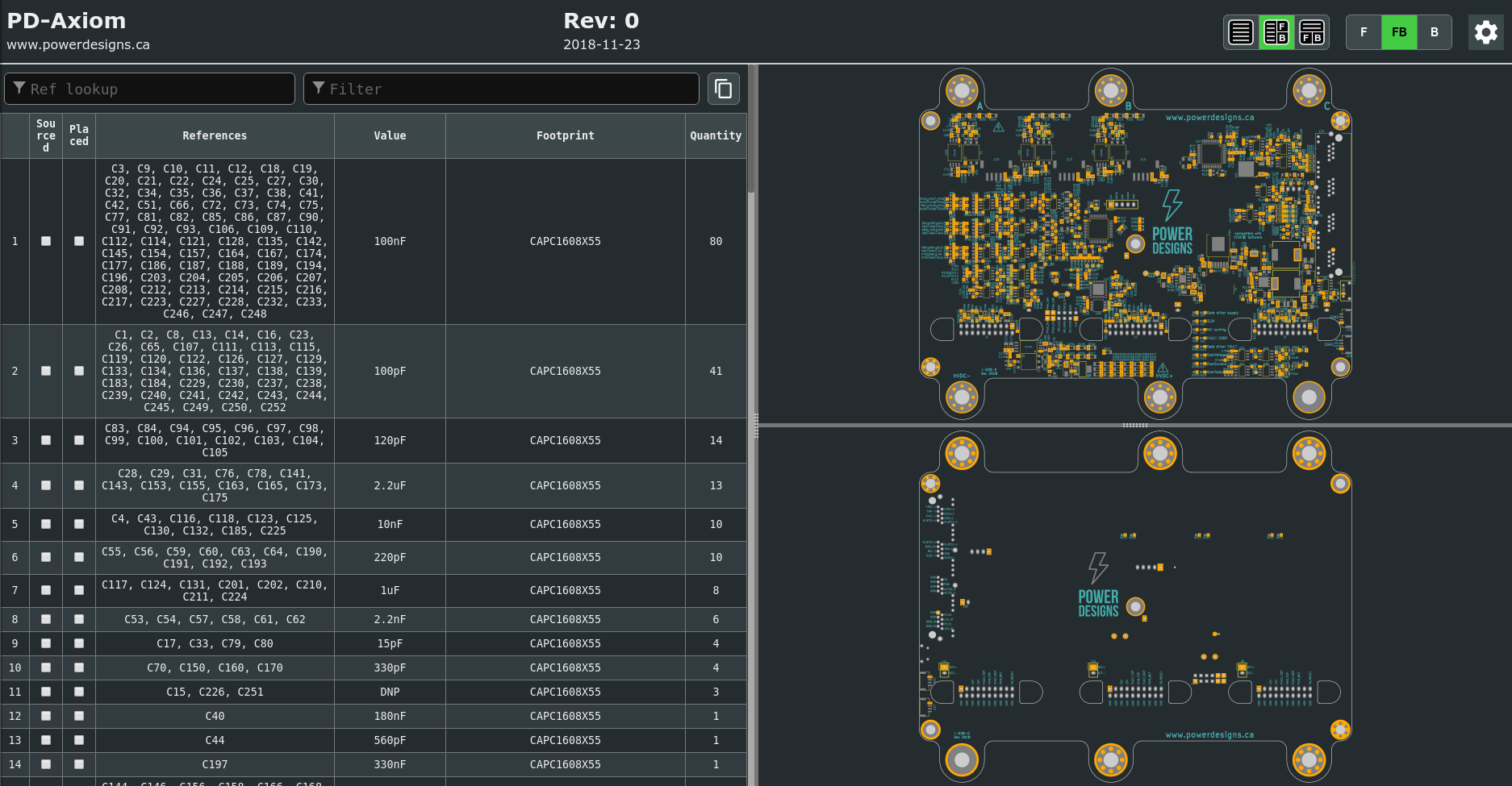

Click on the image for an interactive BOM viewer
More data, board datasheet and images will be available at www.powerdesigns.ca, as well as schematic and other design files. The build in the pictures is designed for 400V 300Amp continuous operation.

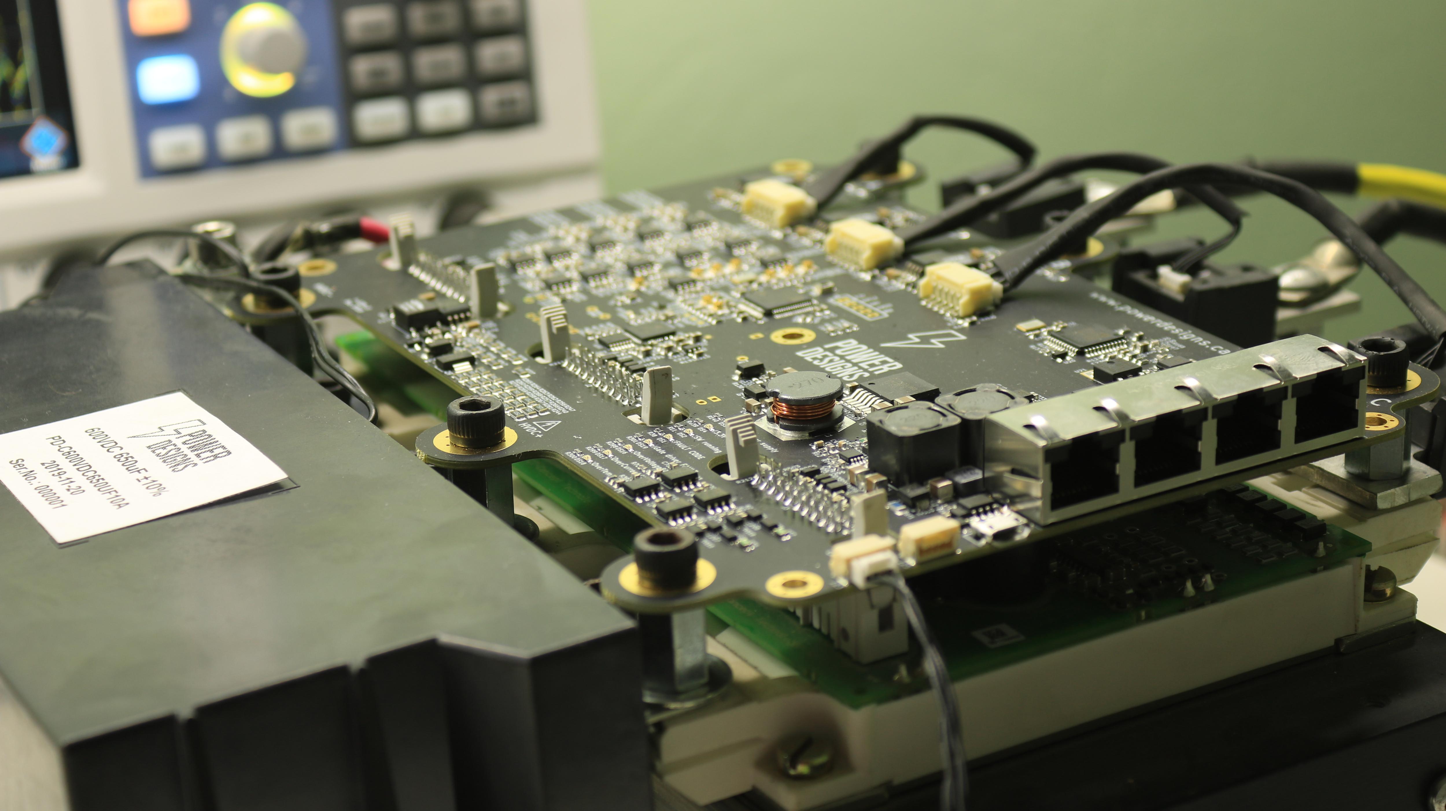

Maxi (co-founder engineer at paltatech) and me switched gears some months ago to firmware developing and testing when the hardware design was settled, meanwhile some alpha users start putting some miles on this, not many miles actually, we are still craving for testers and we don't claim it comes without bugs. All the code we provide for these high power applications is carefully crafted for direct integration into the VESC codebase so it stays public and well maintained.
Hardware-wise, we have math for finely setting our trip points, which we can easy tune at will by changing resistors, and the FPGA is a very powerful addition for co-processing and safety functions. We went as far as designing our own DC Link with an OEM, shown in the pictures and still under testing.
Its quite a compact and tidy unit.
