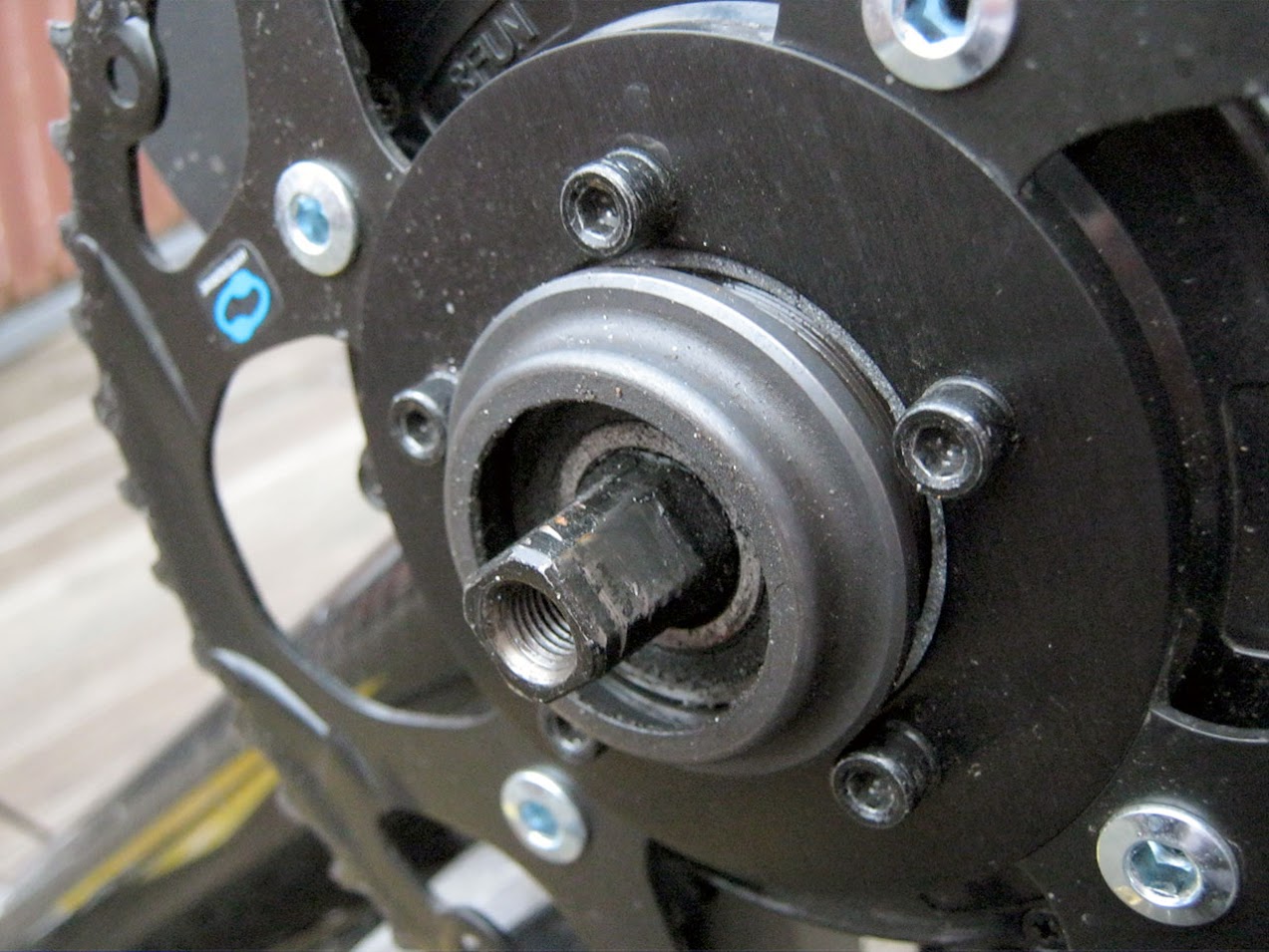

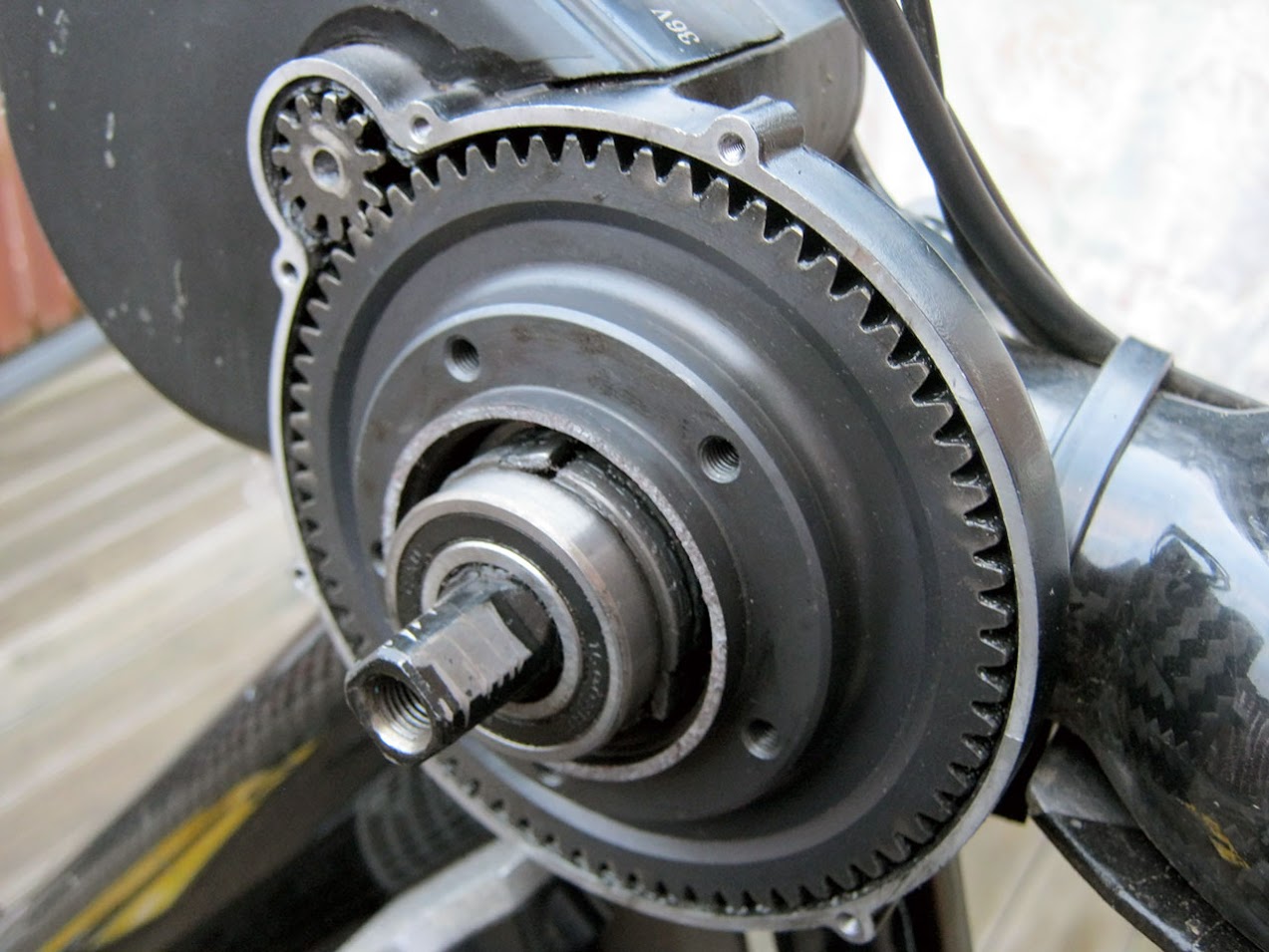

Upon further investigation It looks like the end-bell gave way under pressure internally. The ratchet "ring" seems to be the culprit; as the cranks rotate the ring
wants to undo and force against the end-bell casting.

Any suggestions for how best to fix this?
It looks like the assembly will have to be replaced. Thankfully it's $70AUD inc post (emax.com.au)
As for removing the crank I had a bloke look and couldn't find any detailed instructions so I "winged" it.

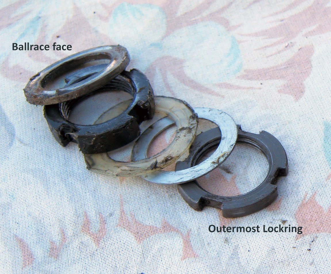

On the non-drive side, use needle-nosed pliers to remove outer lockring then seals/ ballrace face then inner lockring and the order of components is thus:
0XXu1mgT5WzWS2-L2CEv_LibOI1Q85vU-n41Qwno4sI=w1152-h955-no
Which leaves just rhe ballrace looking at you. This means you can now remove the crank.

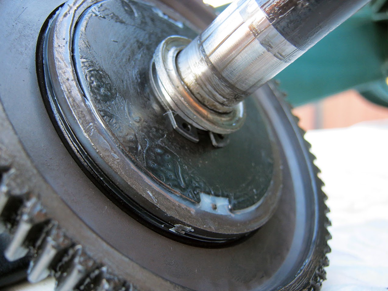

nuX2eoIJjnxERH5qF4IjlnQZBCxKIsfPWJCJA8RWa58=w1274-h955-no
Crank assy looks like new.

Bearings all seemed AOK

I believe that the screws holding the chainwheel hasn't been properly tightened. This led to the chainwheel loading the end-bell going through a load-cycle every revolution of the chainwheel. The cracked surface sure looks like it suffered fatigue. Given 60Hz cadence and a km covered every 2 minutes (120 cycles per km) - your end-bell went through 325000 load cycles :p

Chainwheel screws were tight.
I reckon something has come adrift inside; the ratchet ring (the ring the pawls engage with) is threaded and it only took 100m of cycling
for it to undo and force against the endbell. For some reason it came adrift.
I'll pull it apart when I get the first chance.
