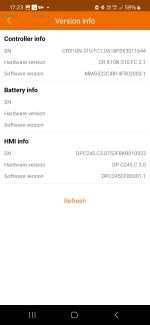

hey ... need help!!
i bought new m510 and dpc 245 v3 . all seems fine except I can't go into motor tuning... I have "operation failed " message ...
can't set wheel or max speed ... anyone knows what might be wrong?

My display is DPC245CF80301.2 (DPC 245 3.0), motor HW is FC2.1.
I need to log in to Go+ to do anything (even to connect the app to the display).
I can change the speed % and it sticks. The reduced speed seems to be obeyed but it's a soft cutoff.

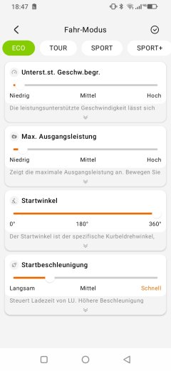

may you elaborate on what are you asking ? and maybe post screen in english ?
im afraid not . maybe in third party app , but bafang Go app gives you only what you showed before
The Go+ App is OK and there is much talk about it bricking motors etc but I think if you set the unit up to the motor its actually being used with ( if you have say a M510 and M820 motor I have to manually configure it to change its settings over to each motor otherwise it will 0 out all the settings for the wrong motor ). To be aware though that the Go+ App will only set what is available to be set in your region hence the need to set up an account and log in. Speed for example is not accessible nor wheel size, they can only be changed using BESST by a dealer or using the Python hack many use. On some motors the assist levels are the only thing able to be changed.
Go+ also with some motors will only allow a max of 400% assist and yet with BESST it will allow up to 500%
If you have an older Bafang display with only BTE 5.0 then use the older Bafang Go App, has many of the same features and in some ways a bit more robust.

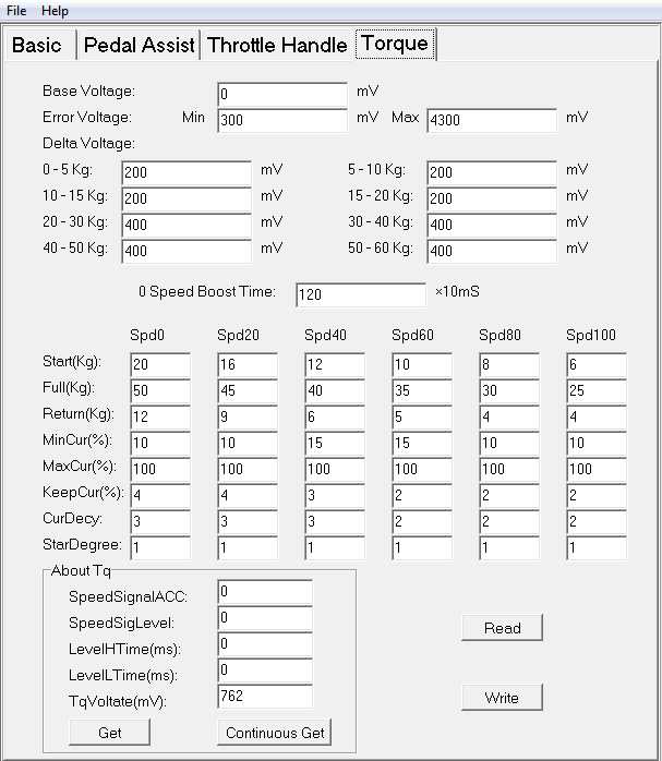

I'm asking, if there is a screen in the app, that let you set up the torquesensor parameters, if a CAN-Torquesensor is attached.
Similar to the UART system:
Depends on the motor, the later M510's and M560's using Go+ have a very nice way of setting the A's rate and ramp up of the motor but the M820 does not have this despite being released later than the M510.
