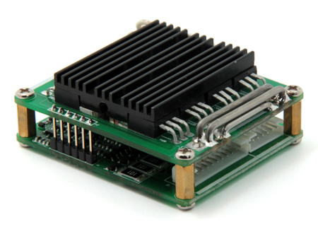

I need information concerning powering up a Bestech HCX-D205, 48V, 20A BMS card with e-switch. I have seen a lot of information about BMS function and purpose but little about installation.
What is the proper sequence to startup?
1. BMS is in series with the negative?
2. Connect negative battery lead?
3. Connect positive lead?
4. Activate - e-switch?
5. Insert JST balance connector at angle, #1 cell first with or without e-switch on?
Have burnt up the 101 resistors on two boards.
If the resistors are burning up, double check the wiring between the cells and the balance connector. That can happen when a pair of wires got swapped. Measure voltage from pin 1 to pin 2, then 2 to 3 and so on up the line. You should see a single cell voltage on each pair, something around 4v. I use skinny wire probes that fit into the slots on the wire side of the connector, but any probes that fit will work. Just be very careful not to short the probes when measuring. Do this before attempting to attach the BMS.
If they all look correct, I would attach the battery negative, balance connector, then battery positive, but the order shouldn't really matter if everything else is good. Make sure the charger and controller lines are disconnected until after the other connections are made.
The D205 is very similar to the D245 which I have some experience with. It was an odd bugger. However, burning up balance bleed resistors - something's wired wrong.
But when they’re wired properly I know from experience the D245 wouldn’t function until a charge is applied. Once a charge has been applied, just for a brief moment, the BMS/PCM functions fine. No mention of this in documentation and it can be a bad problem if you're out on the road and for some reason disconnect the BMS. It ain't coming back ON without a jolt from a charger or something with higher potential.

1. Connected Battery Negative to B- on BMS
2. Connected P- to circuit (no load)
3. Install cell balance plug at angle toward cell 1 and insert.
SMOKED ANOTHER TWO 101 RESISTORS ON THE EDGE OF THE NEWBOARD!
fechter said:
Which resistors are smoking?
This. And why are you plugging the JST connector at an angle? I always avoid doing that.
The idea is to make the cell connections sequentially so that you don't get more than one cell voltage across the shunt circuits.
If you attached the pack negative, then say the most positive cell, you'd wind up with a bunch of floating shunt circuits trying to equalize the full pack voltage. This may result in some shunts turning on and giving more than normal voltage to an adjacent cell circuit.
If you just make the connection quick, there shouldn't be enough time to fry anything, but it doesn't hurt to avoid potentially damaging conditions.

I burned up at least two 101 resistors, both sides of lower board level near cell one of the balance plug
Yes, post a picture of which resistors are burning. This will help a lot to figure out what might be happening.

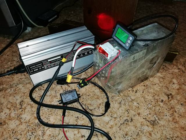

Guys, i have such PCB on my battery HCX-D132
Please help me with PCB disconnecting/connecting. I like to add power metter to battery between battery "-" and PCB.
What is right disconnect and connect order? I mean B- and balancing connectors. Can i just disconnect B- from PCB and reconnect it back if balancing connectors are connected?
Thanks!
As long as all the balance wires stay connected, I think you can disconnect the B- wire to insert your meter without risking blowing the thing up (assuming you don't accidently contact the wrong thing). Just make sure the B- line is intact before turning on the load.
i don't see a need for special connect/disconnect order.
if you only disconnect B- at any time, there is still a connection to most negative cell of the pack by the first balance wire.
if you disconnect the balance wires at all and have the main power leads connected the BMS doesn't care about it.
