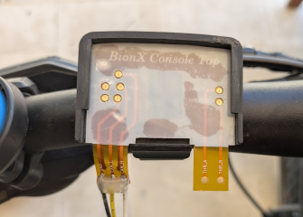

I needed to change the settings on my BionX G2 system to comply with updated local legislation, and didn't want
to spend $100+ on a BBI tool plus find the software.
So I found the old BigXionFlasher project and re-wrote it to use cheap (<$10) USB CANBus adapters, then
added a bunch more features. It supports querying and tweaking all the usual hardware info and settings, plus
arbitrary other settings too - it also supports sniffing and decoding of the running system CANBus traffic.
It's on my Github and runs on any Linux system (incl RPi): GitHub - buxtronix/BionXtool: A tool for diagnostics, configuration, and real-time monitoring of BionX e-bike components
I also wrote a bunch of documentation on the wiring and protocol, as well as designs for a cheap (~$5) shim PCB
made to easily tap into the CANBus (I also mention other options).
