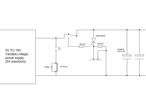

hi I'm actually gonna get into this game myself :p Got a car cap (2F hope it's at least 1.5) a 2000V 210 thyristor (off eBay has actually two thyristors inside) and a footswitch. Planning on using my 12V net (which is somewhere from 15V to 11.5V depending on time of day and charge level :p. The things I have not figured out yet:
A. how to trigger the thyristor thinking about using a 7805 based supply with a transistor that get's triggered when I hit the foot switch.
B. how to disconnect the current from charging the cap so it will reset itself, was thinking the same voltage that triggers the thyristor would also trigger a relay, however I think I should use a small cap there behind a transistor as a switch to keep the relay open for just a short while longer. I dunno exactly yet, but I was thinking that would help so the scr will reset itself.
I really need to read up more on using a transistor as a switch. Also I will probably use a 2N2222 in conjunction with some other transistor to make the relay circuit that way I can use 5V to switch on the thyristor but 12V on the relay.
well any hints would be appriciated.

Hi,
You don't need anything fancy to trigger the thyristor, just a switch and a current limiting resistor from your main supply. Take a look at the circuit I posted for mine, a page or two back - you can see that I just trigger my thyristor from the charge on the capacitor, it works a treat.
The same goes for cutting off the charge whilst the thyristor is on, if you look at my circuit you can see that the trigger relay switches the supply off for as long as the push button is pressed.
There's no need for any fancy circuits, just a trigger button, changeover contact relay and current limiting resistor are all teh parts you need to trigger the thyristor reliably and not short out your supply with it.
Hope this helps,
Jeremy

I guess you already know that you only need to use one of the two thyristors in that package, but one looks as if it will do fine, as it has a peak current rating of over 8000 amps at the sort of temperature and pulse width a CD welder works at.
I've drawn you a circuit diagram, using this thyristor and using a changeover relay and push button for charge and "fire" control. Hopefully it should be self-explanatory. The relay in the diagram is shown in the non-activated position, with the normally closed contact charging the capacitor.
Good luck!
Jeremy

Pretty much any old diode will do - it's not really essential - you could leave it out, all it does is limit the spikes from the relay to be a little bit kinder on the push switch contacts. It'll work fine without it.
The relay needs to be a changeover type, one that switches a connection from one terminal to another, rather then just on and off. Some car relays are changeover types and would be ideal. They often have a small diagram on the side showing the connections.

That configuration will work just as well as the way I made mine; mine triggers fine and gives more than enough welding current, probably because I'm using the full capacitor voltage to trigger the thyristor, rather than a small battery.
I only put the thyristor in the "feed" to the electrodes so that I could have one electrode permanently grounded. This just made it easier to build the lever operated rig, as I only needed to make sure that one electrode was insulated from the metalwork. It also made the thing a bit safer, as there were then no live connections anywhere that were exposed (the live side of the thyristor and capacitor bank are inside the wooden base box).
Sorry, I've just realised I made a mistake with that diagram I drew for you. I meant it to be the same as this one, but using your thyristor (please ignore the other 8.2 ohm resistor, I later removed it as it didn't wholly do what I wanted, which was to act as a safety discharge for the capacitors, without needing to make a weld):
The gate resistor should have been 8.2 ohms, 5 watts. I'm really sorry about the mistake, I hope it doesn't cause too many headaches.
The gate resistor isn't that fussy, it just needs to be sized to give enough gate current to trigger the thyristor quickly (they like a fair bit of gate current, around an amp or so, to switch fast). The power rating is probably a bit of an overkill, I just happened to have a big resistor around that did the job. In theory, the resistor needs to dissipate nearly 15 watts initially, when it has about 11 or 12 volts across it, but this very quickly drops as the capacitors discharge. My 5 watt resistor barely gets warm, even after an hour or so of welding packs up, so I think I could easily have got away with maybe a 1 or 2 watt resistor.
If you can get a resistor of over a watt with a value of around 8 to 15 ohms then I think it'd be fine.
