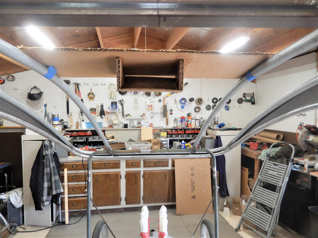

Just another thought about using the switch panel or similar.
This overhead location is much easier to get to and it isn't quite as visible.
But I'm still not satisfied.

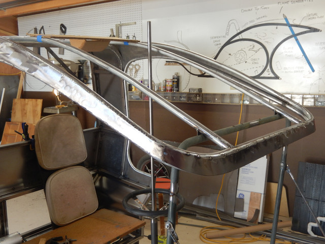

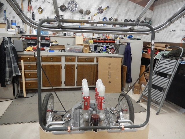

Some body and windshield frame mod.
Because I needed to raise the roof,(no pun intended), a couple of inches, I had to modify the top portion of the windshield.
So another lawn chair is sacrificed because it has nice factory corners.

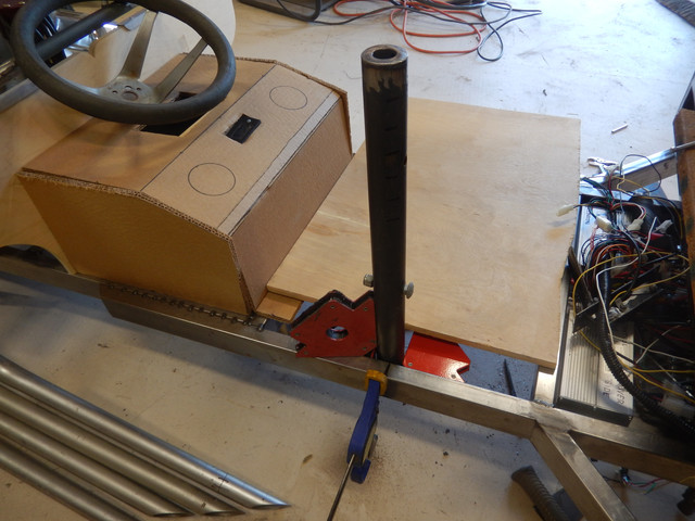

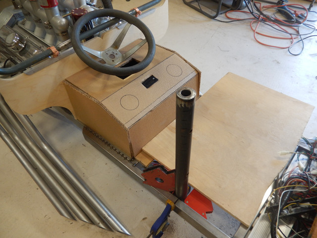

The urge to get started on the steering, hit today.

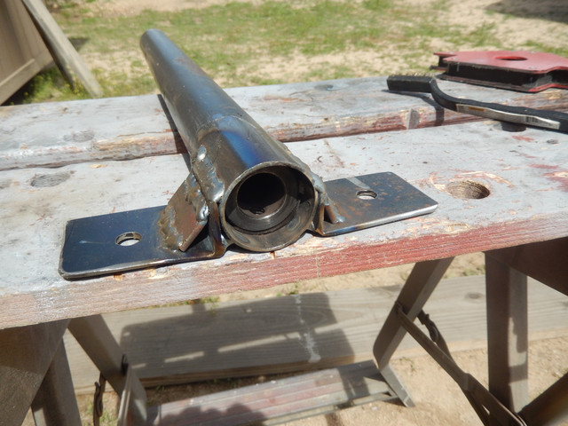

I'm using a support tube from a salvaged basketball hoop framing.
Wedged in is a 3/4" bore shaft collar. One on each end. The top shaft collar is welded near the top of the post.
The bottom is plug welded in. I took advantage of a hole that was already there.
The top of the column/post is 18 " from the frame top to the bottom of the steering wheel.
Next is to cut the 3/4" shaft and weld on a hub for securing the steering wheel.
My knees come just about the same height as the top of the steering wheel.
This is what I'm working off. It isn't exactly what the finished steering will be like, but it's close.
I haven't decided if I want/need to go to, the bother of making the DIY tilt-away option.
Looked online for quick release adapters, one which would work just right.
https://www.speedwaymotors.com/Speedway-Hex-Quick-Release-Assembly-3-4-Inch-Steel,112635.html?sku=91032847-BLU&utm_medium=CSEGoogle&utm_source=CSE&utm_campaign=CSEGOOGLE&gclid=EAIaIQobChMI2amEl4Ct6AIVENlkCh0sRQPiEAkYCyABEgJ9SfD_BwE
While setting it up, I was in/out and up/down frequently and did quite fine.
I'm sure when it's secured it won't fall over as many times... :D
Though it could be a detail used for conversation.
Also, the front brace won't be quite so large.
It's just visible, but near the bottom, just above the magnet is a bolt, that will be used to secure a front brace.

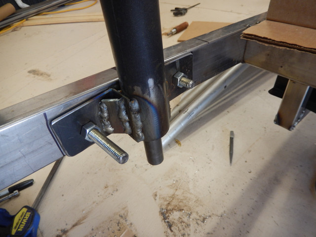

Ok, the column is done and bolted to the frame.
Doing a fit check. Can't decide if I should keep the tall shaft, and maybe use it as a flag pole, or cut it down to size.

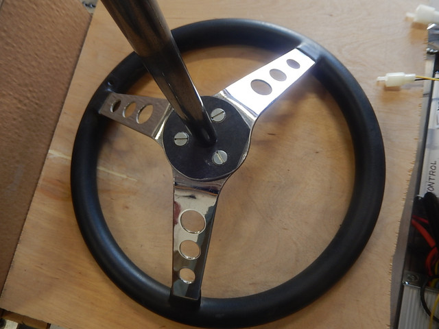

Steering Update
Cut out the hub and got it welded in place including the center cap post, twice!
The hub is solid mount at the moment but is ready for modifying to full tilt, later.
The center cap is salvaged from an old lighting fixture.
