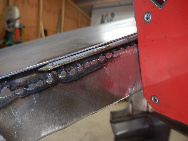

I've lifted the top 1 inch and fastened 14 inches from the end, giving a nice flare-up.
It will be contoured in with body filler.
There was a couple of points around the edge that didn't make it to 'quality school',
so had to enlist the help of a couple of nails to fill in the gaps.
I'm trying to fill in with weld material as much as possible. Not that I really need to, but it gives me practice with the welder.
Also, I want to keep the body filler to a minimum.
Using it mainly to fill in low spots, and weld pinhole areas.
I'm working with 20 gauge sheet metal so there is some blow through and subsequent repair.
My Hobart goes down to 25 amps which helps somewhat.

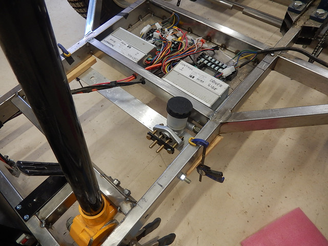

Today I mounted the throttle and cut out access through the floorboard.
I am thinking of using two master cylinders. Side-by-side.
If that is the method I use, I will cut access holes in the floorboard for getting to the fluid reservoirs.
It will also require fabricating an actuating rod that will operate both cylinders at the same time.

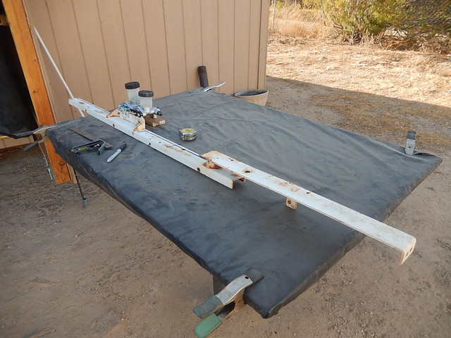

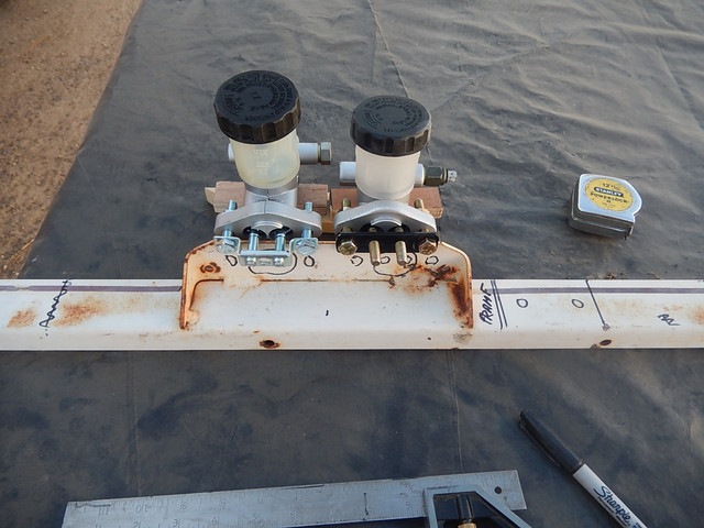

I've spent a large amount of time, trying to design the mounting for the two cylinders and the actuating arm.
The first pic shows what will become the mounting bracket for the cylinders.
It comes from an old tread mill frame.
The cylinders will be mounted to what used to hold the treadmill footplate.

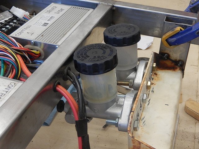

Here you can see where the cylinders will be mounted.
The black metal piece is from my old garden tractor. It was used as part of the mower blade lifting mechanism.
Now I will cut it down to fit this application. The 'arms' are just right, width-wise but will need shortening.
The shaft will be housed inside the frame rails, except for the arm that will attach through the frame to the brake pedal.
An overview of how it all ties together.

I think I will not use the actuator arm I have. After seeing this part of the install,
I think a less bulky, possibly adjustable shaft will be better.
There might be a tendency for one cylinder to travel a bit further than the other resulting in uneven force. I guess cars with dual cylinder brakes are like this too and they work, but I was thinking you might want some kind of linkage that applies equal force to both cylinders. If there is some adjustment, that might be good enough.
The push rods (2 each) on each cylinder are adjustable. As we speak I am mentally designing the shaft with two actuating arms that will also be adjustable. I haven't fully thought it through yet, so there may be a glitch I haven't thought of yet.
If you had a bar that goes across both actuators and push on the middle of the bar with a pivot, the force would always be equal on both actuators. If the pivot was off center a little, you could have more force on one side than the other if you wanted that. In your case, I think equal will be good.
by fechter » Sep 28 2020 9:18am
There's the adjustment, could add another hole off center to adjust more pressure to one or the other if needed.
You mean like this?
