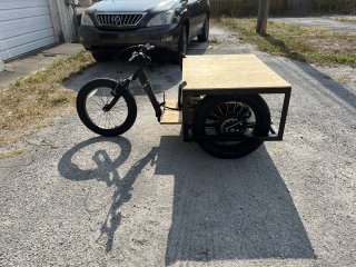

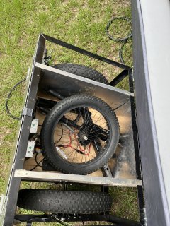

After several discussions with my local steel guy we finally decided the base of the frame would be made out of 1.5 inch, 14 gauge steel square tubing and the upper part of the frame would be 1.5 inch angle iron, mostly for strength, the steel would be stronger and more flexible for the size and price and I can weld it myself with the arc welder I already own.
After much research I decided on 20 inch 48 volt 1500 watt hub drive motors, with included controllers, throttle and wiring. Based on cost, availability and being able to procure replacement parts, tires, tubes. 1500 watts is probably more than I need but with the weight I will be carrying and the difference in cost between 750 and 1500 watts was like $10, currently on AliExpress the 1500 watt is less than the 750.

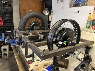

The hub motors would be mounted inside both sides of the frame to make it easier for storage and provide more seat area. Gooseneck and front fork would be detachable using a receiver hitch type system and store inside the box when in storage mode. I picked up a damaged BMX type 20 inch fat tire bicycle to scavenge the tires, front rim, fork, handle bars, steering tube and some of the brake parts.
The top of the box will be the seat.

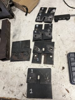

The rear axle dropouts are more of an axle drop-in. With slots cut into ¼ inch plates welded to and extending above the frame to keep the wheel mostly enclosed in the frame, providing a solid mounting place for the axles and maintaining the 24 inch overall height and providing a box large enough to store the front fork, gooseneck, front tire and battery, secondary plates slotted in the opposite direction are also bolted on. This provides a very stout axle mount that prevents axle rotation and is relatively easy to remove.
I tried having the Dropout plates cut on a plasma table, in the end it was easier to just drill and cut the slots with an angle grinder.
I am building the base of the frame first to provide proof of concept, if it doesn’t work I could still bail without much cost or effort.

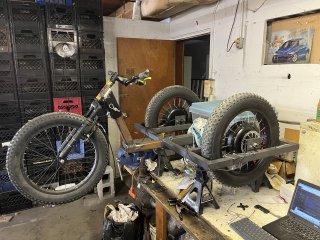

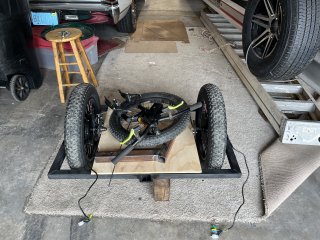

I have the frame base welded together and finally welded the dropouts in after taking way too much time to make sure the tires were aligned with each other.
The next step was to do a proof of concept and see just how viable this thing might be.

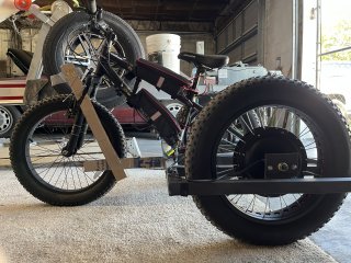

After installing the hub motors I took the frame of the donor bike and using a couple of large U-bolts attached it to the frame base then wired everything up using the 48V 14ah battery from my bike.
These are the Hub Motors I used :
AliExpress Hub Motors
Apparently I looked at them too many times and they were keeping track and emailed me a price I couldn’t refuse.
I ordered them with the cheapest controllers and displays possible, I plan on upgrading to a dual motor controller that will do reverse and regenerative braking in the future. For this testing phase I used the included hardware with a throttle for each thumb.
First with just one motor powered, then both motors. One motor was not good, skewed to one side badly, two motors, much better, first with two throttles then with both controllers wired to one throttle.
All I can say is WOW, I definitely bought too much motor, You need to be very light on the throttle or it will flip over. I’m now adding a wheelie bar to the list of requirements.
It actually ran and rode very good, almost made me stop there and keep it like that, it is very fast, scary fast, handles pretty good, stopping with just the one front rim brake was sketchy but quite the ride.
With the concept proved it is time to move to the next phase, fabricating the removable front fork and gooseneck.

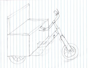

I'm looking for the 'two adults side by side' aspect?
Excuse my horrible artwork, this was my original concept drawing.
The back of the seat will fold down when in storage mode.
It will be 42 inches wide, the wife and I sat down and measured what we though was the best width for us to sit comfortably and maintain a large enough box on the inside to store the disassembled parts with an overall width small enough to easily fit in the storage bay of the RV.
Peter
Certainly. However, your photo above shows a front wheel and steering gear centered, and while the seat is wide enough, you will not be centered when the two of you are using it - this is what I was inquiring about.
As a low speed vehicle, a tiller might be better than handlebars. OTOH perhaps the handlebars are just as good and symmetric for riders stationed on either side.
Just curious.

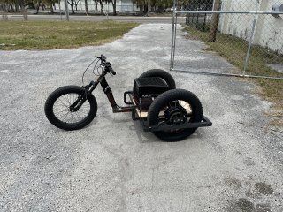

I did a little CAD (Cardboard Aided Design) to help decide the best position and angle for the front fork.
Having used 2 inch receiver hitch tube for the center of the Base, I used 2 inch receiver bar for the goose neck, Class III receiver hitches can tow something like 10,000 pounds so I feel pretty secure it can support my fat A$$. An afterthought that 1.25 inch Class 1 Receiver hitch tube would have worked just fine and weighed considerably less but the 2 inch stock was what I had sitting around the shop.
I intended to use the steering tube off the BMX frame, but instead used a longer thicker walled tube off an old Huffy frame that I had sitting around, after spending the better part of an afternoon cutting it off the bike frame and carving a piece of Receiver tube to accept the steering tube I had a fabricator friend Tig weld it together.
I cut and welded the goose neck to match the cardboard templet, drilled a few 5/8 holes for the hitch pins and mounted the BMX fork using new headset bearings.
I am pleased with the overall result, although I think I might have given it a little too much rake, it looks more like a Chopper. I will have to see how it handles. It will be relatively easy to make another gooseneck with less rake, will need to change the angle and lengths to keep the height the same, your thoughts on the Rake angle?
I took it out and rode it around the parking lot using various heights to determine the best height for the seat/top of the box, my original height of 24 inches from the floor seems to be the best overall height.
It rode and handled very good, the rake will stay the same for now, I am going to extend the gooseneck and push the front tire out at least 12 inches to provide adequate foot/floorboard room and add a little more weight advantage out front.
The gooseneck, fork and front tire disassemble in minutes just by pulling the hitch pins, an initial test shows that all the parts should fit neatly in the finished box.

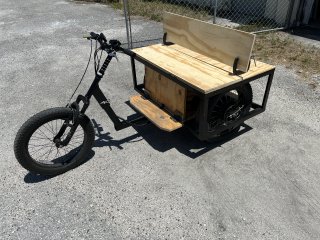

I finished welding the angle iron upper part of the frame.
Could probably add in a few more supports, but trying to keep the weight down.

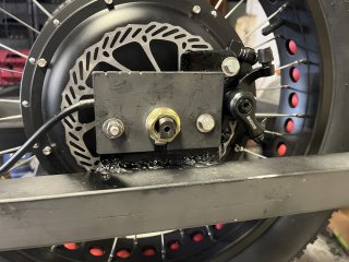

I also got some cheapo Bucklos disk brakes and welded in some caliper mounts, I was able to utilize one of the dropout plate bolts and a new tab mount welded on the top, the positioning should allow me to remove the wheel without removing the calipers, thought about using hydraulic and still might, but with the amount of movement and abuse the hoses would take when removing the front fork and handle bars for storage, figured I would try cable Brakes first. I bought a dual pull Brake handle off amazon, with a little adjusting I should be to apply even pressure to both calipers.
Dual cable Brake lever
The front rim brake works pretty good and will stay for now.

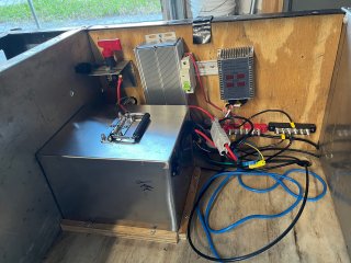

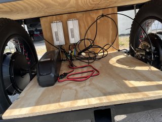

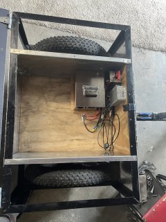

Then I started building the Box, mounting and wiring the controllers.
Waiting on the Lifepo4 battery to arrive from China, the 14ah Bike battery moves it along pretty good, but the two 1500 watt motors eat it up pretty quick.
Probably start work on the seat next, I need to hinge the top piece of plywood.

I added in a temporary front floorboard and took a couple of extended rides both with and without a passenger also had a few other people take it for a ride for feedback.
The one thing everyone agrees on is the motors are definitely too powerful, you definitely need to have a light touch when first getting on the throttle, once they have that under control everyone likes the handling and ride, The brakes are surprisingly effective.
I will look into the possibility of creating or getting if something already exists, a reduced acceleration mode, much like the Tesla Chill mode, maybe there are Motor controllers with an Easy or Soft Start?
There is not an issue with either side using the controls when two people are riding on it, I do need to put some sort of side rails or handles for the passenger to hang on to.
I stretched the gooseneck by twelve inches, this gave us much better foot room, a better angle for the handle bars and made it easier getting on and off as well as improving the feel of it while driving.
I also started working out the fitment for the seat, considering using Futon hinges so I can ratchet it up for sitting or lay it flat for storage.

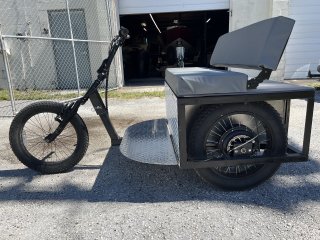

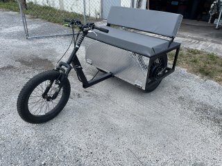

The seat didn't come out to bad given my total lack of experience in upholstery, I made the foam too thick with 4 inch foam and should have used 2 inch.
I also made a mistake using the futon hinges, although it is nice to lay it flat for storage it does not allow the seat to sit up straight enough and is just not solid enough for the rigors of a vehicle like this, I have already broken the seat back a couple of times, probably make the seat back removable for storage, any suggestions?
I have started with some aluminum diamond plate body and floor panels. The general consensus seems to be, leave the tires exposed on the side and the back as opposed to covering them over with diamond plate panels, what do you think?
It certainly is fun to drive I get people asking about it wherever we go. The range is currently limited to around 8 miles with the 14ah Bicycle Battery, I am waiting on the 100ah LifePO4 battery to arrive from China before I do any big changes to the wiring or add any accessories.
