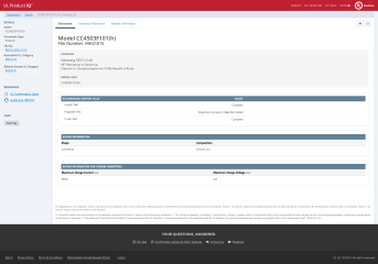

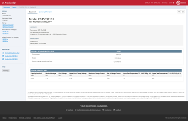

One of my suppliers has also indicated the Samsung 58E is on the market (marked as CC5493F101), Queenbattery has it as well. QB also has EVE's 58E now.

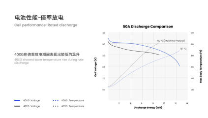

A 21700 tabless cell with SOP scheduled for 2025Q2: Tenpower's INR21700-40XG (4.0Ah)
P.S: There is also the INR21700-50SG and INR21700-50XG (tabless) in the Tenpower's 21700 roadmap, but as of today no further information has been made public about them yet. Apparently there's also a 46mm "Ultra Power" variant in the works:
