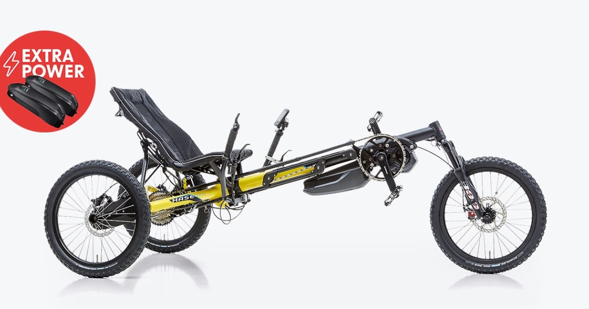

Has anyone seen a conventional trike with rear suspension? does this beast exist and I just missed it?
Stick the 2 wheels at the front and allow the single rear wheel to pivot as and when, stiffness or flexibility can be a feature of the connecting frame.
Its a significant engineering rewelding job anyway so why not?
Many, perhaps most, pedicabs use a swingarm with the passenger platform on it. So there's no articulation between the head tube and rear axle, but there very much is rear suspension when the trike is loaded.
Sun Seeker has a model with midship suspension that could be characterized as rear suspension. But the rider isn't "above" the suspension, instead being seated on the swingarm.
