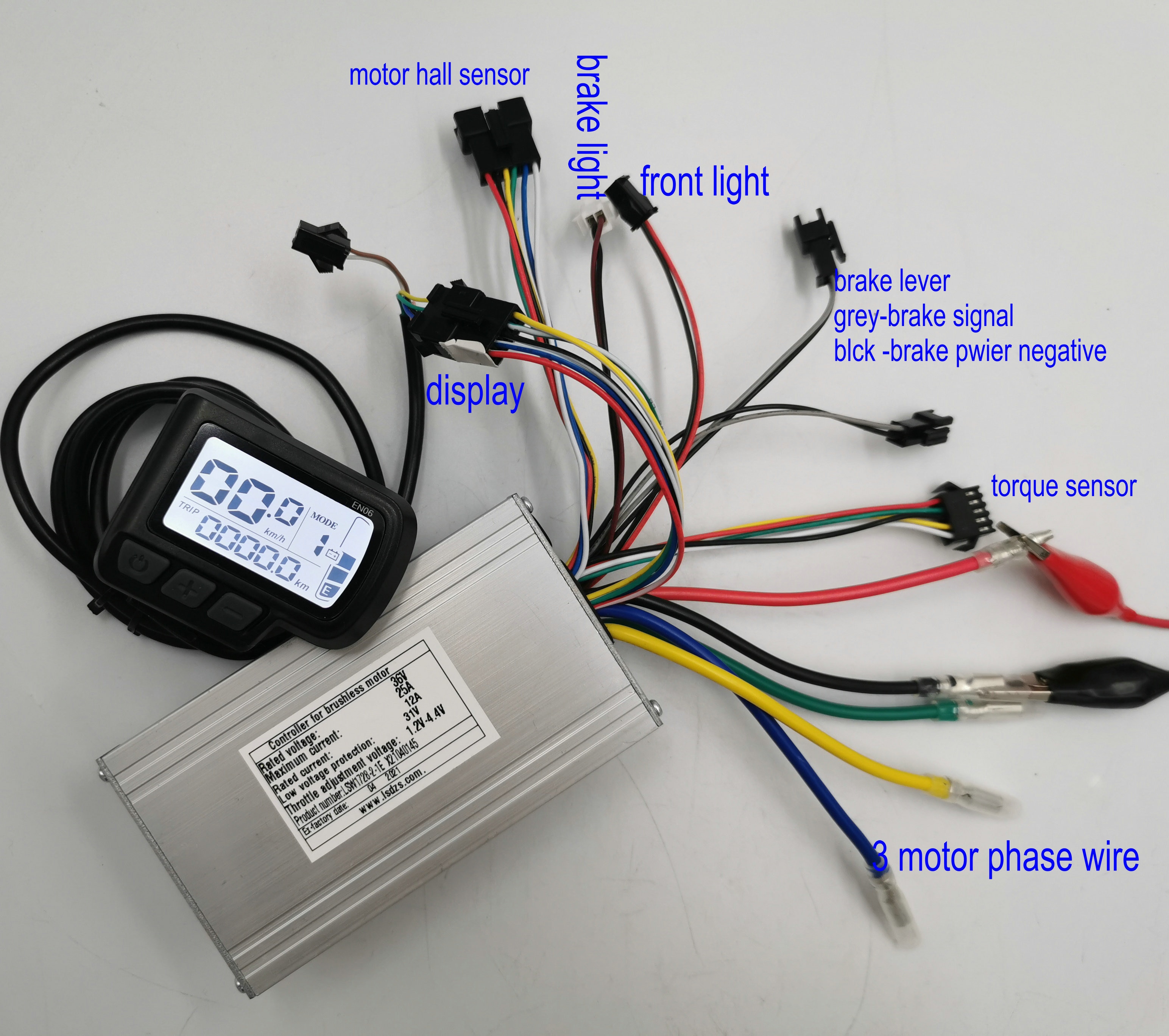

One more quick question, I found brake light pin in the code, what's that for?
The new generation Lishui Controllers have a digital output on PB10. The 12Fet from PhoeLiu has two light modules attached to the PCB, one for the normal light output and one for a brakelight.
regards
stancecoke

The brake light pin, would a SSr like G3VM-61A1 work as the light switch module, to use on old controllers? Does the light work when regen braking?
