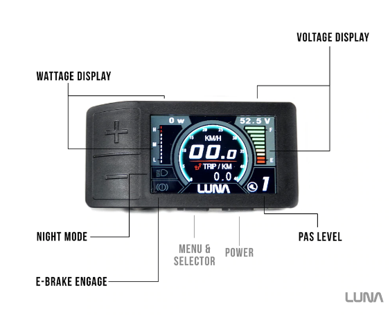

@bzhwindtalker Is it possible to change the Bafang 750c display to another smaller one with the Silixcon controller?
Egg rider clone?
SW102-LCD-Mini-Electric-Bike-Display-Waterproof-Speed-Controller-For-Bafang-BBS01-BBS02-BBSHD-Mid-Motor.jpg_Q90.jpg_.webp
https://endless-sphere.com/forums/viewtopic.php?t=99698
Or another bafang display:
Would be nice to have display options if they would work with Silixcon without to much programming/configuring..
