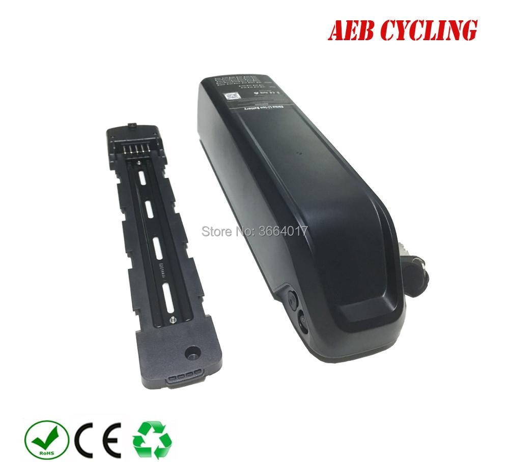

Looking into the battery options for my LMX 64 now and I'm getting confused about what might work. The manual says this:
"Designed for reention DP-6 cases (70cells) as "jumbo" packs sold by EM3EV
Fits hailong (14s4p 56 cells) and big hailong (14s5p 70cells) battery but the side access ports for charge and key may not line up as well.
EM3EV do not sell bare cases, so looking elsewhere I cannot find any reention DP-6 cases or matching mounting brackets available anywhere.
This thread leads me to believe the Tigershark case might match though: https://endless-sphere.com/forums/viewtopic.php?t=89860
So this case might work:
https://bmsbattery.com/home/995-181...0-cells.html#/137-color-black/498-voltage-48v
But it does not come with a mounting bracket and I have no idea what is compatible with both the bike mounting holes and the battery.
The alternative option is the Big Hailong case, but as mentioned in the manual things might not line up as well. I found one reasonably priced case with mount:
https://www.aliexpress.com/item/32976959578.html?
Anyone else in a similar situation or have any thoughts on what case to get?
I intend to use this case to do some modelling off and down the track design and 3D print a bigger case to maximise available cell capacity. For now though I just want to get it rolling with a standard case.
Cheers
Actually looking at this some more, the mounting bracket on LMX website for their battery doesn't match any of the options I posted above.
https://lmxbikes.com/en/drivetrain/189-batterie-52v-pour-lmx64.html
Looking around a bit more for a match I came across the super shark case + mount:
https://www.aliexpress.com/item/33037979381.html?
This looks like what we need. Not the cheapest option, but at least it should fit well.
Adam can you help us out with some advise here on what will/won't fit?

I got a Jumbo-Pack from Em3ev and it doesn't fit well, but it fits. I shorted the wire and put the xt90 connector under the motor, (where the controller is). But i still need 1 more centimeter to use lock it with the key. I will make some photos later to make it understandable. Ps: sorry for my bad english :mrgreen:

On the first picture you might see a 1cm Space between the slider and the cablehole. I want to drill some holes in the slider to fit it close to tge cablehole without squizing the cable.

Hello, you should be able to bring the plastic guard lower to line the holes.
Adam
Yeeess Thanks adam ! Didn't thought about it.
