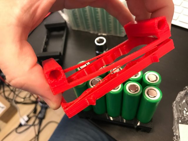

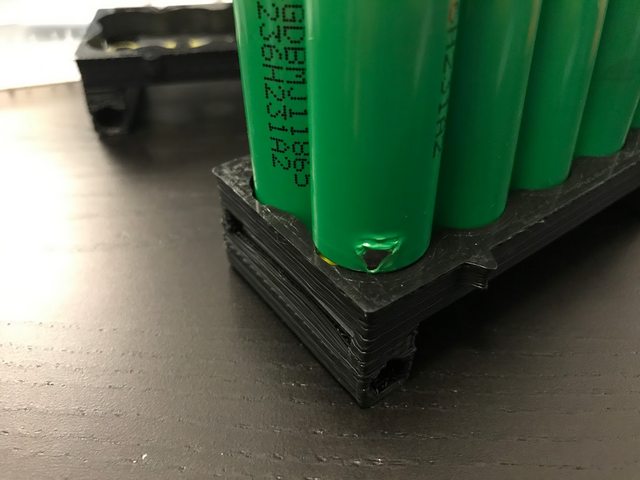

I'm a bit upset- I started putting my battery blocs together and I guess I got a few defect 3d printed modules. When I put the 16 cell one together it was fine, these 10P ones a lot of them don't fit the cells correctly. I thought it was just a "tight fit" and until the plastic holder scratched off some of outer plastic of my nice shiny new LG cell :evil: :twisted: :shock: Some of them also haven't been printed properly. Its unfortunate there hasn't been any kind of quality checking.
Anyways I've left a message with Shawn hopefully it can be resolved. I've managed to put together ten 10P packs so far, the ones in the cardboard box are defects- broken or dont fit
Hmm that does not look promising. Too bad quality control is lacking, hopefully you get replacement parts.
I think I will look for other solutions for a battery build. Still not given up on the idea of solder less pack, so I will keep searching.
For now lets hope this a an isolated incident and that the man behind the battery blocks resolve the issues for future customer. Will keep an eye on this thread crossing my fingers this get fixed and you have no other problems assembly the pack.

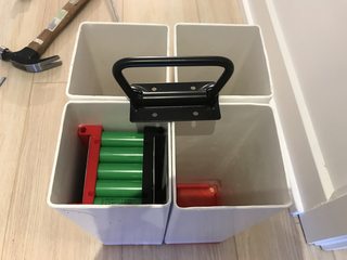

Tired of waiting for the new BatteryBlocs so I started making the plastic casing. Cut the plastic pipes, battery blocs fit perfectly- such good protection for them. So the red caps will be nuts and washers on the end. Then an extra nut at the end before the plastic lid to keep them all together.

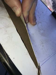

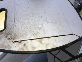

I had this idea of using a $8 cutting board as the lid, but found out it was just crappy fiber-board covered in plastic sheet. Since I have extra room at the top I think it would be cool to get some clear plexi-glass then I can see the CellLogs inside. I'll also mount some switches to turn them on and off. I got this metal handle I can bolt on also.
Got a bunch of little warning indicator lights, these will work great as dashboard visual indicators hopefully I'm able to attach to the CellLog alarm-out wires
That cutting board seems like the best way to get HDPE. I think I might go with clear plexiglass this time, when I wont have to figure out how to mount the CellLogs to the outside of the top lid. All I'll have on top is the handle and 4 switches and I'll be able to see the CellLogs inside
I finally got the BatteryBlocs replacements. This 3D print run seems to be much more solid- I can even tell the red plastic colour has changed and the "DPI" seems to be 'thicker' if that makes sense. Really appreciate Shawn sending these replacements. I completely love this idea, they go together so easily, I will keep this updated with performance metrics I get from my CA.

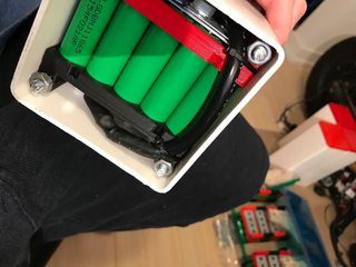

So I put together the first 18v pack- being veeery careful with my impact drill on those nylon bolts- only really to get them most of the way then finger tighten. Shawn supplied me double the metal plates for series connections, since there is a fair bit of current going through. I put the fat terminals on then ends ready for the 6awg. It should work out ok since there are gaps for wires to run along the side and up. I will have to angle the negative terminal at the bottom so when it stands vertically it doesn't damage it. Maybe ill put them on one of the 2 inner bolts- we'll see for a better angle.
I tells ya once all the bolts are together and the threaded rods are through this thing feels SOLID (I screwed up cutting these rods too short having forgot about the red end caps, gap at the top and plexiglass lid so they're for testing now). After it goes into the plastic pipe its going to be next to indestructible haha. It does add quite a bit of weight but I'm willing to take that considering how repairable and re-buildable this will be. There's also a nice bit of gappage between the cells for air flow.

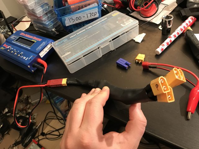

Setup the xt60's for parallel harness (ready for parallel 5S 21v balance charging). I balanced charged 1 pack from 3.5v to 4.2v at only 2amps- and it took like a 1.5 days! I'm glad I have my lifepo4 20ah pack to use when this pack needs balancing. It showed about 20ah for 3500mah cells which seemed about right considering the cells were already partially charged.
Will do a full balance when they're all together- I wonder what amps I could charge at when 'fast charging'. BatteryBro says fast charging is supported, but doesn't mention what amps.

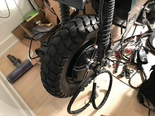

Also changed the hub motor on the tubeless tire. Good lord that was a pain the ass. Lots of windex, sweat and beer. I managed to use the disc and caliper that was on the previous hub motor, it fitted like a glove!!
Removing the valve was annoying too. I have to say though compared to the hold hub motor the new ones must be about 3 times as heavy. QS seem to make really solid product. The phase wire difference is quite noticeable too
