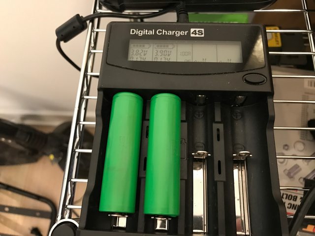

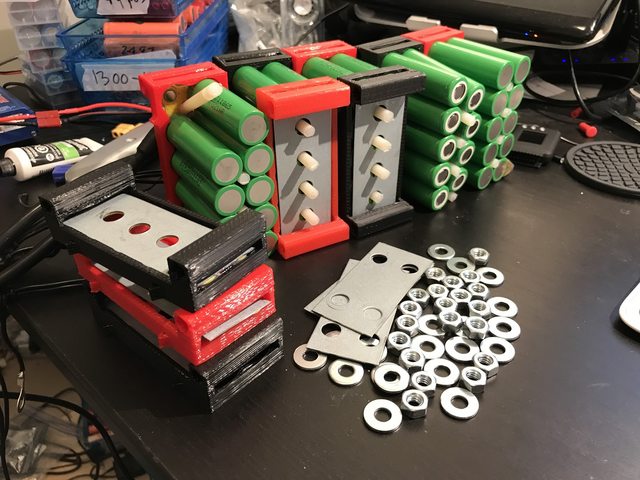

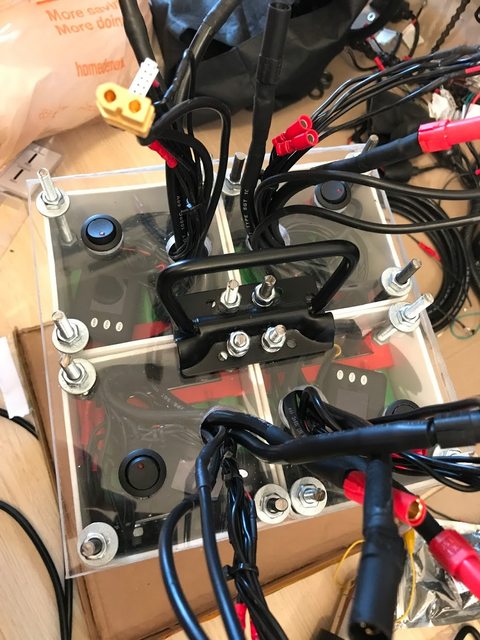

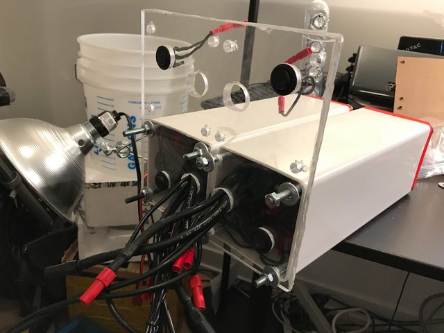

I finished my modular battery version 1.0! I messed up by charging 4 of the 18650 cells then proceeded to put them all together. I noticed weird balancing differences within the pack. So I dismantled each stack and found the 3.5v cells (others were 4.2v). I charged them up to match the other voltages. +1 for modular battery! Imagine if I had spot welded, heat shrink etc. I would never have known and the pack would be more and more damaged over time.

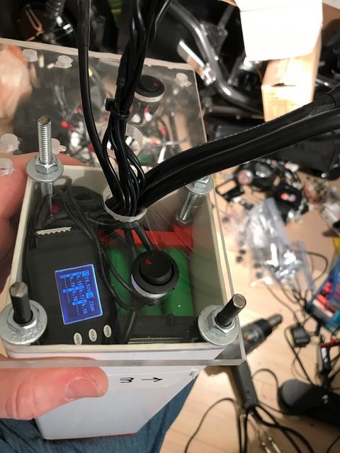

The CellLogs are under the plexiglass, perhaps for version 1.1 I'll figure a way to stick them to the underside of the plexiglass and have them all facing the same way to make them easier to read. Also regarding water I think making a cover that fits over the top and cut some drain holes in the bottom of the battery box- although there were no holes when the SLA batteries were in there. Perhaps the seat cover protects agains the rain for the most part. I don't plan to ride in torrential rain.
Anyways each 5S stack has a switch to turn on and off the CellLog. Each stack has main discharge XT150 terminals, XT60 for charging, JST 5S for balancing and 2 female bullets for CellLog output alarm which I'm going to wire red lights up to the front dash on the bike.
Currently I have each alarm set to go off for the below. Is 3.0v a good alarm voltage? Or should it be more like 3.3-3.4v? Obviously I don't want to overdischarge and damage my cells, and if I plan on a big trip I would definitely bring a secondary battery to switch to.
4.22v - over voltage
3.0v - under voltage
100mV - cell difference
Apart from my 72v lifepo4, I have a bunch of 48v batteries which I could use as emergency (have an Anderson connecter wired into the trunk box) obviously I wouldn't have the same performance, but at least I'd be able to make it home (or part of the way).

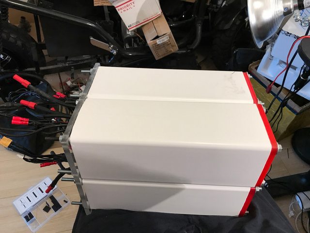

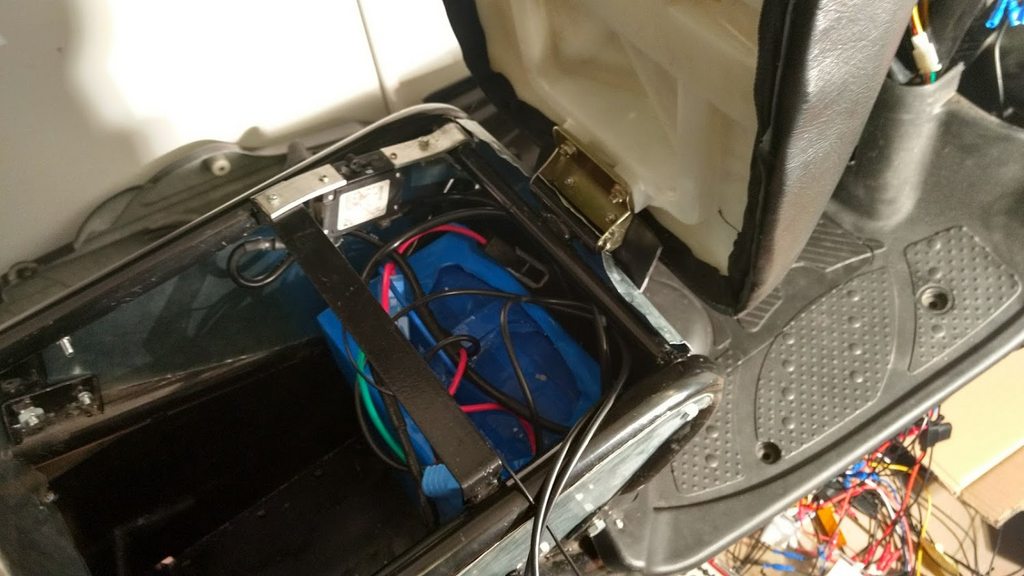

I put a little handle in the middle, though the holes aren't ideal, seems very sturdy with 4 bolts and able to take the weight
Here is how it fits in the battery box. After I cut the bar I'll have room for the secondary lifepo4 battery. Going to add some padding inside the box also.

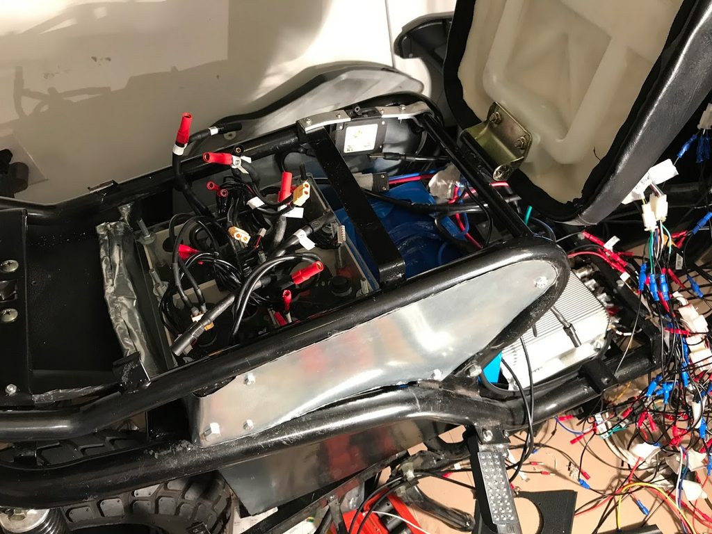

I haven't had a chance to work on this for a while, managed to do some minor things. Prepping the smart-charger with bullet connectors, bolting down controller, DC converters, main contactor and shunt for CA. Shunt doesnt look the prettiest (on an angle) but is bolted down quite solid.

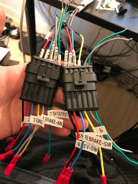

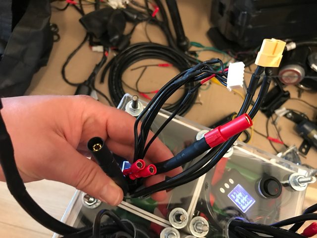

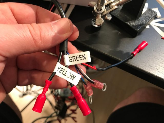

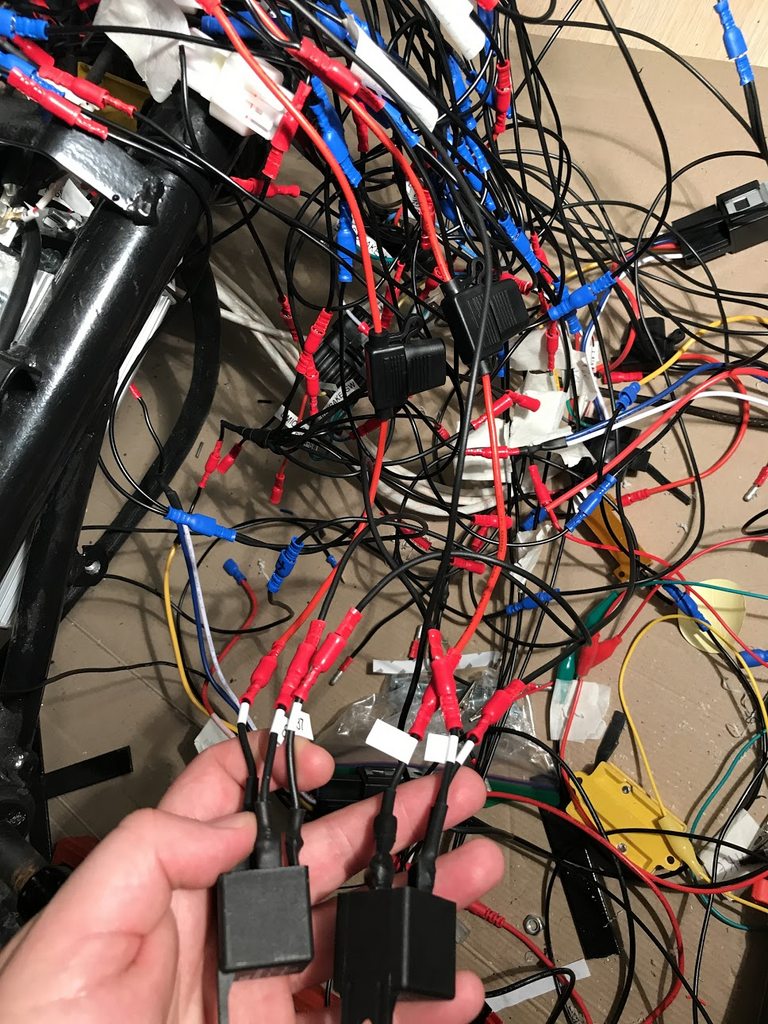

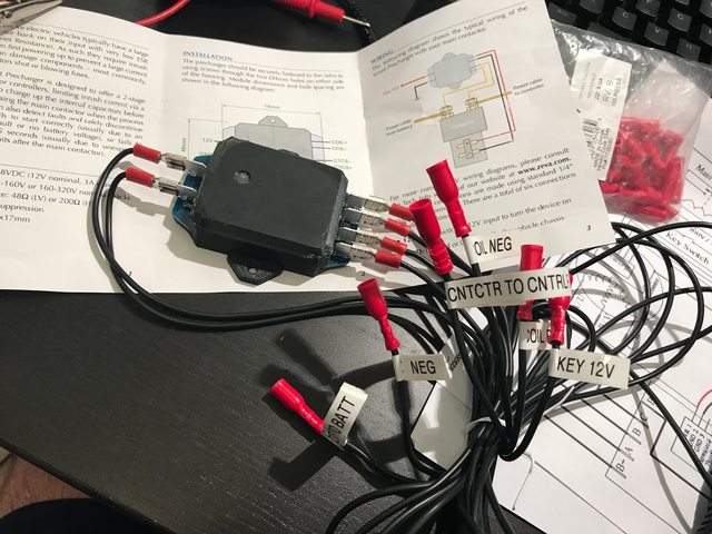

Lots of bullet connectors and labelling. I'm hoping to get to a stage where I can "plug and play". Trying to get this as modular and clearly labelled as possible so easy to unplug things and swap out if anything needs replacing etc.

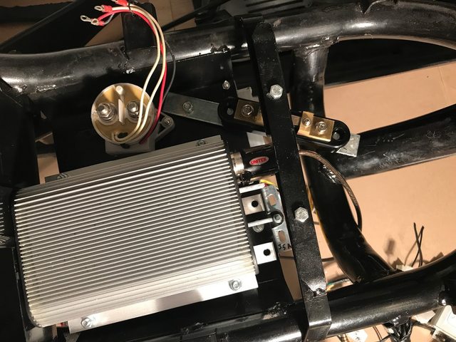

Kelly controller can with only 1 side of deutsch connectors, I didn't want to try and find or spend a fortune on more. Found some 6 pin connectors on amazon, so used them.
Well I got it running just connected the 3 wire throttle, smart pre-charger and two 12v dc-to-dc converters. I'm getting some errors.
CA doesn't seem to measure correct max amps. Its showing 220amps or so and my battery max can output 85a, I guess the only real way to find out is measure with ammeter?
Smart pre-charger works fine, but if I turn key off then back on, I get red light. I measure voltage across B+ and B- and controller is getting about 1.5v when smart precharger has red light (error state). I turn key off, then back on, I get green light and precharger works. I hear contactor let voltage through. I have both 12v dc converters wired in before the main contactor. One supplies 12v key switch power to smart pre-charger.
http://www.zeva.com.au/Products/datasheets/SmartPrechargerV1-3.pdf
I had an issue where the CA was measuring the 12v since it was connected to PWR 1 from controller which goes to coil of contactor which is 12v (see image). So now I've wired red from CA to main contactor terminal (72v) and it measures voltage correctly. Perhaps this is contributing to the over voltage error?

Throttle error at power-up
My setting for throttle has 3 wires, 1 black, 1 red, 1 green.
red is connected to (7) - 5v output
green is connected to (5) throttle
black is connected to (2) GND
(from manual pdf)
http://kellycontroller.com/mot/downloads/KellyKEBUserManual.pdf
In programming is 1-4v, with 20% starting 80% ending
low threshold 1%
high threshold 98%

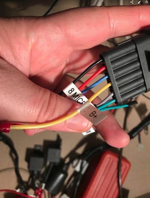

According to pdf manual I need to connect (8) Micro SW, but when I connect to black wire of throttle it doesn't work?
I have not connected e-brakes yet.

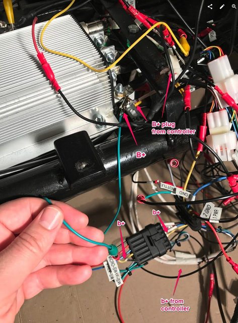

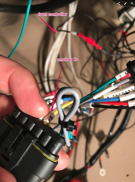

There are 2 extra B+ plugs that I've connected that are not mentioned in the manual- see photos

- Figured out the shunt and amps reading for CA. I won't know real readings until I test ride it (put under real load)

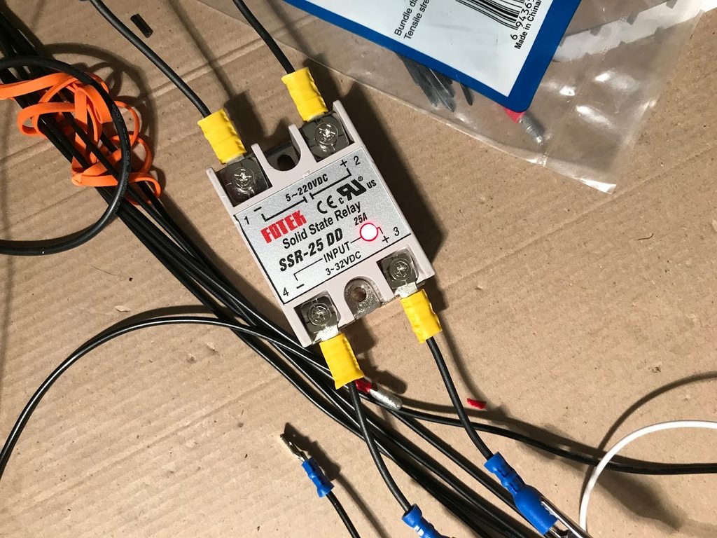

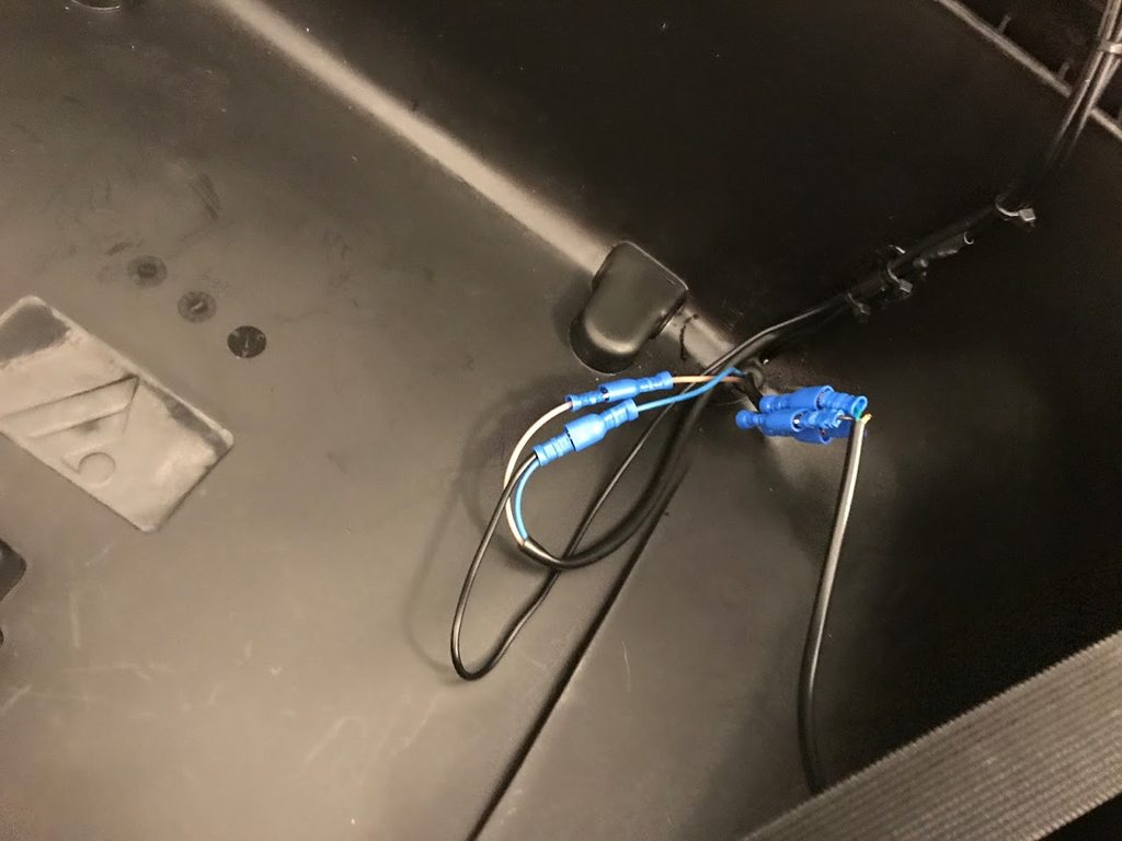

- I thought I needed a solid state relay in order to activate the 12v brake lights without disturbing the circuit for KellyController e-brake. It wasn't working as expected and the SS relay was heating up, I think somehow the circuits were getting crossed. I used a normal 12v relay and it worked perfectly. E-brake cut off power to the motor and engaged the 12v brake lights

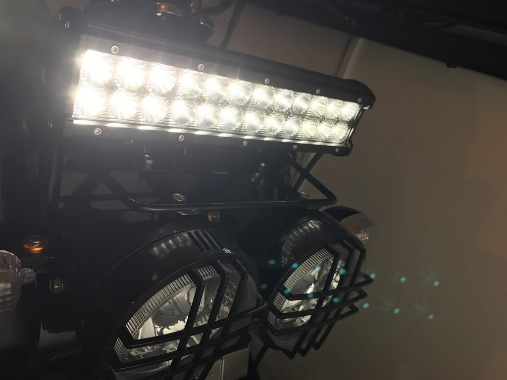

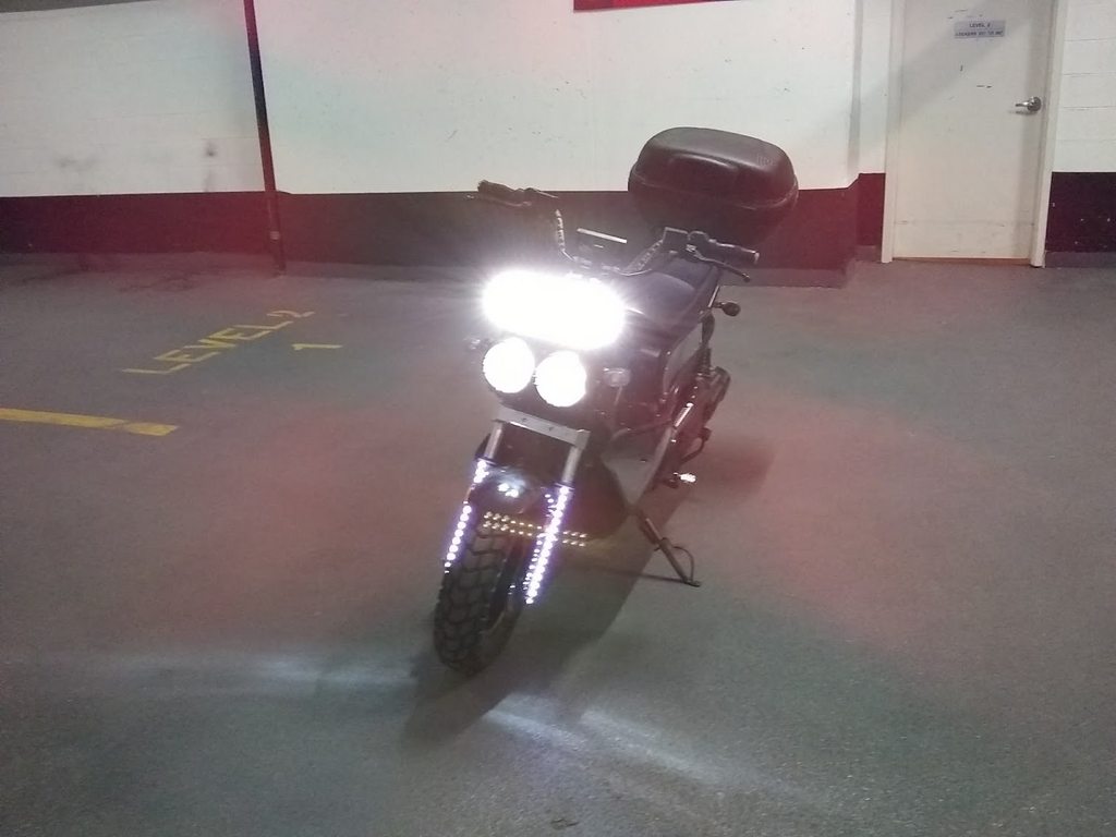

Lights

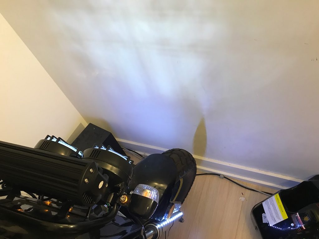

- 2 front LED headlights with LED parker bulbs- this will enable just 'visibility mode' with very low brighness LED's if i have to pass by pedestrians slowly as to not blind them + 2 LED white lighting strips for front.
- High and low beam switch and wiring for the to main headlights
- huge LED bar super bright power mode

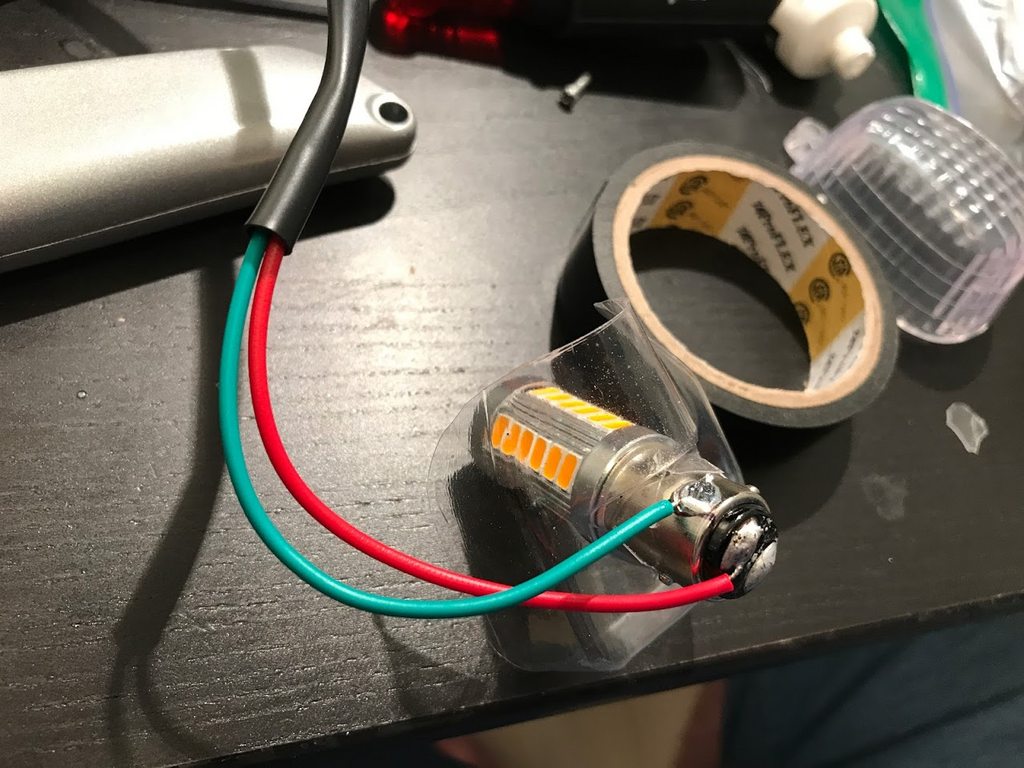

- LED signals - 2 front and 2 rear main bulbs I upgrade to LED with some custom plastic and foil reflectors.
- 2 LED signal amber strips on handle bars

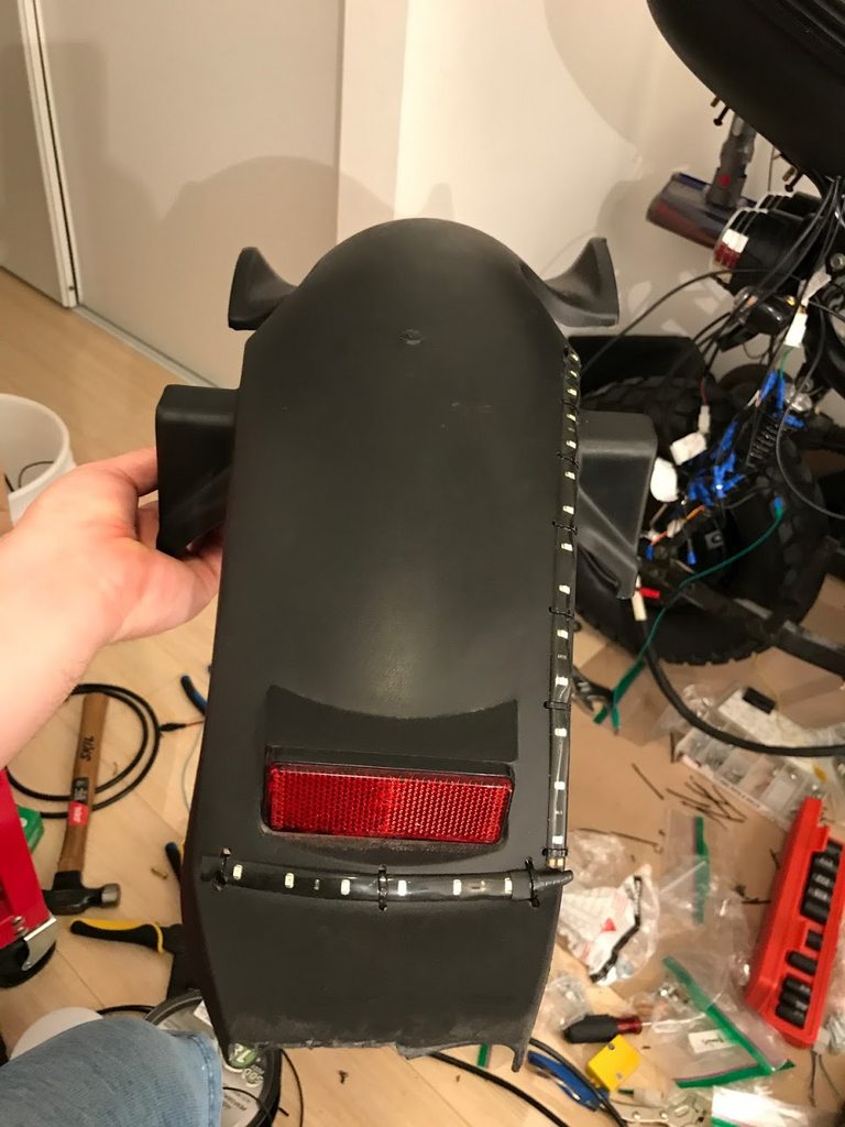

- REAR trunk installed with LED running and brake lights. Custom wiring and LED signal strips on side of case. Had to adjust trunk further back to accommodate 2nd passenger.

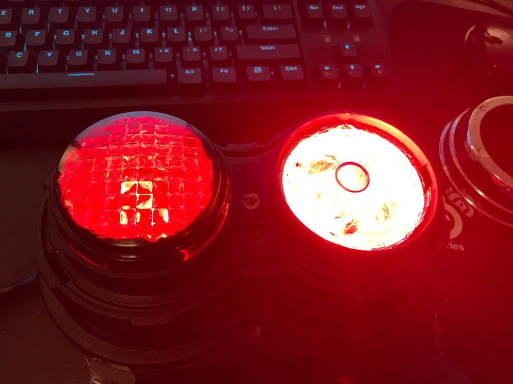

- Rear LED main tail lights / brake lights with foil (unfortunately the black filter cuts down a lot of the brightness
- Rear LED strip (running, brake and signal LED)
- Rear fender added running and brake LEDs
basically the bike will be seen no mater what

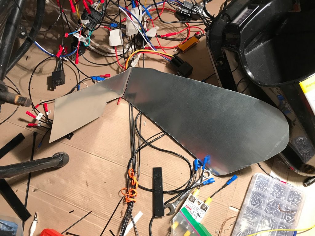

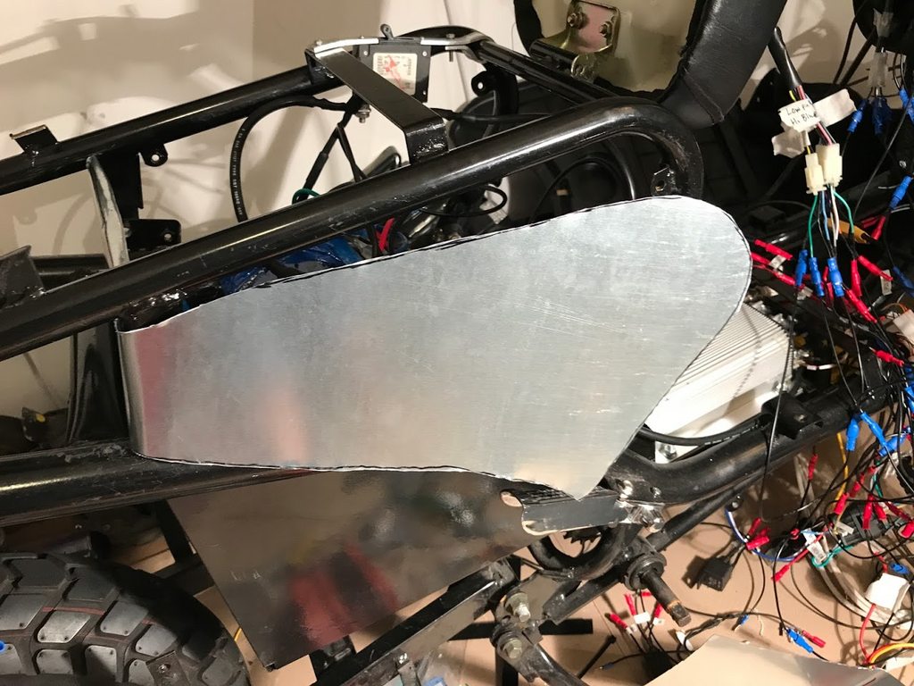

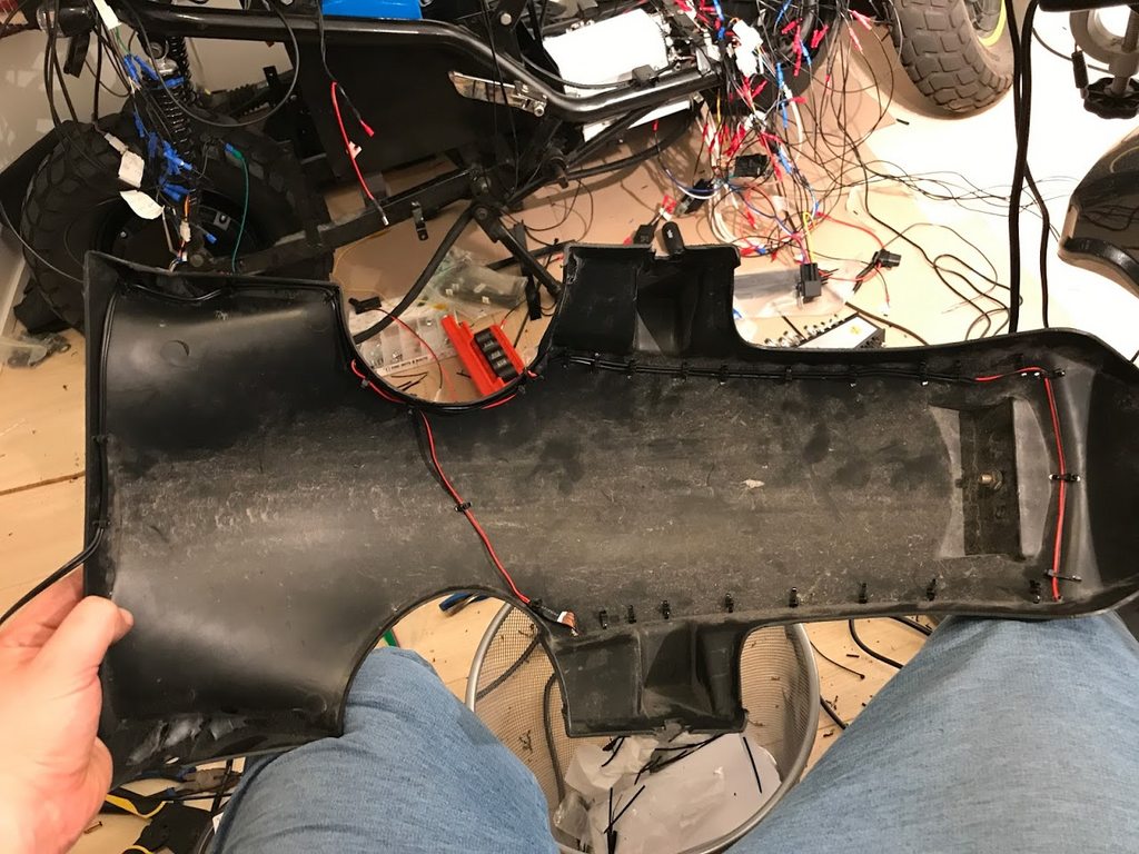

Panelling

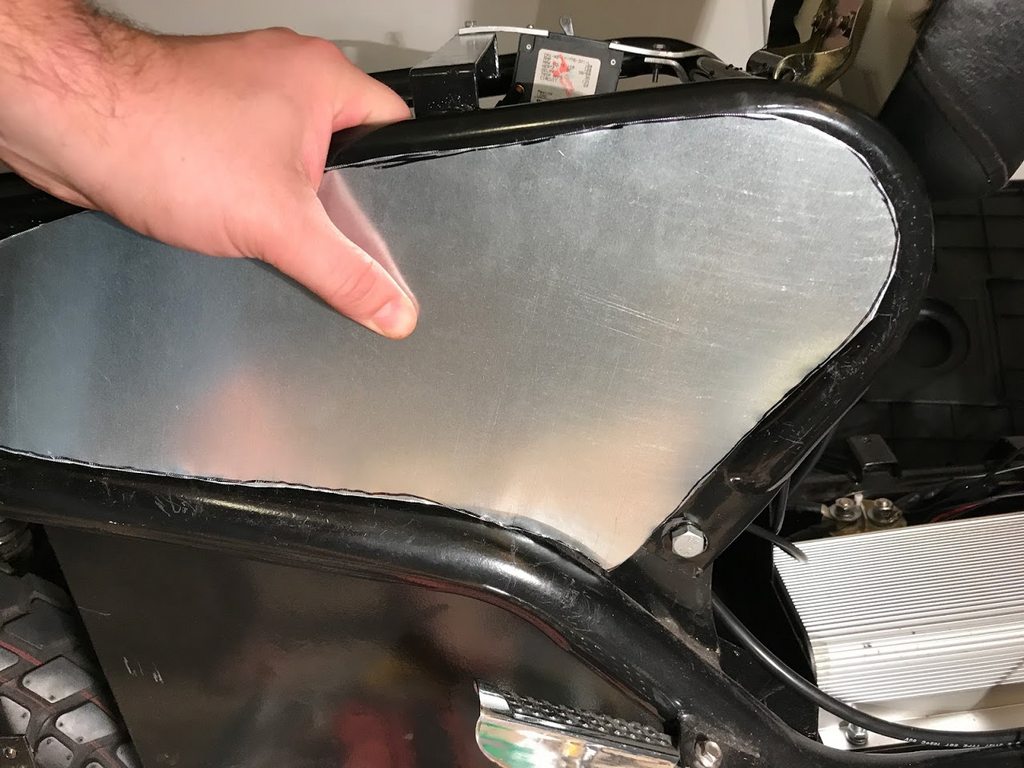

- Side paneling I used thin TIN which was very tricky and I don't think I'd to again. Its very sharp and cumbersome to work with. I'm still missing some for the front of the battery compartment. I will have to get another piece and some plastic to connect it to the flooring.
- As you can see with the tin its quite rough, but it was very ad-hoc. I just really want to finish this bike.
- There was a gap but someone could fiddle around with the seat locking mechanism, so I blocked it of with some spare plastic panelling I had, had to use the heat gun to bend and shape it then bolted some parts together.

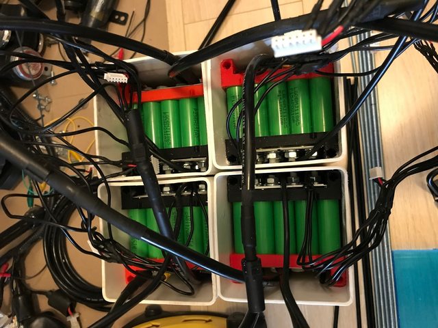

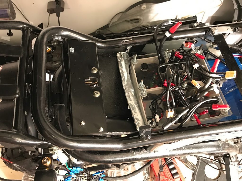

- The main battery compartment holds both batteries snugly

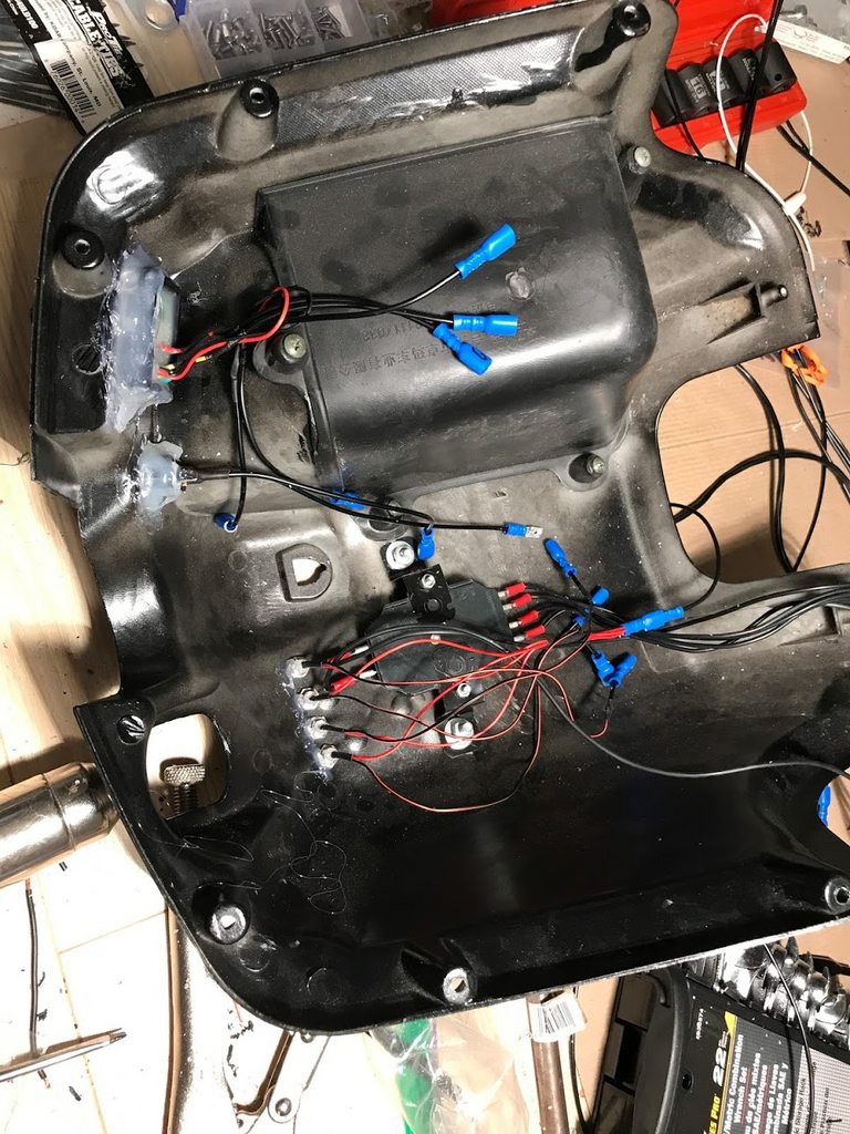

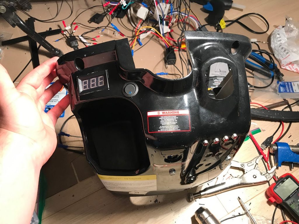

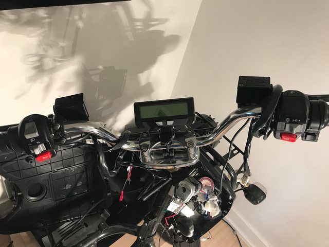

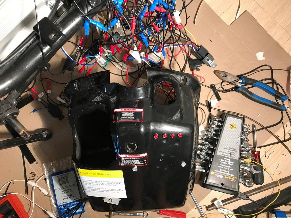

Dashboard

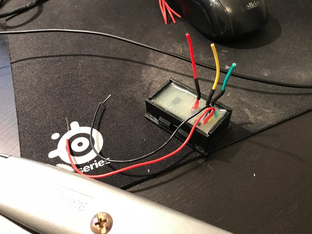

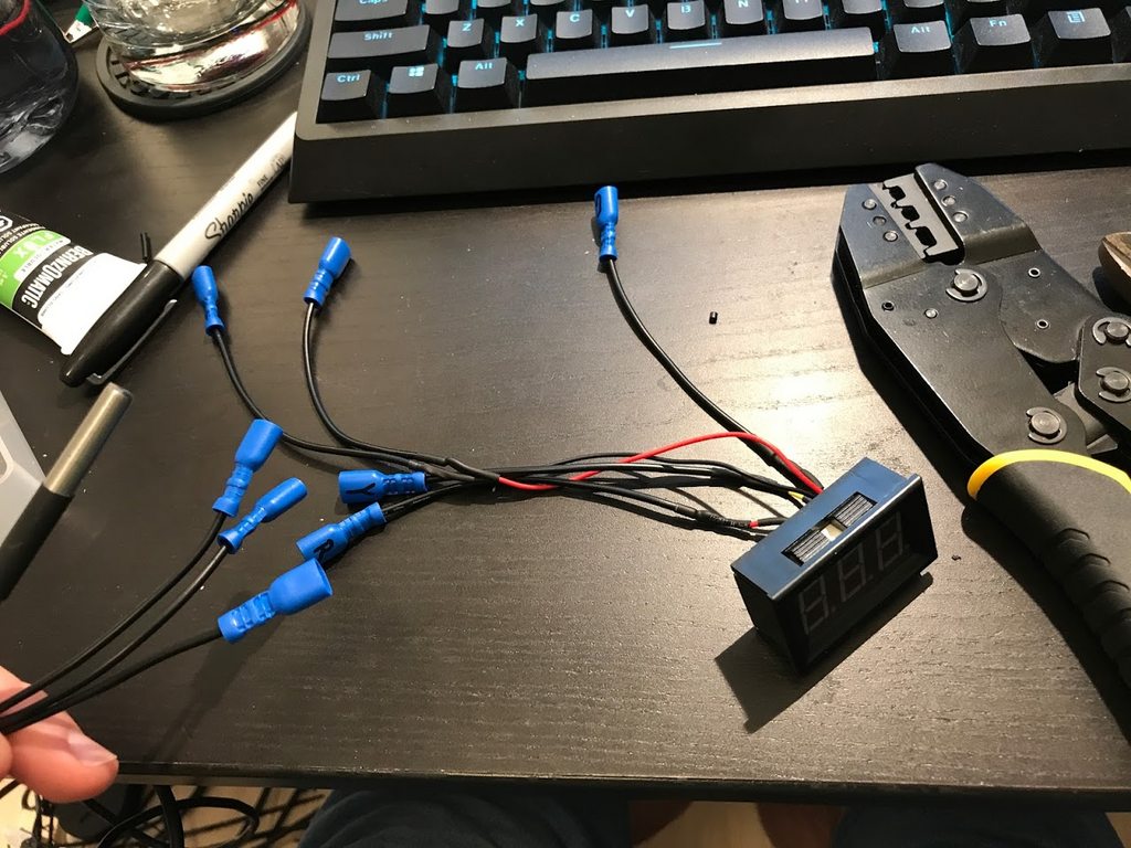

- I hooked up 4 indicator LED lights for the modular battery. Each one will come on as well as an audible alarm (which wont be heard from battery compartment) but each light will come on when each stack goes below 3.0v or when difference between the cells in each stack is greater than 100mV. Unfortunately I will still need to manually calculate the mV difference between highest and lowest mV between the stacks. I wonder if a solution to this could just be 1 extra cell-logger connected to each of the 4 stacks, it would just be looking at the average between all of them though. We will see
- LED temp sensor with switch. This might sound silly but I'm going to mount this right next to the hub motor so I can measure the temperature of the air near the hub. I didn't want to open up the motor and install one inside. I know that this wont really give me a very accurate reading, but I think its better than nothing. I think probably the air passing by might mess with the readout, I would just pull over and check the numbers to see. I tested by putting it next to my soldering iron and there was quite a noticeable difference

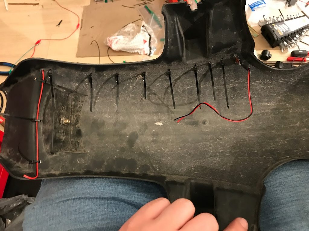

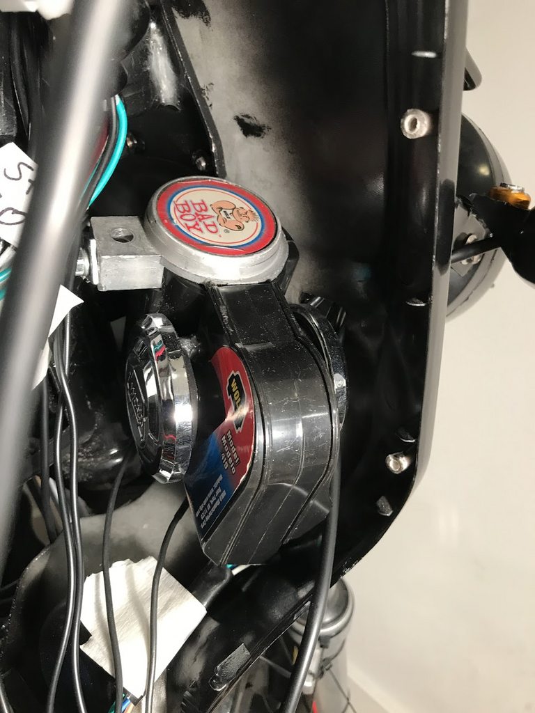

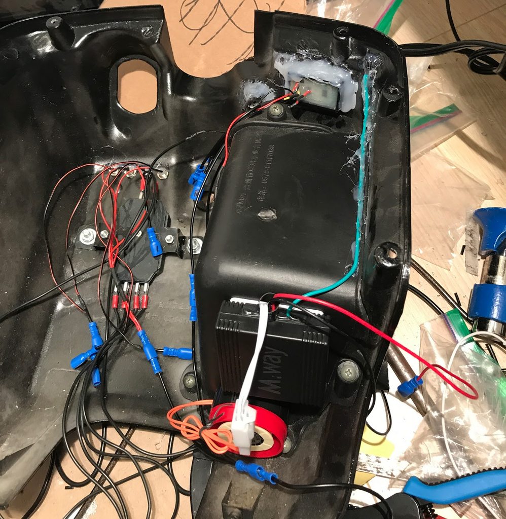

- installed the alarm inside the dashboard part, some hot glue for the antenna so its up high (apparently getting it clear of other wires helps as well) this thing is LOUD
- wired up the double air horns, low tone underneath, high tone inside dashboard bit. They are hooked up to the 35amp dc converter. Each has its own relay and 20a fuse. I tell you what it sounds like a TRAIN !!!
http://wolo-mfg.com/horns/motorcycle-horns/air-horn/model-419-bad-boy.html
http://wolo-mfg.com/horns/air-horns/model-619-big-bad-max.html

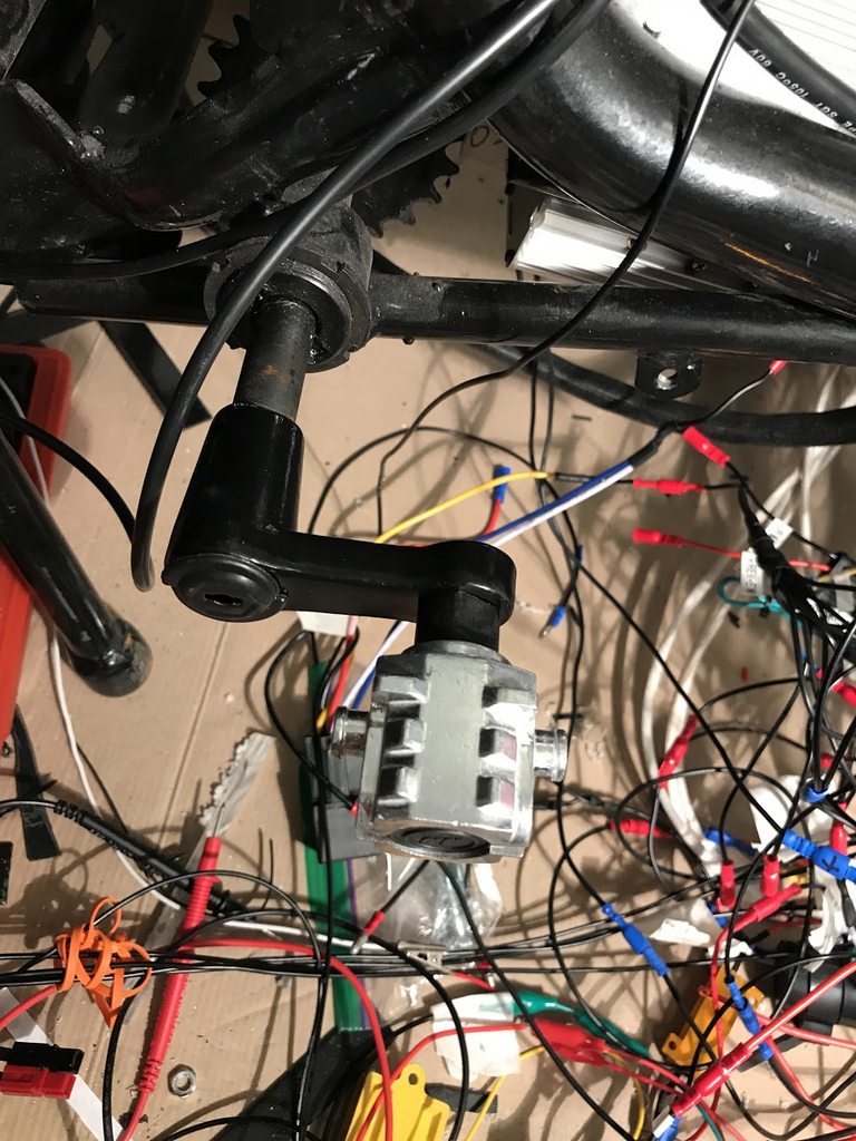

- installed these tiny pedals with mini crank arms (legal reasons)

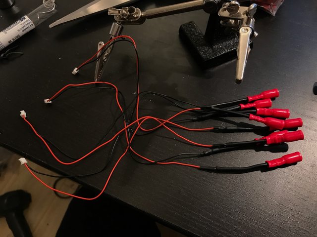

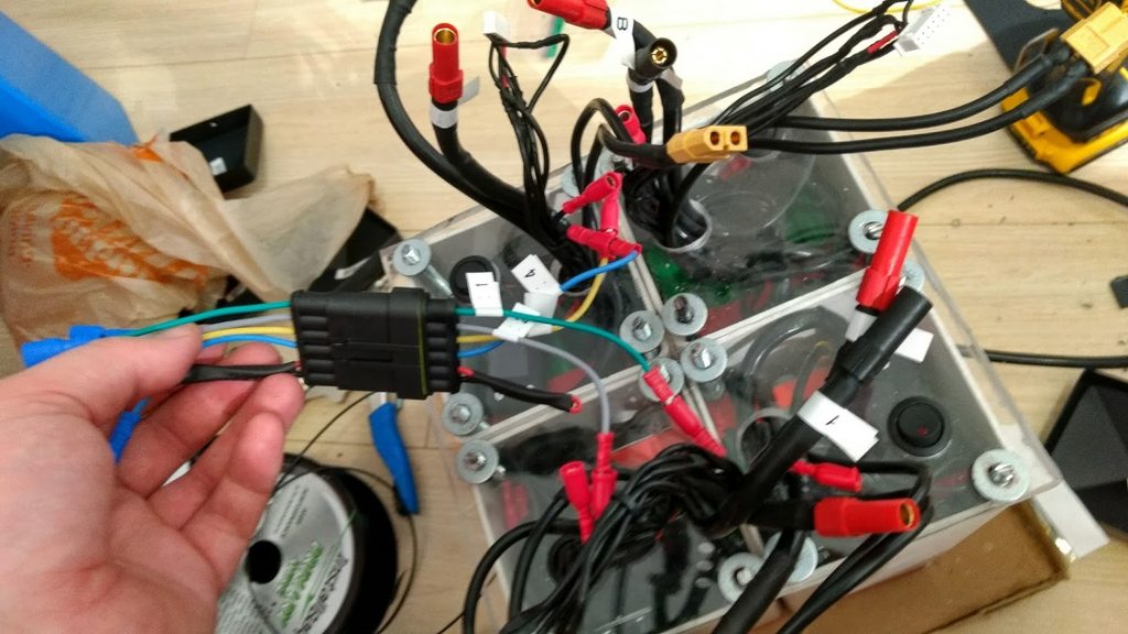

Hooked up a main plug for the alarm outputs to dashboard and labelled each cell stack
3.5v low voltage
4.1v high voltage
100mv cell difference

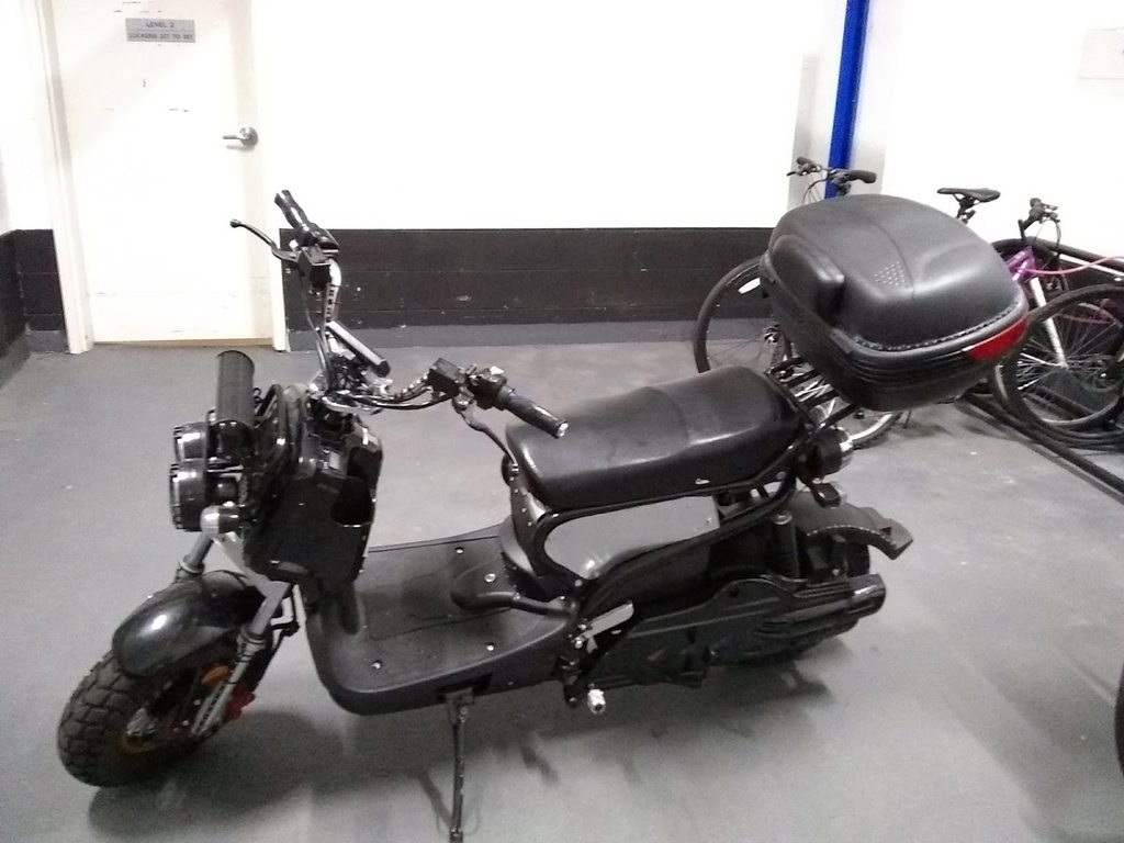

Sorry for the late update- I have pretty much finished this bike about 1 month ago. Still need to add some paint to the side metal panels and re-position the revers switch (so my keys dont bang against it)
For some reason the modular dash battery lights and temp sensor near the wheel have shat themselves so they need replacing also
I had some issues with programming the kelly controller- what settings to use etc to get correct speed and also if it was giving me the correct amps peak and cont.
Performance is different- take off is a bit slower than my high torque lighter ebike but thats to be expected I guess. I have changed the kelly programming so it does 100amp peak (motor says its rated for 90amp peak or 7kw). I really wonder if my CA is giving me correct reading..I've contacted GRIN and they have told me the settings to use for the shunt I have.
So back to the performance, the power REALLY kicks in at about 40km/hr upwards "once I'm going", I haven't got a top speed yet cause its kinda scary but I think its around 80km/hr
Hydralic disc brakes are soooOOoo much better than the drum brakes on the old ebike project, I actually had a small crash on the old bike because of it- some dickhead cut me off.
Also because of the tread on the tires its quite loud once it gets going, I wondering if I can get some slick tires if it will make any diff.
