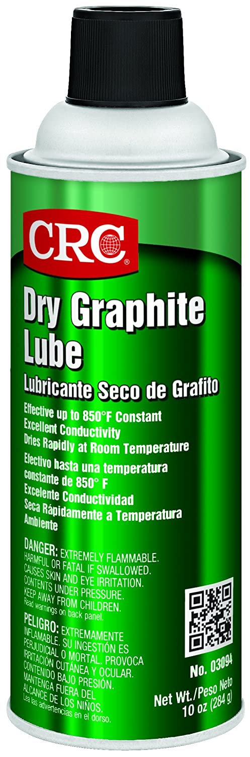

Going to get some graphite into the rollers on the chain. Hopefully reduce the heat and noise some. Also working on figuring out the best way to attatch a coupler to the motor splines.
Ive made this mistake, its only fixed by making both sides sprockets larger in diameter is the way to make your chain more quiet. The link below shows the effect of tooth count vs chain vibration. It looks like you have room to package 2x the number of teeth at least, doing that will knock out most of that vibrational power.
http://chain-guide.com/basics/2-2-1-chordal-action.html
