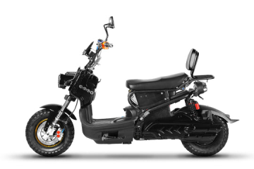

During the winter time, the road conditions here can get pretty tough. I have a Emmo Monster 72v and its regarded as an off-road bike. It does pretty well against snow, but not ice. The goal is so when that time comes ill skid rather than tip over. As of last year every time there was too much ice on the road id take a lyft or uber. It can get pretty costly, so i figured doing something like this would cut costs in the long run.
Here's a link to the bike if you need more info: Monster S - 84V
This one?

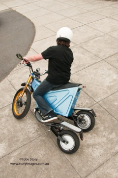

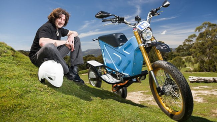

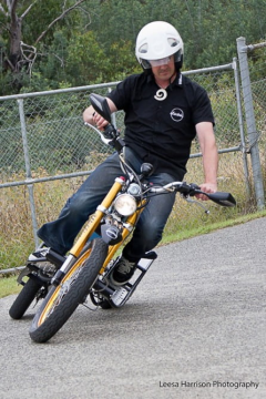

With a delta, unless you can design it as tiltable (see the old M3E thread by carvin marvin / willow for what might be the best fit for your application), you're going to be limited to a pretty low speed to avoid crashing during non-straigtht maneuvers. HOw fast depends on the wheelbase, width, ride height, CoG, and traction to the ground, etc. Many delta anythings are stuck down around 10-15mph at best, because of stuff like this.
Similar problems can happen with tadpoles too, but the conditions are usually different.
This is that tilter:
Here's a few threads that *might* have useful info about tilting stuff (most probably aren't relevant)
AW... with all do respect, I would avoid a tilter configuration - for the very same reason(s) I'd discourage any single track (scooter, bicycle, motorcycle, ect)... a hazardous choice on slippery riding surfaces WO/studded tires. You'll still be laterally loading the tire's contact patches (a requirement to remain upright and balanced on nearly any rig that tilts).

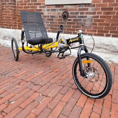

Considering cost, this would be my recommendation instead of an unknown conversion attempt...
There's lots of threads about tilting trikes on here. It's extremely unlikely that you find a conversion kit for this kind of vehicle though.
