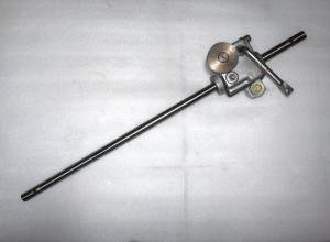

Might have just figured my newest "best" way to mod the large trikes (Schwinn etc.) into electric assist mobility vehicles.
My1016z3 24V 350w gear reduction motor + spoke mount sprocket. (485w@33.3V ... 525w@36V etc.)
9 - 32 gearing provide a stable torquey 10mph.
Motor = [strike]$69[/strike] - $52
Sprocket kit = $18
24 - 36V controller = $12
Thumb throttle = $10 -15 (thumb throttle recommended due to Trike handling characteristics)
~ $100 ! ... (Battery, chain and mounting hardware extra).
Ideal item for the Schwinn Meridian Trike.
Apply to non pedal driven rear wheel for assist, better traction and motor supplied deceleration.
One for each rear wheel! ... for hills, loads and hefties?

Received 31T spoke mount sprocket.
Gaskets are very heavy duty. 1/4"+ with multiple cord layers.
Most of these sprockets are for #415 chain, guess I lucked out, under 1/8", perfect for #410 chain.
Looks to be a simple easy install.
Only point for concern is precision centering. Important for smooth operation!
Will post up install method w/pictures ...
Preliminary motor mount will likely be of wooden construction ... mounting to aluminum frame.
Building for 10mph capability as mobility device. Solid sprocket, no freewheel.
