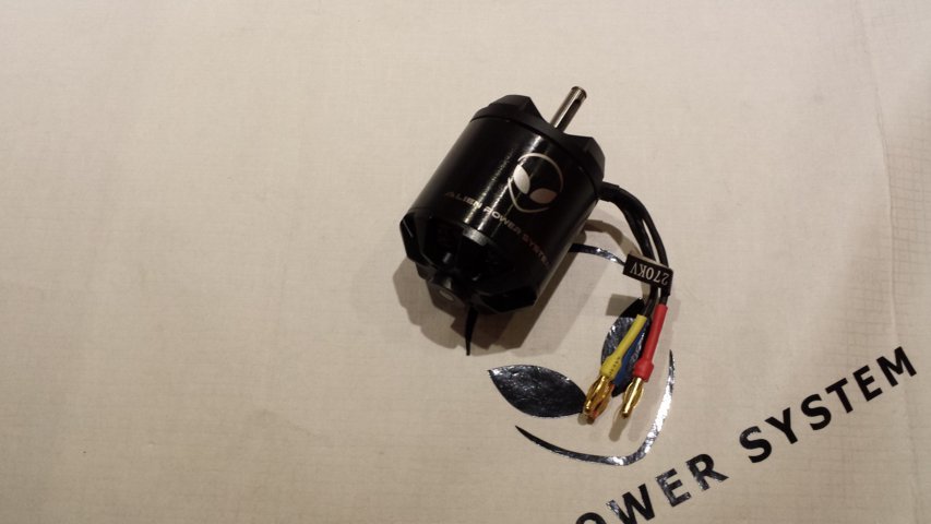

I did a quick test this morning. I did a cruise with 60% break and medium acceleration. Everything was fine. I don't brake often, as I carve a lot to reduce my speed. The medium acceleration is really the best setting, gives you good torque if you have a good weight placement on the board, with 78A... that's a rocket but still way manageable.
At the middle of the ride, I when I was starting to accelerate from stop (I don't push full power on the wii nunchuck as I am confortable with throttle management), I have the rear motor that brakes by itself, I tried a few times but I stopped as it is dangerous, sometimes i can brake after 5 seconds of acceleration... well I came back home and did a short video. Just focus on the sound of the rear motor (at 0:8 seconds), you hear scratches, and on the way back it happens all the time as if the motor was damaged. I cannot get a consistant pull when pressing throttle. At this time I don't know if it comes from ESC, Motor or Wii Nunchuck (I initialised it correctly I think, when I press throttle, both motors run at the same time, but well maybe I'm missing something).
Timing : 20° - 8kHZ - timing monitor off - medium acceleration - 60% brake.
[youtube]mX96BpZf0Ow[/youtube]
Any thoughts on what that could be ? At the moment, I can't ride it anymore.
Thanks,
Check your motor wire connections. Sometimes wires can fray or come loose allowing the motor to phase out.
I have to admit that this setup is a dragster, but a real one. Believe me. always wear helmet. I have tried to push it to its limits after fixing the motor wires.. well limits were mine. I was like 40pmh (I assume) and I got stopped (by I don't know what, maybe too much watts or motor wires 3.5 that cannot handle that... dunno), it's like you hit a little rock and block. boom. Well don't have the words for that, but after being blocked I was literally flying over the ground... felt 4 meters after like superman. Well, pain is here, but as I have been skateboarding for +15years I am used to fall... but well falling at 40mph (when you don't expect it! )is like... you don't want to know :D

One thing it may have been is the ESC hard cutting due to the battery voltage dropping..not necessarily low but due to the high current load it reads as being low..So as your leaning forward to counter the acceleration..when the power cuts your weight is thrown forward I've had this a few times and i personally would drop it back to soft accel on ESC.. its more than fast enough..and it may be a an issue for the current drain..
thanks for the feedback ! I am quite sure it's not due to battery voltage drop as I when I came back I only put 2000 maH to charge/balance it.

I went back this morning to the spot where I had the accident; there was no little piece of rock. So I assume it comes from the electronics as I was stopped immediately and I was continuing to accelerate. On my side, the problem is not the speed fear, but more the fact that if the motors block or the ESC fails for whatever reason, I'm in danger!
well sometimes the esc limit kicks in when too much current is drawn..even if the battery is not low..
well i agree ..the fear is in the failure of a part.. that's why they must be given respect - please remember at the end of the day your basically standing on a RC car which was not intended to carry a person along..so there is a limit to what can be achieved,...and each board needs testing extensively before high speeds are achieved..as they are but by yourself and errors ,problems can occur
i think the few mods may make a difference..i would drop the ESC setting to soft also..
please let me know who you get on..
yes, would be great if Bruno could put the ESC in fail open mode, I mean when it's overloaded for what ever reason... it just let everything rolling normally without activating any break function. I have checked my eagletree and I have not been more than 125A maximum, so this is weird.

What happened is that I got suddenly stopped at like 30mph. What is weird is if there is too much power on the ESC... motors just need to go fail open which keep me rolling... otherwise maybe my motor wires are the problem (I have not changed them motor side, dunno which size is it look picture)
