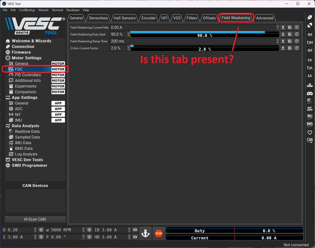

Is field weakening feature can be enabled in this controller (out of the box - without flashing new FW)?

I dont think so but I just updated the firmware. It only takes like 3 or 4 clicks and a couple of minutes. Its essentially the easiest part of using VESC.

How about after the firmware update? Is the field weakening accessible?
If you connecting your controller to VESC TOOL on your PC I'll appreciate if you can take a look and let me know :p

It is. I haven't tried messing with it yet. One of the many features to explore in the future. As far as I know with the 75100 and 75200 the only thing you cannot use is phase filtering. According to flipsky you must disable it or you may damage your controller.
