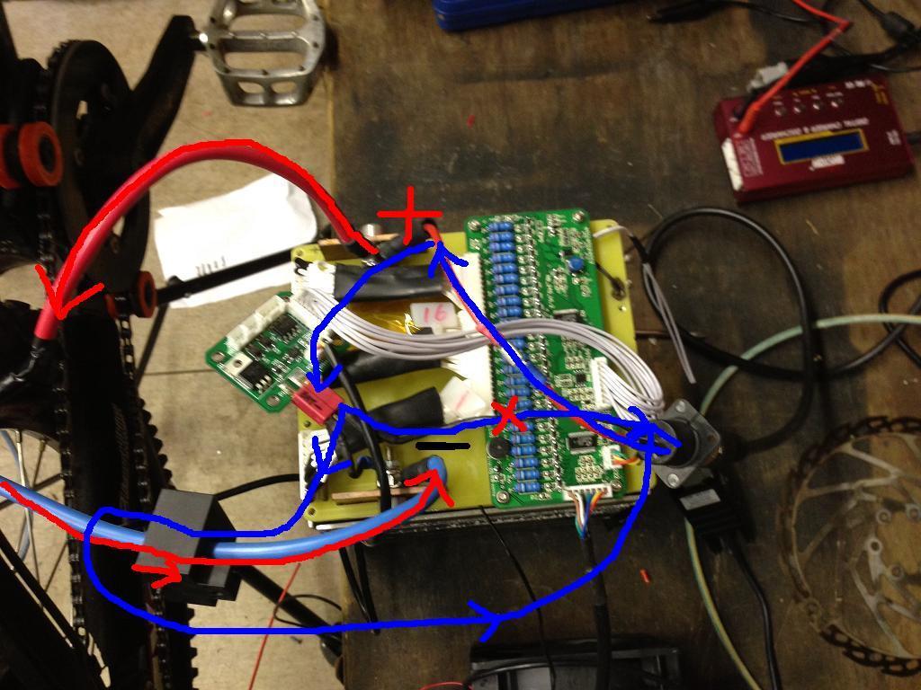

Think I may have the answer to what I done wrong but ill save it till I proved I'm an idiot (not electrically minded).
I have received your photos and found the problem of connection.
Please look at the pic I sent you!
There are must be 2 wires through the hall sensor.
Discharging current will be follow the arrow through it and charging current will be reverse the arrow through it.
So when discharging,there will be a +A and pc shows "discharging".
When charging,there will a -A and pc shows "charging".
Tonight I have tried all combinations ie positive wires through the hall sensor and reversed the hall sensor / negative wires thought the hall sensor and then reverse the hall sensor and still no charging.
The battery is discharged down to 50%.
The most I got was at one point with the charger on it was reading discharging and that is what it was doing.
Red is discharging.
Blue is charging.
