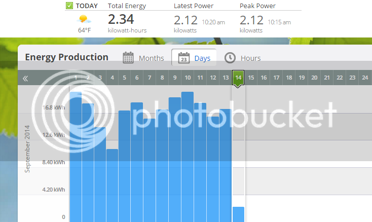

second full day of solar good for 38.7kWh, 6 of 42 250W panels not yet sending data:

Wow! 42 x 250W panels! You must use a lot of electricity. I'm getting by with 13 x 275W ones. My system is putting out ~20 Ah on a good day, which is my average use per day, year round. Looks like I will be running a bit short in the winter though. I probably shouldn't have switched to electric hot water, but I couldn't resist. We'll see how it goes. I might add a couple more panels or maybe add a cheap low volume tankless gas pre-heater for the big electric water heater.

I'm curious how many kWh your 42 panels are putting out. My 13 275W panels are giving me an average of 18 kWh a day, which is about 2 or 3 more than I use. That should be enough savings to get me through our very mild winters. I really don't want to end up with a surplus at the end of the year as my utility co. only pays back $.04 kWh even though they charge for tier 1 pricing (under 400 kWh/month) .17 kWh. It goes way up from there.
