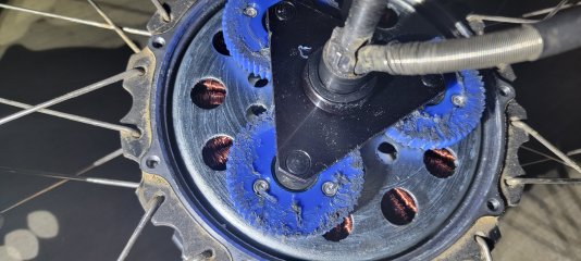

I see. Here is a pic of the sheared gears. On the closest gear, it looks like only one side of the gear failed which I think was caused by a sudden force. The other two gears have a similar smooth spot. I don't know much about heat deformation but I assume it would be somewhat gradual and experienced by all the gear teeth equally. If this is the case, is it reasonable to assume all teeth would have some degree of deformation?

that's very strange. There is probably some portion of the rotation where the gears got overtorqued. It looks like some of them want to become nubs. I wonder if that's possible because they slipped or were overtorqued for a moment.

Well, once teeth shear off preventing contact with the other gears that turn the planets (sun and ring), the gear can't spin anymore. The sun has less teeth engaging the planet vs the ring, so there are fewer teeth involved in any torque transfer in or out of the motor core than at the hub shell. Once the teeth that can engage the sun have sheared off, and the rest of them that engage the ring can't be pushed far enough to engage the sun by the remaining teeth engaging the ring, there won't be any further tooth destruction. ;)
How quickly or slowly the damaged occured I couldn't say by the image; there are probably plastics experts in failure analysis labs / etc that could.
The heat doesnt have to cause deformation. It only has to change the hardness of the plastic during operation so that the torque can do the damage.
It doesn't have to be much change if the torque is already anywhere near the limit of the plastic's capability anyway, and a sudden change in torque (from the sudden engagement as the wheel hits the ground) makes that worse.
I don't know what specific plastic is used in those gears, so I don't know what temperature range begins to affect it this way, so I don't know if this was a factor at all or not--but it usually is.
Typically, traction heats the motor relatively continuously during operation, and torque generally is generated relativley continuously, applying forces to the gears relatively evenly.
Tyipcally, braking heats it mostly in pulses, and the torque is typically applied in pulses. Braking heat can be higher than traction heat, but usually it averages out the same. Long descents using the motor as a continuous brake can cause more heating than using it for traction, depending on how much braking current and how braking is performed within the controller itself (there are at least several ways). When the braking is interrupted the way you suspect, the heating still applies but the torque pulses (at impact ) also exist.
BTW, I don't think Grin provides them, but you could have brass gears made to replace the plastic ones. The motor will probably be a LOT noiser, probably sounding like a meat grinder on high ;) but it won't fail from heat issues. You could still strip teeth off with excessive torque, but it would take a lot more and it'd probably shear whatever key secures the sun gear to the motor output first.

Some of the stripped nylon gears I've seen (and caused) from shock loads (i.e. abrupt resumption of wheel traction) had only a single planetary gear stripped, with negligible damage to the other two planetary gears.
You'd think they'd all be equally engaged with the sun gear, but fact remains that it seems common to lose five, ten, fifteen teeth on a single planetary gear.
Hard to tell what the damage is without you cleaning off the grease, but looks to me like heat might've been a factor.
