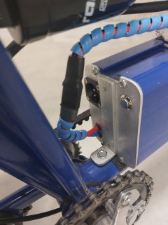

The electric part took longer than expected: while the battery was no real issue since I designed the frame to clamp it down, the vesc controller proved more of a challenge. Like many here know, the key problem is the display. You can write a custom lispBM script to communicate with almost all chinese ebike displays available, but those are often sluggish and don't show the information you need. So again I started from scratch and programmed my own display. Luckily there are plenty of knob style displays available nowadays with decent screens so I picked the best amoled with a reasonable size and coded an lvgl based gui: looks good and is very reactive. Also, it allows for CANbus or uart communication which might come in handy, and since it packs an esp32s3, future possibilites include OTA and remote control of the vesc.

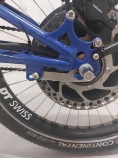

And last but not least, one might wonder where that funky motor comes from. It took me a while, but I found a chinese manufacturer that still makes Direct Drive hubs with integrated geared hub. Getting a sample proved near impossible, so I looked for a used sparta r5te bicycle and found one in the netherlands. Had to convince the owner to send the motor only via international shipping all the way here but it worked and I finally had my motor. Than I realized there were no halls and the stock cable was garbage. So I opened up the beast - which helped confirming it had 34 Poles - added 3 halls, a temp sensor and soldered a L1910 cable, before lacing it again into a 20" rim. And look, now it's working!

I like the battery box; is the charger integrated?

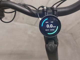

Clever display/control interface; is it waterproof? I assume it's like some of the ones i've seen here and there that you rotate the outer edge for changing input, push down for "select" (either the whole surface or just one spot on the edge like a cursor pad), etc.?

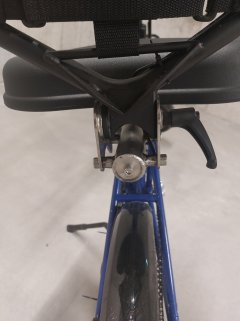

I see the headlight and taillight--does the tail do brake light duty as well? Are there turn signals?
One thought about the taillight: In my experience, having the light as close to driver eye level (for following traffic), or at least the level of the average vehicle rear lighting, makes it more certain they pay attention to it. As large a surface area as possible helps them react more quickly as it makes you appear closer, and/or larger, both of which put you into the category of "things to pay attention to now and not dismiss" for the purely reactive brain used for such things. Brightness isn't nearly as important as size, for this.
The latter applies to the headlight also, for people coming out of driveways, etc., to make them pause longer as you approach instead of dismissing you as too far away or too small to worry about, and just going anyway even though you are actually right there. :/ But the taillight size and placement is more important.
Nope, Rosenberger ropd charge socket. There is plenty of space left inside though despite the 104 cells, since the orginal plan was to put the controller inside the battery box. Than during the countless tweaks on the vesc it became tedious to re open the box, so I bolted the controller onto the battery box top rail. Not as clean, but easier access. Both battery and controller box are siliconed, so ip67.
Display is nowhere near waterproof. It's ip55 at best, but the pcb could easily be potted and the amoled is casted, so ip67. So far rainy test runs worked but I suspect in heavy rainfall the encoder might behave strangely.
Turn signal can be mounted on the seat though after seeing how quickly they get ripped off on a van raam, I went without. There is a spare wire left for brake duty, but I did not solder a second LED in the taillight yet.
True. I only have two cross bars on the seat to mount the backlight; the upper one is better for visibility, but in my experience it's also one of the best "handle" to grab the bike which would break the led - hence the lower mounting. It's still a whopping 30cm higher than on conventional 28" bikes! I think the best solution is a led on the back of your helmet!

One teeny question, isn't the front light really low to the ground and potentially covered by luggage on the rack? I'd worry about it not being visible enough. I personally would move it up to the handlebars. Maybe that's just my paranoid brain though.
This bike is basically my dream bike (well, dream bike for solo riding without my kid) The amount of TLC in the build is just incredible.
Where I live, blending leds from cyclist and motorcyclist are a real issue, hence the front led placement. Also it's well protected there so no risk of accidentally breaking or ripping it off. I also basically rebuilt the light using a quality cree led and most importantly a dc power module with adjustable output, so I can tweak manually the luminosity, it can go all the way to 360lm but I don't need it. The cable is a simple 3 wire one with +, - and backlight so you can easily swap it with a longer one and place the frontlight on the handlebar or where ever you want.

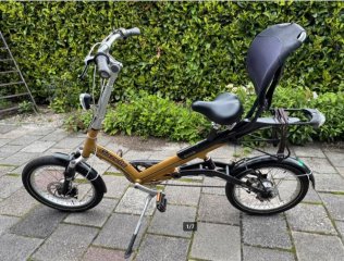

Nice bike build. Looks somewhat like the Gazelle Easy Glider I have.
How do you like it ? It's actually one of the rides I considered, but there where too many issues, starting with the awkward riding position somewhere between a semi and an upright bike. If it had been easier to properly motorized and add a front rack, it would have saved me a lot of troubles !

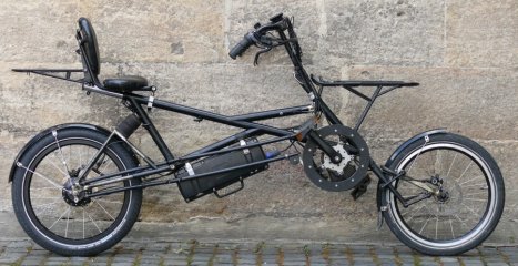

This niche bike in germany was one of my inspiration source as well: atl-Modelle | Alltagslieger von Radnabel
Tried it and found the riding position much better, though the lack of backrest was a problem.

I am especially interested in the vesc compatible display, are you open sourcing the code?
This whole project is a beautiful display of craftsmanship and engineering!
Depends: I'm trying to find partners to commercialize the bike and the display is one of the things I can bring to the table. If it doesn't work out, or if they don't care, I'm going to publish it on github under gpl3 for sure. The matching lisp code is already available on the vesc discord.

The main element I'm still unsure about is the motor: DDs are great but heavy and very inefficient in dense traffic. You need long open lanes at higher speeds to reach optimal rpm, so I'm considering going either geared hub, or mid drive for the next prototype.
Some thoughts: In my limited experience with the GMAC in a 20" wheel, vs a couple of Fusins and an Ezee in 26" wheels, the noise at the higher RPMs the motor has to spin in a smaller wheel can be....annoying. Above a few MPH it got pretty loud, and was, for me, nearly intolerable at 20MPH.****
It gives more torque for less (wasted) power this way, and does so for more of the speed/torque curve, vs a winding of the motor that spins proportionally slower to give the same wheelspeed...but at the cost of more noise the closer you get to the full wheel speed.
This was with a phaserunner, so it wasn't controller noise, just gear noise. Packing the gear area of the case with grease didn't change it significantly; it might make a difference if it was completely grease filled to dampen casing vibrations, but that would also fill the motor with grease; never tested a motor that way, suspect there would be leakage thru the usual places oil also gets out.
There are motors with quieter gears, like the few with helical ones (I think there's a Shengyi like this?) but I have no experience with them.
A DD motor can be quieter but will take more power at startups from a stop, so frequent stop/starts in traffic will take more battery to do the same thing.
A middrive, if running thru a correctly shifted pedal drivetrain, could be quieter, as long as the drive itself is designed that way to start with and not running a teeny tiny motor thru a high reduction noisy geartrain, and some of them also use helical gears that would be quieter.
However...the design of the frame may preclude a number of such drives that fit on the BB; you'd have to check on that.
****but I'm not normal (autistic, among other issues), so many people might not be bothered by it, or not as much so, as I was.
