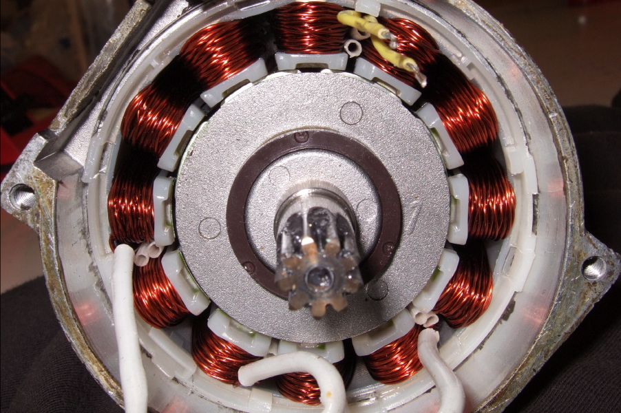

whats the deal with the shaft on these cyclone
Motors with the gear box, I gather they have
A machined gear on them that slips between
The planetary gears on the gear box? I should
Whip the box off the 1200watt cyclone I have here
(not mine) it will need some good grease in it
Before use anyways. I wondered why the box
Couldnt be removed and your own reduction
Setup (belts for the noise nazis maybe?) If
There is a machined gear, spinning the motor
Up and attacking the gear with angle grinder
And grinding disk would be first thing on my mind...
KiM
As boostjuice said and you can see, yep geared shaft. There is a thread about doing that here.
http://endless-sphere.com/forums/viewtopic.php?f=28&t=34421
The shaft is pretty short by the looks of it so the mounting plate would have to be pretty thin. Or one would have to extend the shaft.
I have thought about and at this point it falls in the to hard basket. If someone came up with a "kit" to do it, it might be a hit as the motors seem solid and are available at a reasonable cost.
Clay
Heres what I would do now I have seen it,
break out the Devcon, fill all the gears up
Likely need two hits at this, one to fill the
Bulk of it, one to finish it off and get the shaft
round...
Then once dry spark up the motor, using
Reasonable corse grit sand paper on a hard
Block, remove excess Devcon, reapply more
If needed and repeat sanding process..file
Two flat spots on shaft and fit your own pulley/sprocket...
KiM
@ kim The shaft is pretty short to try and get a sprocket past a mounting plate, but could work.
I am ordering a 12FEt controller from Lyen and the 1200w cyclone form Paco. I'll be getting it with the gearbox.
I am going to run it through my reduction and not the cranks. That will give me 3 speeds for the motor and one for the pedals.
Well see if I get parts before xmas or after. Either way, I'll be ridding again in the new year.
Clay
What is the cost of these motors and how much power can they take? If they will handle say 2-3000 watts, they might be a very viable motor for us MID drive freaks! Anyone know the KV of these motors?
By the way, could you not just make a new shaft for the motor?
The motor only is $145USD. I haven't seen one in person yet, but there are several people on the forum that are knowledgeable about them. I'm not sure what the peak output is either, but the people running them seem happy and get good torque and top end.
There is potential to replace the shaft with a longer one that isn't geared on the end as well. But again, I haven't seen one in real life. boostjuice might know if it is possible.
