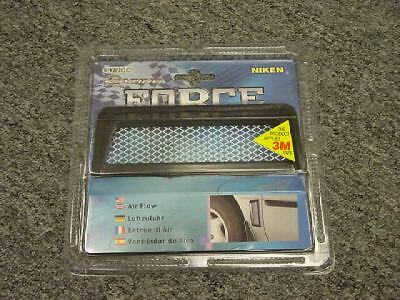

I would experiment blowing air with 1 or 2 pipes coming for the front with 1 or 2 scoops + a PC airfans+ filter (and a switch for freewheel use with for low speeds) to just push the air on the side of the hub cause it is pretty turbulent around the wheel...
@least again it would help freshing if in need of a stop and could cool the controller if in need too
and the best scoop for the end :D
scoops with eyeshots :wink: :wink: :wink:
yep yep :D should arrived maybe this morning :D
