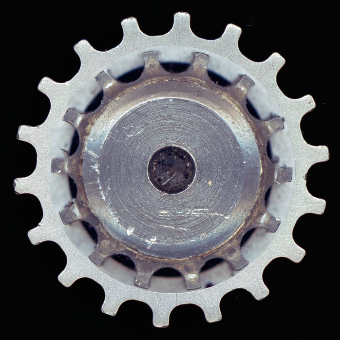

I ordered a fancy schmancy aluminum 18T pulley from SDI just to see what it's finish and profile look like. It just arrived. Here's a 3/4 view:
Just for comparison's sake here is the 14T GNG overlaid on the SDI 18T. Both are at 2X. Note the tooth profiles of each:
I don't know that the drive pulley needs to be this clean and this smooth, but this is the way that I want it.
LR,
Is your new pulley HTD?
The profile looks like GT2 to my weak eyes...
Thud said:
LR,
It was supposed to be HTD5. I'm thinking the same thing myself. The square bottoms look like GT2. I've already written SDI.
Not that running GT2 is a bad idea in any way.

I heard back from SDP about the GT2 pulley they sold me as a HTD. Not the response I was hoping for:
Hello Michael;
It is very difficult to discern the difference between
these profiles. We further stamp the GT on the GT pulleys. I think you got
the right part.
Robbie R.
It's difficult unless you scan the profile at 200%. Then it's pretty frikken easy! Now I have to decide whether to send them the pic again with Gates belt profiles to try to persuade them. Another thing about SDP. The pulley was $8. Their shipping and handling charges were $30! And that was for 3rd Day UPS.
The difference between HTD and GT2:
It will be very interesting to see whether SDP admits their mistake at this point or continues trying to b.s. me.
The good news is HTD belt will run on GT2 tooth profiles....not optomly but not destructivly either....
GT2 belts will not run on HTD pulleys without creating havock.
I like every thng about SDP except the pricing....toothed belts are just expensive in the big picture.
Holy hell! Get a load of this attitude!
These are illustration of belts not pulleys, as I mention GT are stamped
"GT". I cannot recalled having these problems with any previous customers.
:shock:
I can't believe they're going for the "bad customer" defense!
:oops:
I stand corrected...(i knew it was one or the other)
Thanks Miles.
