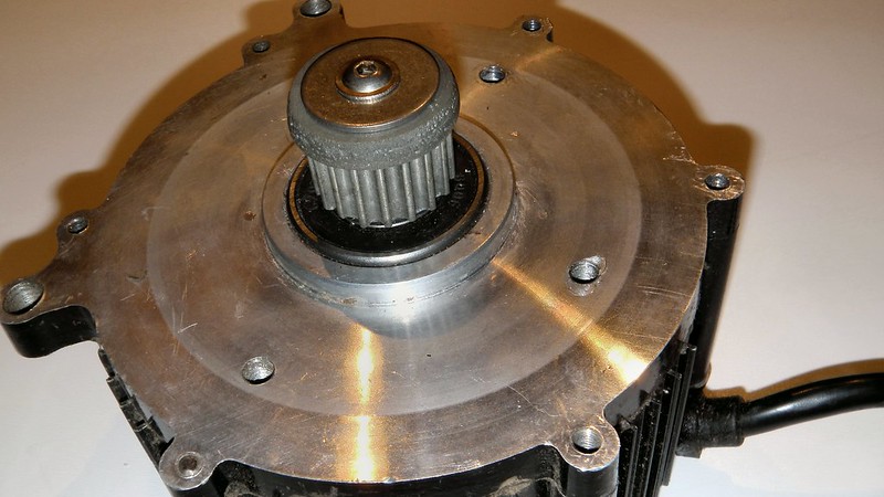

While I am waiting the arrival of some of the LighteningRods side sheets I ordered. I have been working on the drive pulleys. So far, I have managed to mould and resin cast the 14 to 18T slip on adapter, seems ok, and fits snugly on the motor. I tapped a 5mm thread in the motor shaft and fastened an end plate on to retain the adapter.
Now I am making a mould to cast a slip on adapter for the big pulley which will be 107T. This will give a slightly improved ratio compared to the original 80/14 pulleys. Until I can test the casting out under load I am not sure if they will stand up to long term use.
I used a slow cure casting resin with aluminium filler. I hope this will give a hard none brittle cast that can resist wear. The tooth profile has come out well with a nice smooth surface which should help to reduce belt wear, especially when compared to the original GNG belt/pulley setup.
My suspicion is that I will finish up having to go for a primary chain drive mod at some stage. I have all the bits and bobs for the chain drive but until I know the belt & pulley is not going to work I don’t want to file off the motor shaft.

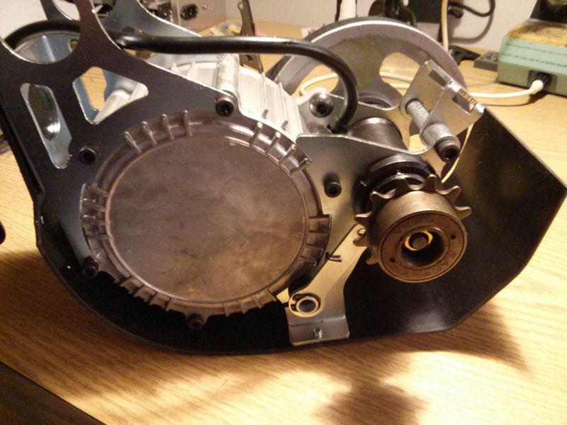

LightningRods said:
Someone who ordered my primary adjustable sheets just sent me this picture of the "New and Improved" Gen 1 GNG. They didn't make the sheets adjustable but they did change the design and eliminate the alloy bearing blocks that held the old design together. I'm asking the member to send the upper sheets and jackshaft to me so that I can see what modifications I have to make.
Couldn't they leave bad enough alone?
Yes, still no adjustment but much improved with the bearing barrel spacer / frame support. I added a center alloy spacer to my rebuild and was also able to eliminated the other two cross supports. Looks like all steel so it should be good and solid.
Also I noticed today that the stock spacer behind the little 12t freewheel is much too thin walled to give the shaft proper support.

Here's another shot of GNG Gen 1.1. The main point of the mods seem to be protecting the jackshaft and drive from castoff from the front wheel.
Forum member hillyterrain is sending this GNG to me to design a revised set of adjustable upper sheets. I'll take detailed photos and then disassemble the top end to see how it all goes together. I'll also post dimensional drawings. Feel free to ask for specific views and information and I will post it here.

Way more solid and stubby looking than the orig. Do like the crash pan. I have decided to mod the bb mount on mine. I am working on making a mount now that will mount to outside of bb shell and not need the gnc BB or rely on the bb threads to hold motor. May not be a universal solution, but should be solid and adjustable.
That's a clever way of mounting the slip on pulley! Wish I had thought of that :p

thank's spinningmagnets i have a 36v. i added lightingrods upper and lower sheets. also just installed a 95t with 535l belt ,i have no slipping on the 14t drive so far. after your post i starter thinking about my next step . working on the secondary drive system.
I highly recommend you sand off the sharp edges of the motor-pulley, if the teeth are still pretty sharp, the belts will wear out very fast. At 36V, it would be better for them to be just a little too rounded than too sharp.
Perhaps sand them just until they seem to fit the curve of the belt teeth as well as possible.
thinks spinningmagnets ,i filed down the teeth but i think your wright i will need to sand a little more
