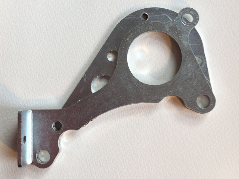

As promised here are some photos of GNG Gen 1.1:
The jackshaft tube now holds the sheets together and maintains the spacing. The one 5M bolt and spacer tube is just to provide a mounting point for the hose clamp bracket.
The threaded tabs on the front are for the plastic mud guard.
The new jackshaft tube is no bottom bracket I'm familiar with. The internal shaft and bearings appear identical to v. 1.0. The freewheel and pulley are the same.
A comparison of the inside and outside of the new and old primary side sheets. The diameter of the center hole is smaller in the new sheets.
I can't really adapt the existing upper adjustable sheets to this jackshaft. It looks like I will be developing a new upper sheet set.

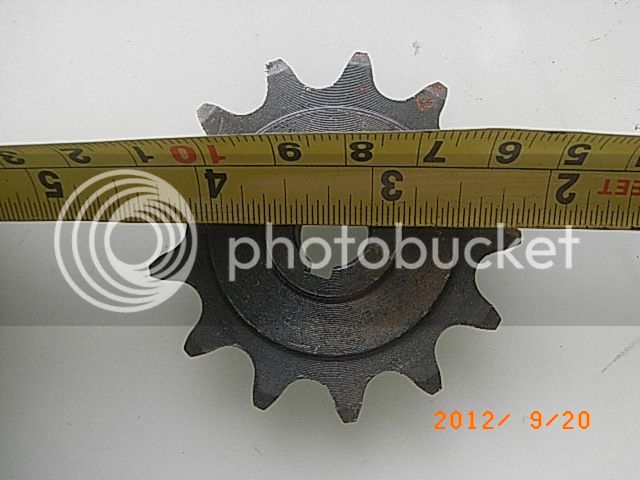

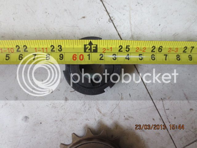

I was able to get photos of the freewheel adapter from Jon from GNG.
Here's what they look like:
Freewheel Adapter
It looks like the freewheel adapter is a no-go in terms of replacing the 12T jackshaft freewheel. It looks like it has an inner diameter of approximately 18mm... way bigger than our 11mm keyed shafts. Unless I'm missing something here...
However, the 13T sprocket looks like it would work. You'd just be pedaling against the motor... maybe set up a 0.01% regen? :lol:
I have no idea why he's using the inches side to measure the ID of the sprocket. This guy has got to have a clear ruler and/or dial caliper. :?
Or put the freewheel in the large drive pulley/sprocket on the primary side where there's room for it. Isn't it true that if the freewheel is on the primary side it's also subjected to lower torque forces? I think that unless you pedal 90% of the time with no motor assist that it's worth the tiny amount of drag from the jackshaft.
