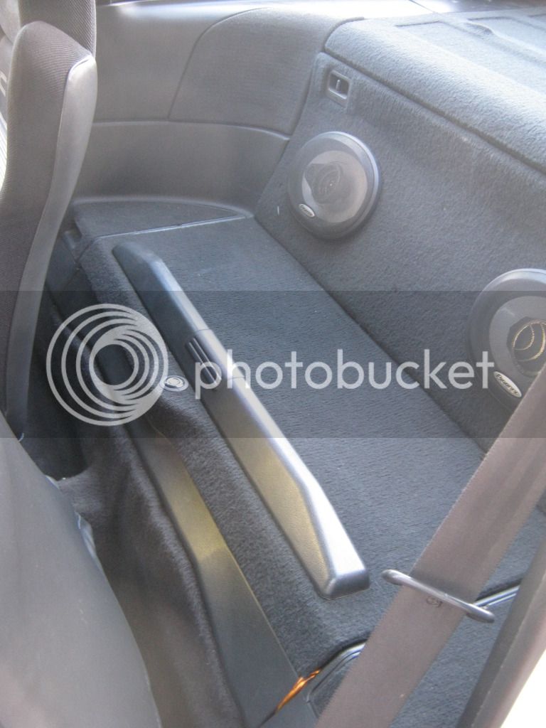

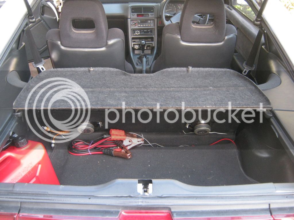

Looking at the space available, I might just rip the fuel tank out and put all of the batteries in the back behind the seat. It won't eat into the boot space all that much, but I can actually move the spare tyre to under the hood. The spare tyre well can provide extra storage space should you need it.
37 kWh of these EIG cells occupies a space about 800 mm wide and 600 mm deep, and 240 mm high. This will fit just in front of the rear wheels so handling shouldn't be compromised. Moreover, I can access all of the cells without a hoist. That is worth it right there! I'm going to be pushing the GVM to its limit, since I can only salvage about 200 kg from the old ICE system, and these cells will weigh in at about 220 kg. Still, it currently has a tare weight of 895 kg :D

So I decided to do some measurements.
A 37 kWh pack of EIG cells is 168s3p. I can make this as 6 blocks of 28s, which once isolated, is in the realm of ELV segments. 6 rows of 84 cells measures in at 605 mm deep and 780 mm wide. I will be separating them with 5 dividers, so lets call it 822 mm wide all up. The height of the cells will average about 240 mm, but will be higher at the back to accommodate the contactors and fuses etc.
This is ideal, as the weight is still in front of the rear wheels. It's pretty substantial (230 kg) so I will be cutting into the chassis and reinforcing with plenty of steel brackets. It also leaves the front pretty light - just a 40 kg motor, 11 kg controller, a small radiator or two for the motor and controller and a couple of 350 V chargers. Just as well as I plan on getting rid of the power steering. I'll keep the heater box as it runs off the 12 V system, and hopefully won't get used that much.
Assuming an average economy of 150 Wh/km, which is probably pretty good going, I can get 250 km on a charge. Not much less than what I can get on a tank of petrol!! I heard that an iMiEV can get 140-160 Wh/km, which is impressive for a car shaped like a brick. Imagine what a CdA of 5.2 will get!

my crx does not have that big boot in the rear. goes flush to the rear of the car inside, and there is a pan in the body in front of the rear axle below where you have outlined your battery box.
i would recommend removing the upholstered part and go find the sheet metal underneath. they use the little plastic captive screw/plug and regular phillips head screws.

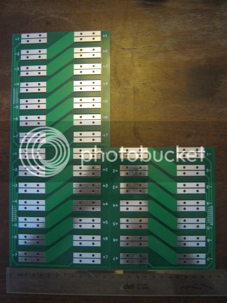

I have designed some boards for the EIG cells. I got Full-Throttle to knock them up as Gerbers and I got a factory in China to make three of them to see how they look.
All up I'm fairly impressed. Basically I can mount three of the 20 Ah cells in parallel and the links make the final connection in series. These 150 mm long and 130 mm wide boards will hold 21 cells, or 1.5 kWh. The traces are not good for much current - maybe 40 A at the absolute most, but they are really only there for show. I will be using a piece of copper to clamp the tabs down and continue the diagonal link to the next cell in series. These are tightened down with stainless steel M3 screws into brass nuts which are soldered to the back of the board.
Even 1.6 mm thick copper plate would do the job - I can't see me exceeding 200 A very often - at 640 V that's still a legit 128 kW from the battery - enough to overtake a Ferarri in my 1100 kg CRX? We'll see :)
I also got some 21s 1p boards made up for the EIG cells, but I'm not happy with them. There is too much potential to short them as they don't have the luxury of a 7 mm gap between cells. More like 0.6 mm :evil: They will need some more thought.
