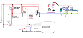

Quick update on the CRX project. I have taken delivery of the DC/DC converter and three 6.6 kW onboard chargers! Well, two, as I already had one. But these two have a CC/CP enabled so all I need to do is charge from a standard Type-2 EVSE and it will adjust the charging power accordingly by overriding the settings provided by the CAN-Charge device. This will generate about 2.5 kW of heat when it's charging at full welly, so I'll need that radiator fan to work.
Speaking of, I also potted two PWM controllers which are driven by a thermistor voltage divider. That way the fan only spins as fast as necessary. Should make for a fairly quiet charging experience.
