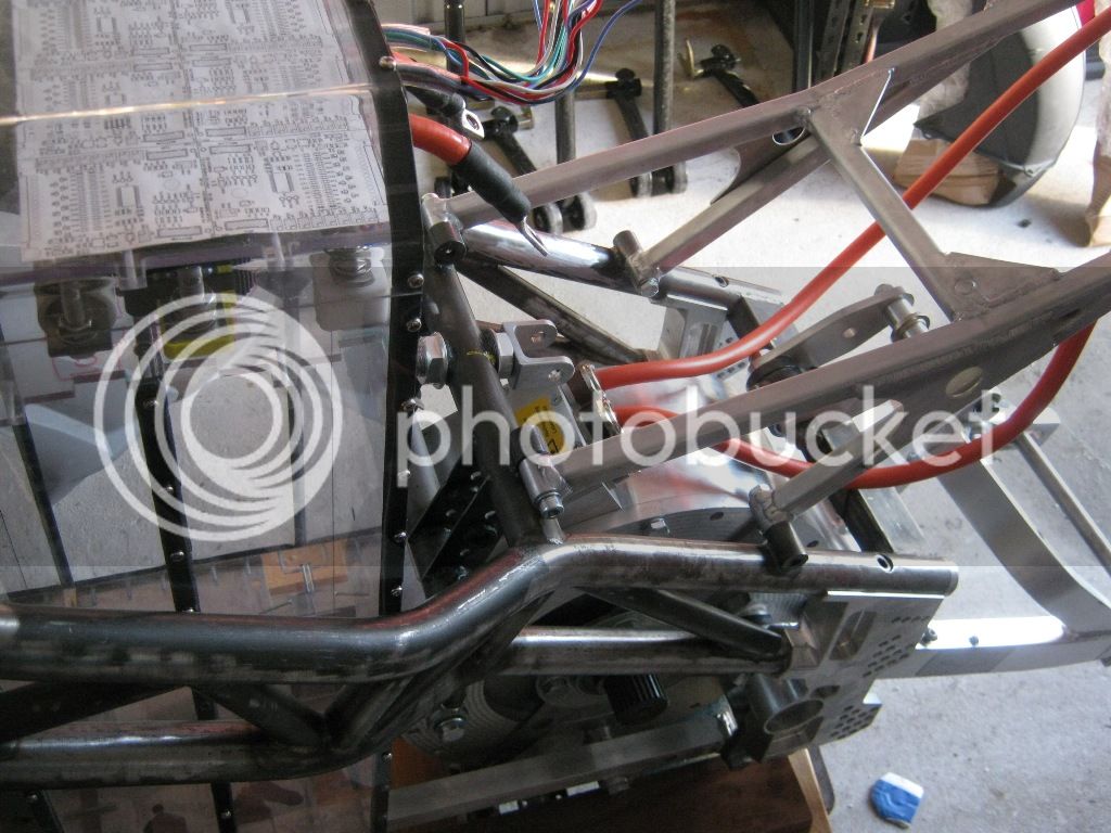

Well I had a good look at the shock and linkage arrangement, and it became clear that I will need to completely re-design the control box. Turns out the box and HV cables won't clear the shock so my idea of laying it diagonally isn't going to cut it.
I can't drill holes into the back of the board either as there are HV traces on the PCB right where the hole would need to go.
So it's time to devise a new, even more compact main control box for the battery...
The phase wires to the motor are also in the the path of the shock, but I should be able to push them down and to the side a bit. Most after market shocks use a 77 m OD which is better than the stock 87 mm standard. I'll also have to go for a shock with the reservoir on a hose since there's barely enough room to swing a cat.

As mentioned above I can't get the main battery control box to fit without moving it up and entering the cables from the back. It looked like it still wouldn't clear the shock mount but as it turned out the cables run either side of it. It's close though. It works out well as the alternative had a pair of HV cables potentially being fouled by the shock spring. The motor phase wires are still a potential point of interference, but I'll get to that in due course.
So I have to get a new PCB made. I can't just drill through the PCB because the left hole goes right through a HV trace :shock: and the HV relay is pretty close to the 12 V contactor and signal wires. It will cost me another couple of hundred dollars but that's sure better than having to modify the frame or design a whole new battery box. When it comes to HV wiring, I will spare no expense making them safe.
Of course this means the box will have to either be sealed with silicone goo or a new polycarb box be made to suit, in order to maintain some level of water resistance. I think the Altronics box is cheaper.

SO today I decided to mount the motor into the frame. First I had to pull the swingarm pins out. There is no thread on the inside of the pins, so I needed to 'pull' them out somehow. Solution - a 12 mm Dynabolt :)
Next step was to bolt the motor plates on. Turns out you can't drop the motor out and leave the plates in place as the outrunner bearing and shaft won't clear it. Not a big deal though - just have plenty of blocks and a jack handy.
Win #1 - the motor plates fit perfectly.
Then I noticed that the thrust bearings were exposed to the elements, and probably needed some kind of covering. So I cut a bicycle tube up and slipped them over the receiving end of the pin assembly. Perfect!
Win #2 - the dust covers work!
Then I had to muscle the motor over to the bike and mount it in place. A bit tough on your own but easy with another modestly strong person. I found it easy to attach the rod ends first and then pull the motor up to the swing arm assemblies. If you're interested, this is what the swing arm pivot assembly uses for bearings.
Win #3 - the motor fits!
My real concern was the cable run. As it turns out, 50 mm2 cable can be held down close to the motor and still clear the shock, but I will still put a composite cover over the cables and hold them down firmly.
Win #4 - the cables are clear!
I also inspected the chain run, now that the motor and output shaft were shuffled across to line up. The outrunner bearing was essential as there would have been some pretty serious force on that shaft at 40 mm.
Win #5 - chain run is clear and straight!
So I picked the whole lot up and put it on the table. It was a heavy setup; the motor and plates weigh in at 50 kg, so there's an easy 5 kg worth of ally that can be removed from the plates. The swingarm is 5 kg, and I'm guessing here, but I think the frame is about 30 kg. While it was up there I decided to position the ZX10 fairings to see how it all looks. Pretty hawt!
Win #6 - it looks pretty fine!
