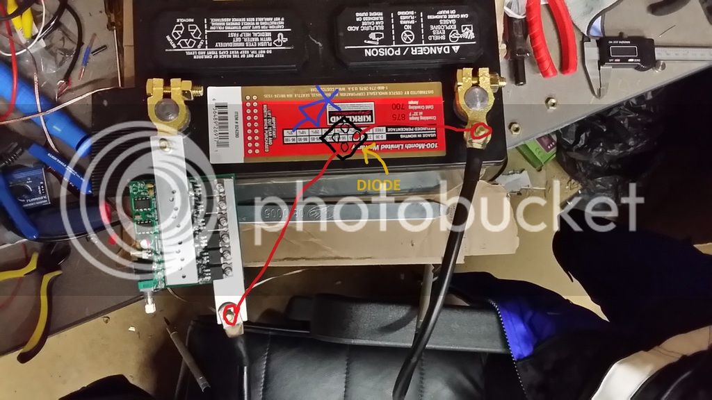

Please note the diode will do nothing to increase power or performance. It just reduces the load on the MOSFET's so they last longer when connected to a more powerful battery.
file.php
Perfect! This is what I needed to make sure I do it right the first time.
Thank you, okashira :D

Can someone verify if this diode wiring is correct. This is how I will wire it into my battery setup. Thanks
Looks good if the right terminal is +

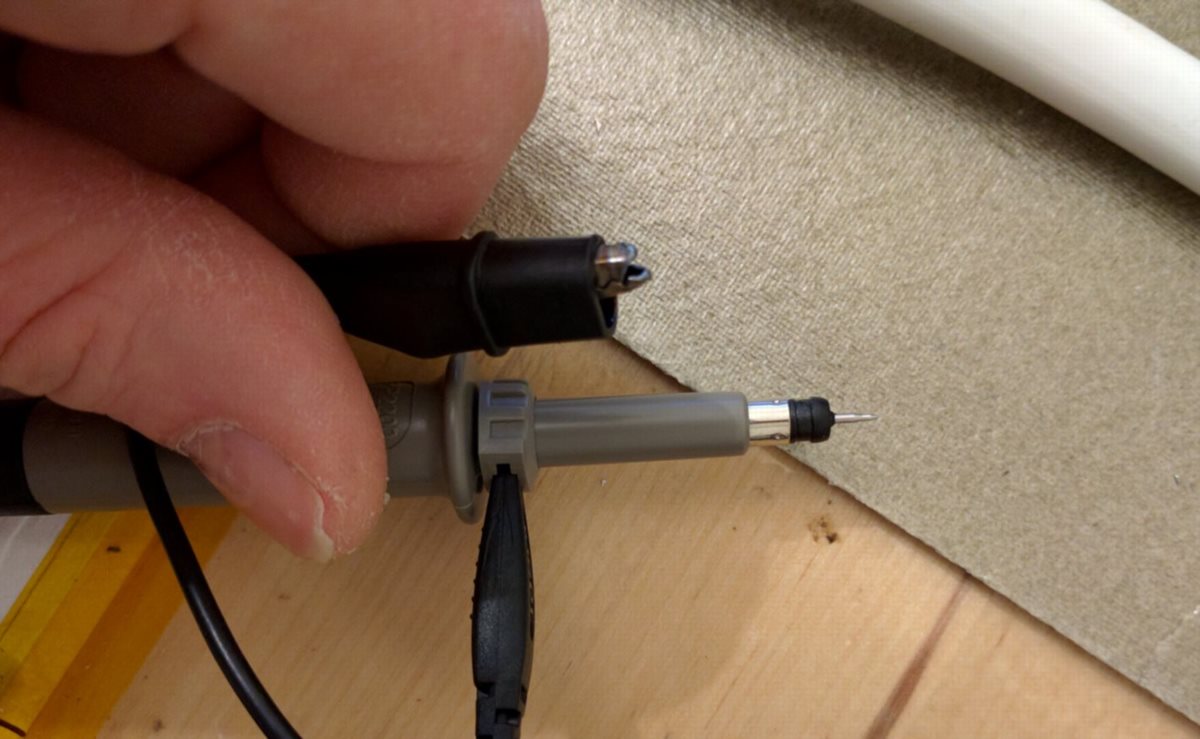

I got my oscilloscope so ill measure current soon. Been 10 years since I used one, gotta figure out right way to do it.
Only took me 10 minutes from unboxing to shorting it out across mains. I was using it to check mains voltage, and connected the probe ground to the "black wire" boom. :((
I hope I didn't mess anything up. dumb-ass. :(((
Allex said:
Guys like okashira who welds lots of cells. How fast does your tips wear out? I wonder if the tip wear partly depends on the current the battery gives. If current is to small(or maybe it is pulse time that is to long that makes the tips stick?), tips stick to nickel and wear out faster. Did we find any better electrodes than copper?
No.. stick with copper.
1" long worth of tip lasts like 10,000 welds for me... And they cost like 5 cents to replace them when they get too short.
riba2233 said:
Ouch! Yeah, oscilloscope probes are grounded, but you can insulate the ground pin on on it and there you go :)
Or measure something after transformer, something isolated.
Yeah, I assumed black would be neutral, green would be ground.
So black is hot, white is neutral. what a frocked up world we live in :shock:

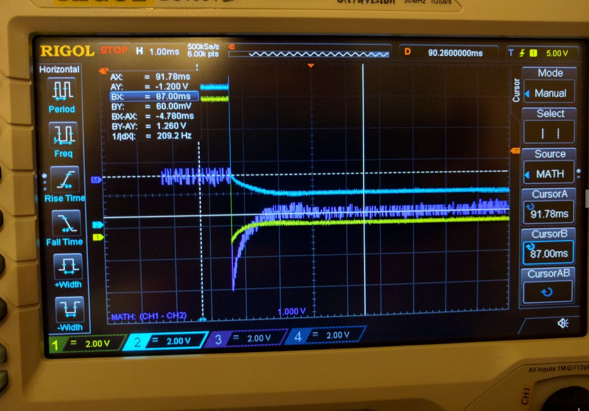

Ok, I got some current measurements.
I am using ~2.5 feet length 4 awg wire per lead
8.2V welding voltage. Each cell is about 0.0006 Ohm DCIR.
I measured 2,530 amps with tips about 1/8" apart welding 0.2mm nickel to a cell. I was using about 3-5 lbs of force per tip
I don't know if this was the best way to do it but I used two channels. I set both to DC coupled and didn't ground either probe.
I put one probe at the beginning of one lead and other other at the end of the same lead.
Then setup a MATH function to measure the difference between the voltages.
As expected the math function showed zero volts.
I measured 1.26V drop across 24" of 4AWG lead.
Per the table, 2 foot of 4AWG wire is 0.497mOhm
Ohms law - 2530 Amps
There seems to be alot of noise... but it seems to average out well.
I also did one bypassing one lead welding straight to the alum bus bar on the model S module. I got 3,900 amps. :oops: :oops:
have not used a scope in 10 years, if someone has a suggestion how to better do it I will give it a try.
Didn't want to use a shunt because that would affect the circuit. Figured the welding lead itself would make a fine shunt.
Also didnt want to use the probe grounds.. caused all sorts of problems since the welder is grounded to mains
