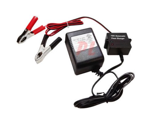

Last question? I am guessing that a 12V 500 mA Trickle Charger would be fine to keep the 12V car starter battery charged. Would a bigger charger be required during a spot welding session?
Sorry if I ask too many questions?
There is a reason why I don't use same supply for both welding and logic supply, it could create problems and instability.
Also, battery doesn't get discharged much during welding, so that small charger should do, or just charge it now and then like I do :)
