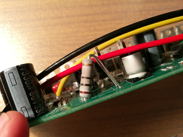

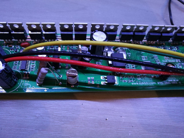

In the german forum, we are discussing if there is a difference between the 14v/5V supply in a 12FET Block (S12P aka KT48ZWS) and a 12FET Sinusodial (S12S aka KT48SVP). The sinusodial mode should draw more current, as the PWM is active on all FETs all the time.
User Xnyle found his modded (phasecurrent sensor added on a ZWS type) controller has 39 Ohm at R62 while 82 Ohm are documented in the schematic.
@honya96: can you please take a photo of your pcb of a 12/18 FET?
Thank you!
stancecoke
Photo from Xnyle still with missing ACS711:
index.php
edit: I found a photo of a S12S in the internet, it has a different board revision, with a ACS756 phase current sensor and a R62 with colour-code violet-black-brown =700 Ohm ?!:
Here are some photos of 18FET KT60SVP controller board, 60A rated. I also have 45A rated version @ home, but the only difference as far as I know are the shunts.
Thank you for the photos! So there seem to be two big resistors in parallel on your board. Sadly, I can't identify the colours of the resistor bands. Can you tell us the colours (or directly the resitance ;))?
regards
stancecoke
regards
stancecoke
Sadly, I have a big problem with this as I am colourblind, and too can not tell resistance just from photos. I do not want to desolder those resistors from 60A version of the controller because it's mounted on my ebike, currently in use. The 45A version, which has 5V rail burnt, is at my parents home. I'll be going there next week so I can take them out and check resistance with multimeter.
I have a better photo from 45A version here:
It looks like 200Ohms
Edit: More photos of Kt60SVP 45A Version: https://drive.google.com/open?id=14r5-jd2Jf2q7mdtYHsvjj7AAd-YTGNWq
Thank you sharkovich! In my eyes, the bands are brown-black-black, means 10 Ohm. If the two resistors are in parallel, we have 5 Ohm in sum.

Thanks for the input folks. I was hoping to use this controller with an 5s battery so it sounds like its not going to be possible. I had looked at the vesc controller but can't seem to find a simple way to provide PAS to this type of controller. I have a no electrical engineering experience so this whole thing is very new to me and a little confusing.
After seeing this thread I thought it would be a perfect solution to achieve low voltage usage along with PAS. I may have to revisit the vesc based controller.
I really appreciate everyone's efforts in replying and taking the time to educate me on this. Thanks again.
...you could probably use 5s if you removed (and shorted) the dropper resistor.
Easy to do, must be worth a try. Then follow the other advice given and you should be good to go.. :)
Don't give up that fast! :D As I wrote before, you have to change the resistor R62 or just short it. (5p minimum voltage: 5*3,3V = 16,5V, fully charged 5*4,2 = 21V)
Edit: geofft was faster :)
It should work then.
One open issue: It's important to have the bootstrap circuit for the high side FETs working. I don't know the boundary conditions for this... :shock:
