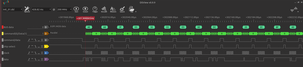

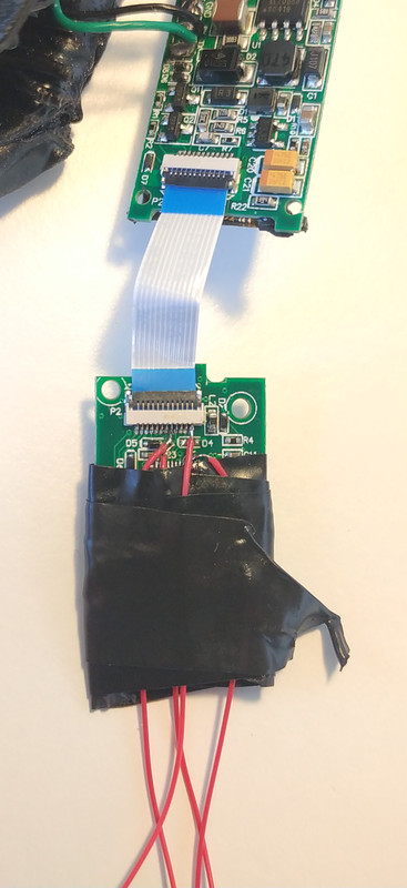

I decided to give a try on the Bafang SW102 LCD with Bluetooth, following the same approach I did to make working the 850C LCD.
Men, my eyes are hurting!! The PCB traces are so small!! But victory, I was able to solder 4 tiny wires and record the LCD signals. Seems to be like SPI communication and I got always a repetition of data so I think we can now replicate the LCD initialization and drawing of pixels (this LCD has 64X128 pixels).
Wires I had to solder to connect to logic analyzer:
Initialization data:
Drawing pixels data:
Next step is to create a project using Nordic samples for GCC compiler. Test flash and debug session and finally initialize and wrote something on the LCD.
