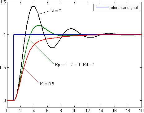

Probably i have to reduce the values gain P and gain I. At the moment i'm at 0.1 and 0.4.
I think the current is to high and that is the reason why the undervoltage protection started before a decrease the value.

Must I reduce gain P and I at the same time and the same value? So when I go to 0.01 the other value must be 0.04?
Gain_I and Gain_P are completely independent. Just play around with both. (You should have in mind, how a PI-Control works...)
