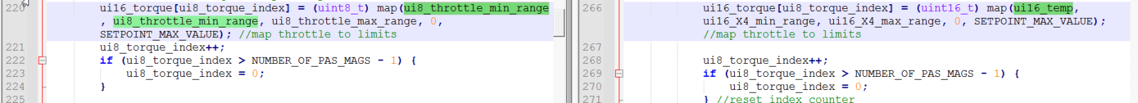

Hi all
I am not coding expert but noticed strange piece of code in Master brach comparing to X4 branch in ACAcommons.c . So when building up the array for "ui16_torque" the master branch seems to build the array of zero's? as the "map" function should read torque value at throttle port but it reads"ui8_throttle_min_range" instead which is defined ones forever so it will not change during the ride. I do attach screnshot of comparison of those two codes side by side.
Master code
Code:
ui16_torque[ui8_torque_index] = (uint8_t) map(ui8_throttle_min_range, ui8_throttle_min_range, ui8_throttle_max_range, 0, SETPOINT_MAX_VALUE); //map throttle to limits
X4 code
Code:
ui16_torque[ui8_torque_index] = (uint16_t) map(ui16_temp, ui16_X4_min_range, ui16_X4_max_range, 0, SETPOINT_MAX_VALUE); //map throttle to limits
Any thougths? or i am completely wrong?
