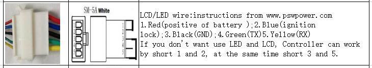

ubik76 said:
do you have any idea where I could find the wiring diagram of this damn controller?
It should be the same for all KT controllers.
5 wires. Black. Red. Yellow. Green. Blue.
You are interested in voltage on black and red.
You can take the display out of the equation. Most KT controllers can run w/o them. Start by jumping the red wire to the blue one on the 5 pin JST connector to the display, Jumper the yellow wire to the black. You're sending the start signal, which is battery voltage, to the KT DC-DC converters, which powers it up. The yellow-black jumper is not always necessary, but prevents transient data from getting in. The controller will have a default PAS and throttle is enabled, They may have even included a jumper with the display. I got them with my last orders.
Make sure you've got the throttle wired right. Motor should run. If not, check your brake connections. Better yet, unplug them. If it still don't run, maybe the phase/halls are wrong, but KT doesn't vary here. They always put the colors right on phase and Halls to match the Bafang motors. You have a meter and can verify 4.3V on red to black?
