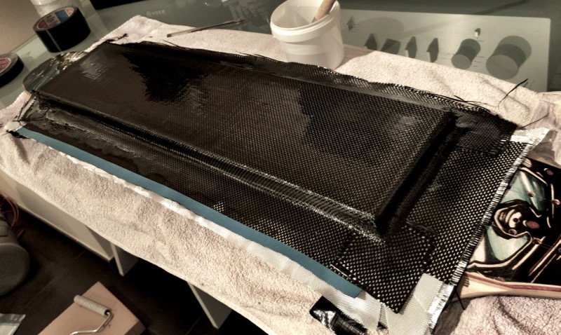

okp made me wanna try laminating, so I did. screwed up the corners, so Ill most likely do it again very soon ... but Ill let it dry for now and see what I can do with some sanding. :)
any tips on corners? I used scissors and made a cut, but the sheets were losing fibers then and it all went to hell. maybe i should try next time without any cuts? or I need to be a lot more careful! OR I shouldnt just try a simple box, but something rounded instead ... :wink:

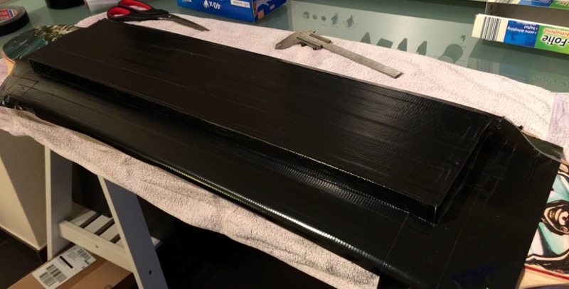

made some box-mold from cheap hard foam - didnt want anything fance, just a flat box:
fixated it on the board, decided against the foil and taped everything instead:

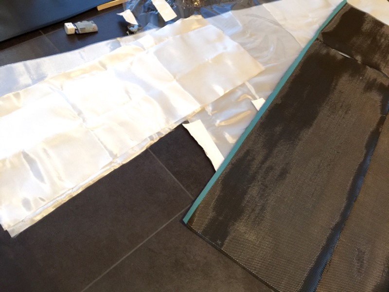

precut glas and carbon sheets:
and laminated slowly - 2 layers of glas fibers, 1 layer of carbon for finish:

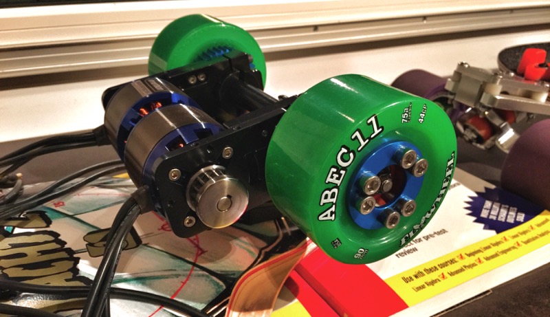

torqueboard motormount, enertion motor, 265mm belts were too short like okp already noticed - waiting for 280mm replacements now:

must say all parts have a very thorough and solid touch. torqueboard motor mounts are just beautiful, the whole electronic package is set up with all the cables you need, everything is connected with large 5.5mm bullet connectors, the anti spark switch is really really heavy and well made (looks a million times better than my evolve stock stuff), wiiceiver connected with my nunchuck right away, enertion motors look really solid and sport nice silicon wires with bullet connectors too. really everything is giving the impression of a lot of effort and zero compromise, love it!

If you can find 270 or 275 belts they will fit better and keep your motors closer to the truck (more adjustability outward as belt wears too). I have an almost identical setup (same motors, mounts.) not sure which gear (# teeth) you are using on the front/motor.
Nice build! Love the pics and polish on that front motor gear!
whitepony said:
which teeth are you using? I got 15/36T right now
I'm geared down for 12s, so front motor pulley is 13t. Torque's wheel gear is 32 or 36t - i have the same. I can *almost* fit a 265, but the 270 fits perfect.

been spending my time with sanding the laminated case and DOH, I managed to screw it up TWICE now!!! think I need to work more with my hands than with a sanding machine. Basically I ended up with sanding "holes" into the case ... the layers are pretty thin after all. main issue while laminating are the sharp edges of the most simple cuboid form. I really dont want to make the case larger than necessary, but for laminating, I probably really have to go for something more rounded and smooth.
or maybe Ill just build my own vaccum ABS table afterall OR I order one of those vaccum bags to force the carbon & glas layers to follow the mold better. but since Ill have to wait for the larger belts anyway, I got all the time in the world to figure something out and keep working on that case.

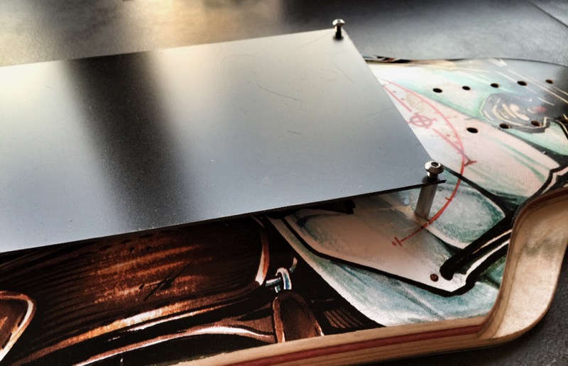

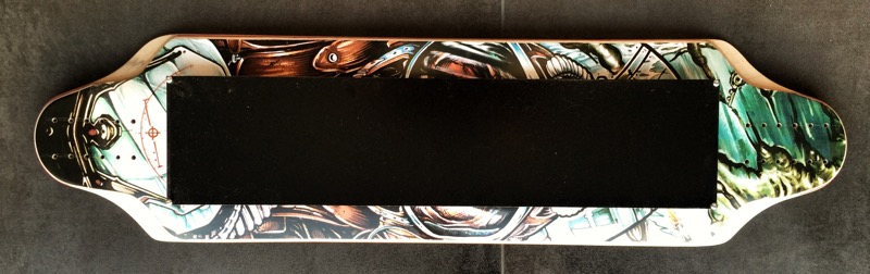

for now this is probably going to become my case - think Ill even start completely open at the sides since I havent been caught by rain yet on my evolve, nor do I ever intend to drive during wet roads or rain.
just a cheap GFK plate, 2mm thick, cut 4x 6mm aluminum cylinders with 4mm inner diameter from a 1eur aluminum pipes (will add 2 more in the middle, so 6 in total). using M4 screws that go GFK -> aluminum pipes -> threaded inserts that I sank into the boards first 4 wood layers.
the battery is trapped by slight pressure of the GFK plate and the 4 aluminum cylinders, the ESCs will be attached to the GFK plate with screws.
this "case" would NEVER work for a flexy board obviously, but with the top speed Ill probably get away with it! think this is the slimmest possible case for now - and most likely also the cheapest! for the future Ill either get a vaccum bag or an ABS vaccum former. wouldve tried that one, but my kitchen oven isnt large enough for 60cm. :|
