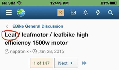

Sounds good thank you for the direction! It always takes me a while to figure them out.
Edit: what I meant actually was how to get to this part of the directory, if that’s possible?
There are no directories. No folders. Just pages. That is simply the thread title, and the person creating the thread used forwardslashes in the title itself to separate the terms commonly used to refer to that manufacturer.

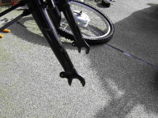

But the depth of standard dropouts, for a front fork, are also only 10mm. (very old ones may be only 9mm).
So if you use a hubmotor with flatted axles in there, it won't fully sit in the dropout, and won't be fully supported. It may be necessary to use a round file and file the dropouts deeper by at least half the difference between the threaded axle dimension and the flatted axle dimension, depending on the reason for doing this.
If it is a disc brake wheel, then you want to center the rotor as with a normal wheel so it sits in the caliper correctly. This may leave some of the axle flats unsupported, meaning it is easier for the axle to pry the dropouts apart and the wheel to come out of the fork while riding, which is the most undesirable outcome. :(
If it's rim brake then it doesn't really matter, since the pads and arms have enough adjustment to deal with almost any amount of displacement caused by axle dislocation. So you can file the dropouts deeper by the full amount, to fully support the axle flats, and help minimize the prying issue.
if 14mm vs 10mm, then difference is 4mm, so half is 2mm and is how much deeper the dropouts must be to put the center of the axle where it should be, for disc wheels.

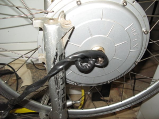

I had entirely no idea that this is how the axel bolts fitted to the drop outs.
There's a lot of pics of various hubmtoors installed in or being test fitted into droputs of vaoroisu shapes, if you do an image search on the web for taht sort of thing, and just wnat to see all the variations. :)

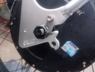

If you mean like this, where there's a hose clamp securing it to the frame:
they'll work fine as long as they are not movable, and the clamps are not deformable. As soon as any part moves, it deforms other parts and things move more. If nothing moves, and material limits are not exceeded, nothing deforms and everything stays not moving. :)
If anthing moves, especially the axle itself relative to the arm....

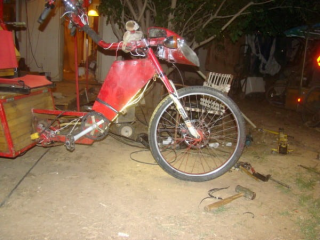

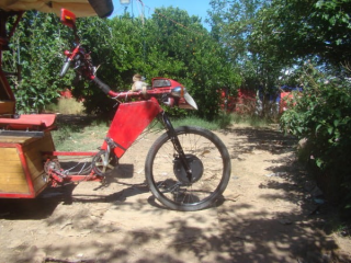

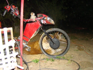

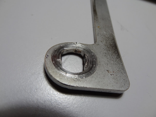

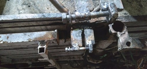

and one from me

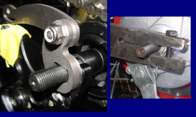

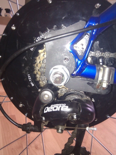

Once, I used a small wrench as the torque arm, and a couple of good old 1980s Ideal brand hose clamps to hold it to the fork, for crazybike2. The wrench itself broke before anything else failed.
But clamping / pinching dropouts, with no need for separate torque arms, are perhaps the most secure you can get with flatted-axle type hubmotors. (there are better motor/axle designs, but not many use them yet, and not all fo them are quite perfected). The pic below sohws a poorly fitting torque arm (taht wouldn't do the necesary job for long if at all) vs a custom-made clamping plate from that torque arm picture thread.
my crude but functional version

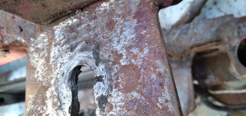

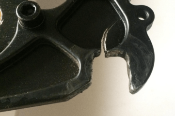

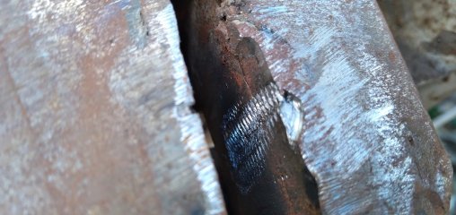

because this happened
