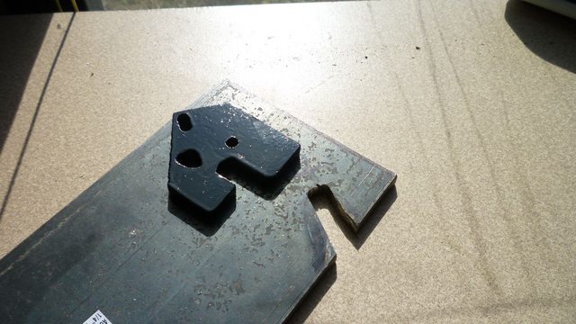

Great idea, I searched everywhere for a pre-made compatible torque plate for my GT Avalanche 1. In the end it was easier for me to make a template out of cardboard and get it cut at a local laser/plasma cutter's.
file.php
file.php

I just bought these from Magudaman in the for sale new section. CNC thread. He can make em any size, mine are 4x4 in 1/4 steel. You can get em made small, then file to the perfect tight fit. CIMG0250.JPG
Re the above, I'd rather have two bolts than the spline. Customer would drill holes and bolt to his angle, or just weld it.
