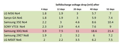

I made some selfdischarge voltage drop measurements on the cells in calendar aging. Obviously at 100% SOC new 30Q has markedly higher selfdischarge than others.
