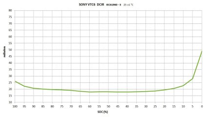

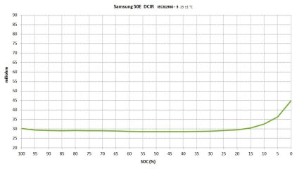

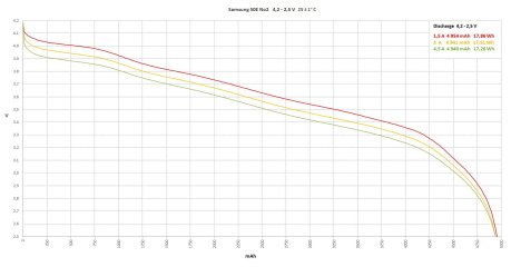

New pair of cells started cycling test, SONY VTC6 and Samsung 21700 50E.
SONY VTC 6 is running with parameters charge 1A / 0,1 cut off to 4,1 V, discharge 2,5 A to 3,3 V. SONY VTC6 was chosen because it is an interesting cell in the high power category, moreover until now there wasn´t any SONY representative in the test.
Samsung 21700 50E is another new cell in the test. Running at increased parameters charge 1,5 A / 0,1 A cut off to 4,1 V, discharge 3,75 A to 3,4 V. Both resting times increased from 5 to 10 minutes for 50E. This cell was chosen as a promising member of small 21700 family (based on Pajda´s positive evaluation).
Graphic characterization of the cells :

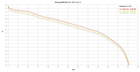

No, no, there is a LOT capacity between 4,0 and 4,1 V. I mean resting voltage. It´s obvious from SOC chart as well from discharge graphs. So optimal charging voltage to exploit capacity may be about 4,12 - 4,15 V (termination point).
