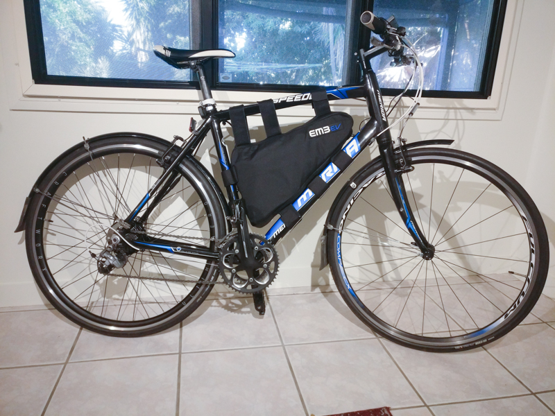

I'd like to see what washers/spacers you have between the cassette and dropout.
My 9 spd cassette fits my Q128c with a rounded nut securing the motor to the axle protruding slightly. You can see the rounded nut just behind the washer just inside the dropouts. I used a fat washer to minimize the amount of bruising to the dropouts, as this rounded nut is a very poor fit to any frame dropouts.
The clicking might result from a bit of pressure on the freewheeling mechanism that can be relieved by adjusting washers/spacers? or perhaps by adjusting the cassette securing nut - tightening or loosening?
