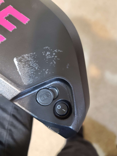

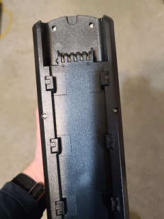

How many pins/wires does your battery use to talk to the controller. if it's 2, and the power switch is on your battery, you're in luck. No Jailbreaking required.
otherwise you can replace the BMS and rewire the battery, but it is kind of a pain in the ass to do.

The battery has an on/off switch but that definitely looks like more than 2 pins if I understood correctly.
How many wires from the cradle to the controller? Or if the contyroller is inside the cradle, now many wirse from the battery pins to it?

OK your battery has 4 pins, probably 2 of which are used. It looks like a DIY compatible battery. If this only has two wires coming out, there's a >95% chance you got a DIY compatible battery.
